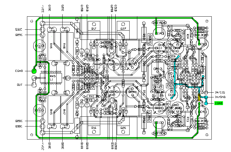

I have made 2 boards for this, one is the main board, slightly modification of Mr. Leach's original, the other one is the output board, with all the output trannies on it, together with some other components in the vincinity. The distribution of the components are shown as in Post #10. The 2 boards are connected thru +-ve rails, output, Ground and 6 wires marked as JKL NMQ. Hope I am describing it clearly.

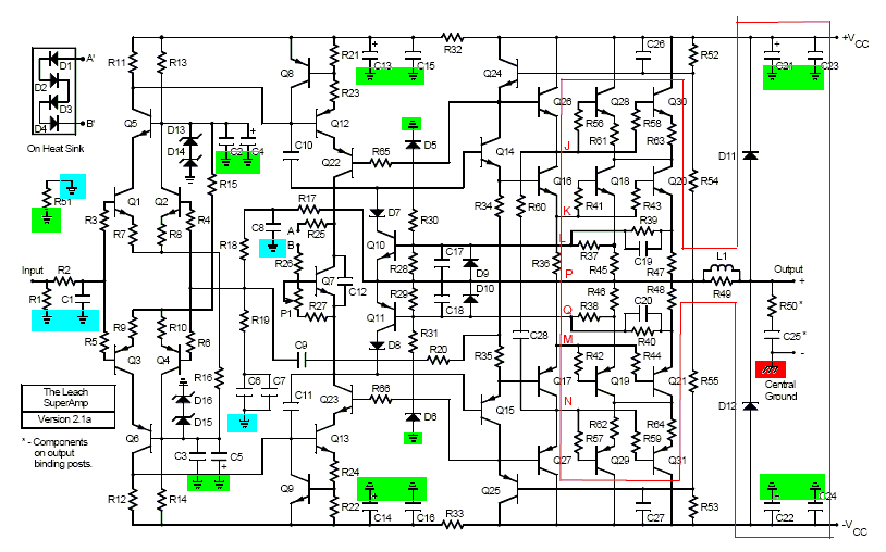

I think I got it right this time. It is the diodes that's causing the trouble. This time I use another connector and everything semms to be OK now. The dc voltage is still at 20mV and bias currnet adjust to about 100mA. So comes the next question, the grounding.
In the attached schematic, I had the signal ground painted in blue and central ground in green. So are the traces on the board. In Mr. Leach's construction (or board test) manual, he said about connecting the central ground at the input (which looks the same as the signal ground) also. If it is connected like that, what will be the significance of R51 (painted in yellow) then?

the recomendation given by dr. leach was based on ground plane boards... here is howi do my grounding.
1. locate a point in your chassis for a central ground point, i used a 4mm screw here and round lugs.
2. the center-tap lead of the main power transformer goes to this bolt first.
3. one each of the psu caps's positive and negative leads goes in next on top of the one in 2.
4. the ground return of the speaker terminals goes on top of 3.
5. one ground wire for each board goes on top of 4. (speaker ground)
6. the signal input, with a sheilded wire goes to the input jacks, the ground side of the jacks are earthed thru a 4.7~10 ohm 1/2 watt resistors one end of which is tied directly to chassis at input jack side, a smaller grounding wire is also needed to go to the central ground point in the drawing you marked green..
this should complete your earthing..
please go over the pictures i posted to see what i mean..
you may replace your fuses now with regular ones..
enjoy....
you may omit it...
