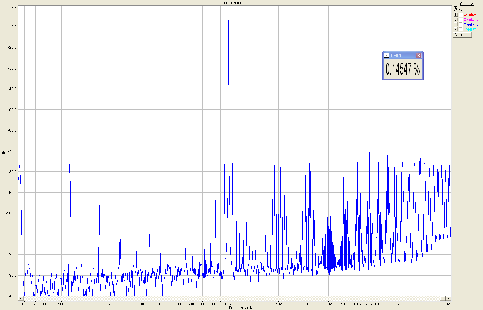

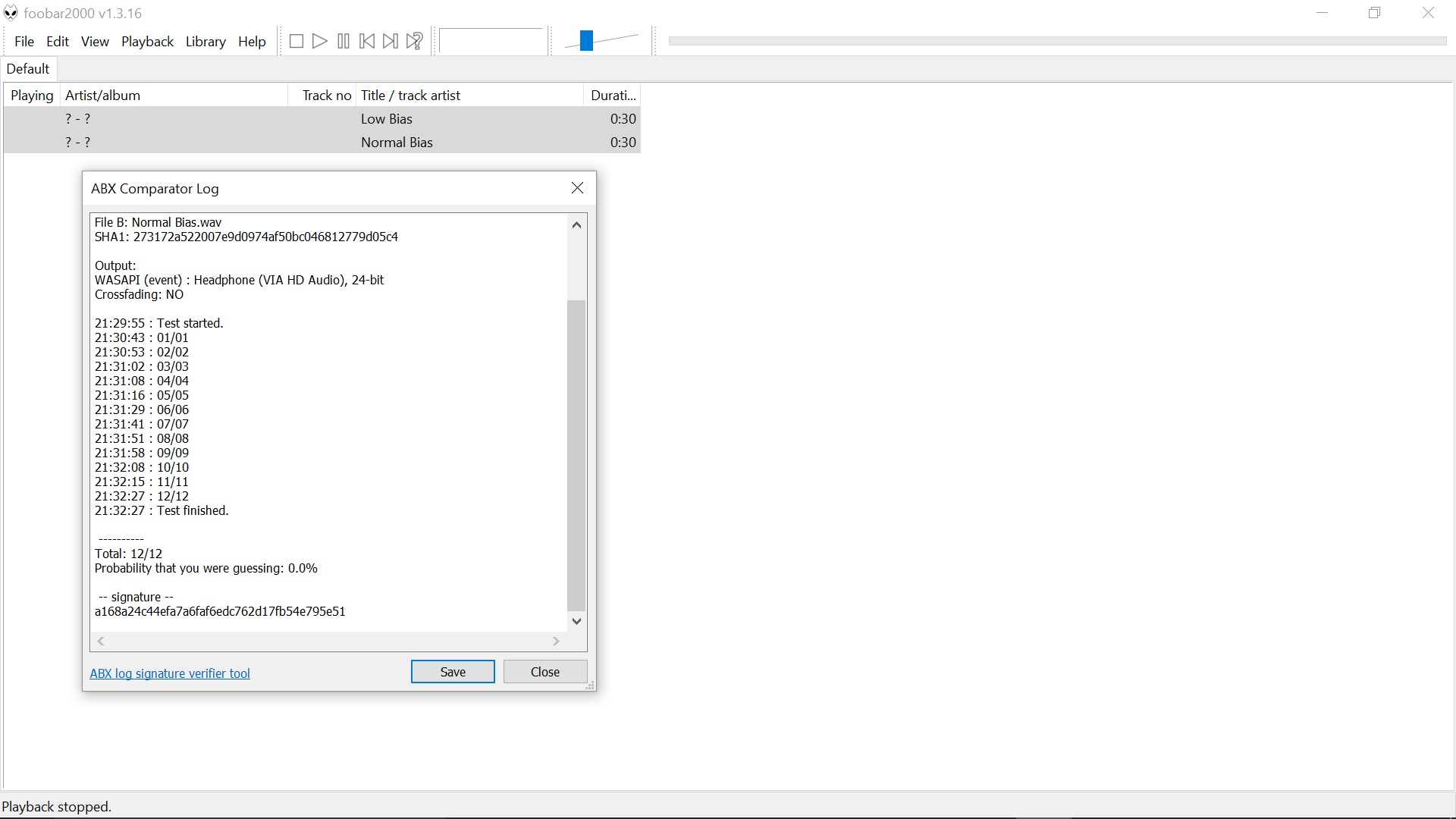

Try these Mark. I'm just playing at the moment with an idea so all is not quite as it might appear. Practical Wireless Texan at high and low bias. Pure tone with a 5 second fade in and out.
Everyone should get 100% Foobar result on this. The big question is whether this would be audible on music... that's one for another day though, and it would probably have to be with more subtle bias reduction.

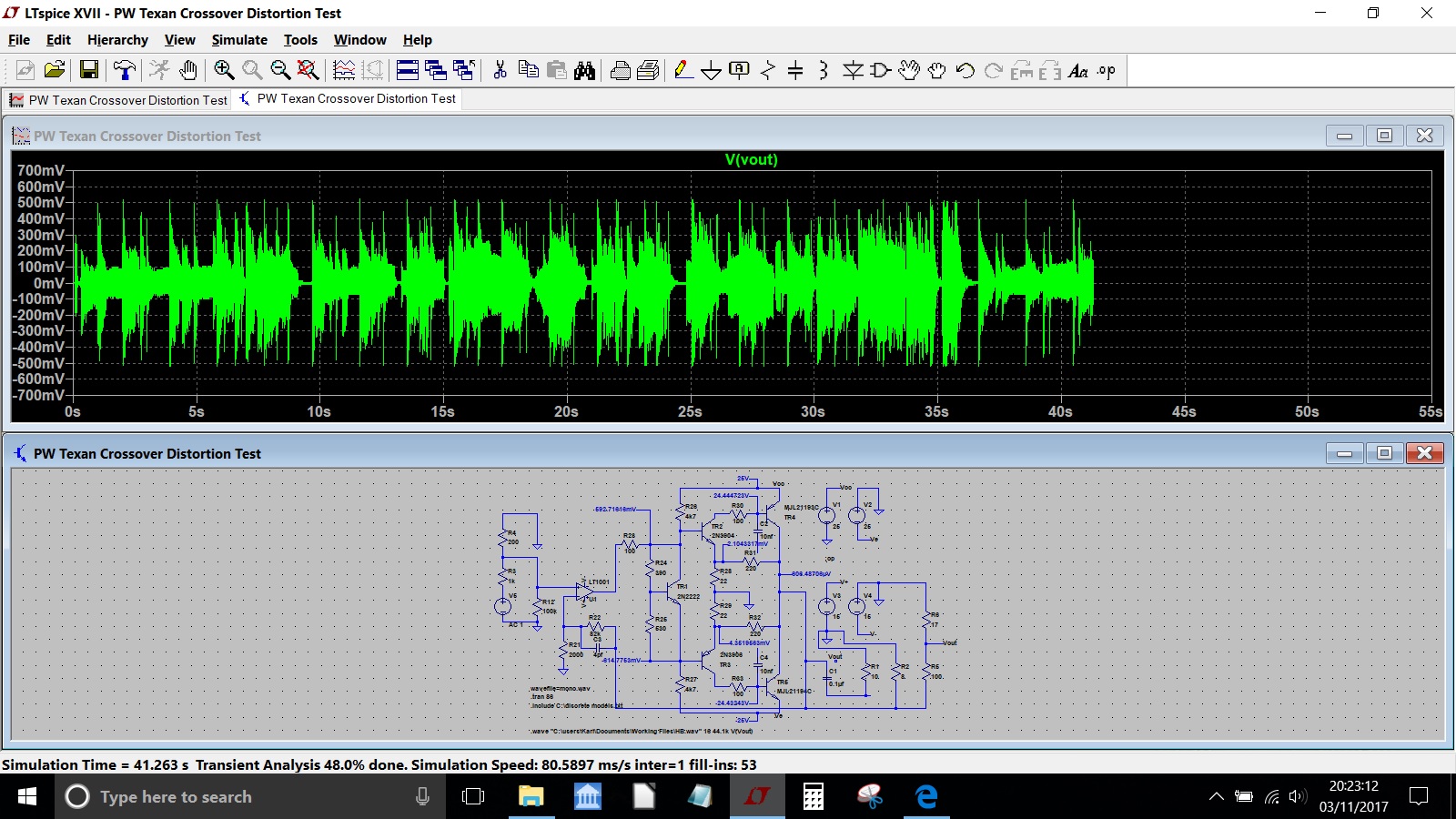

OK, so the cat is out of the bag already on this one. This is what I am playing with (but why not). The track being recorded this instant is Pavels 'cc' mixed down to mono.
(It will be tomorrow before I get chance to re-run the music file with a low bias and see how it sounds)

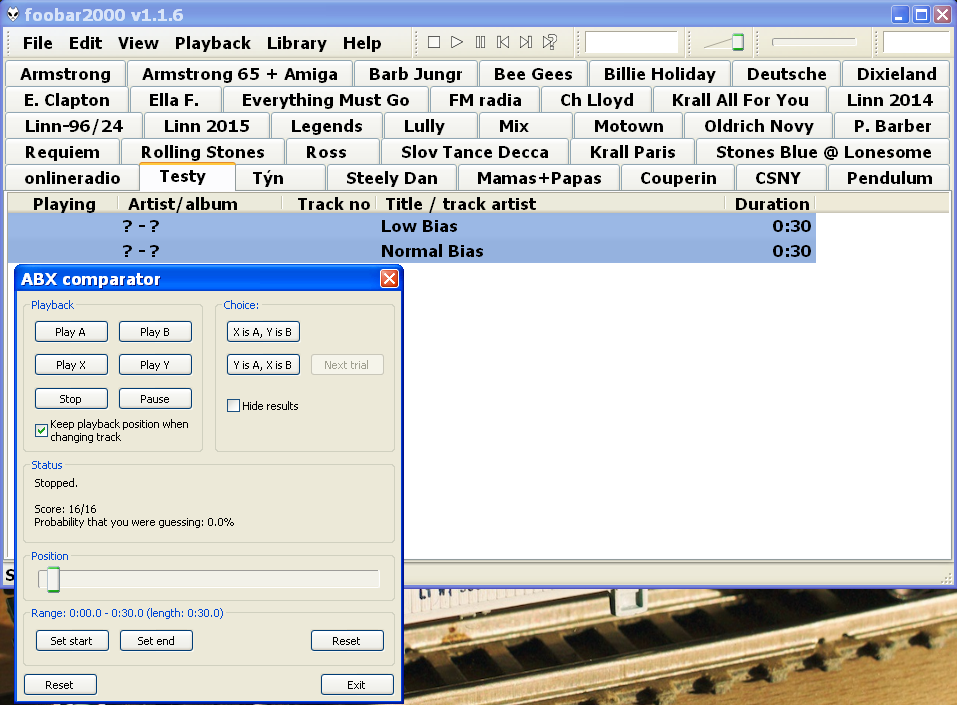

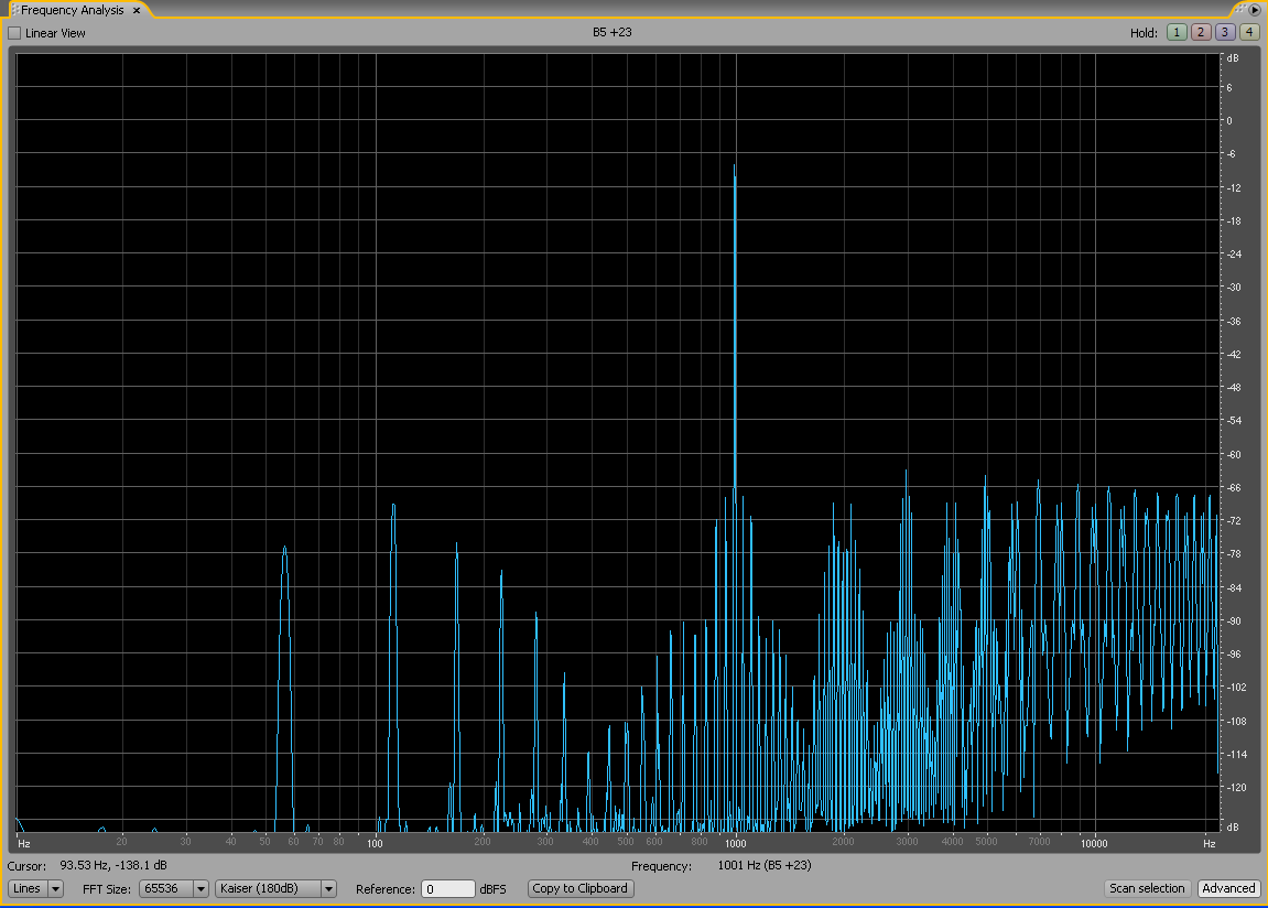

I did Karl . It is too horrible . Just good to show if one can work with foobar. Really, this is too much distorted, especially the mains frequency intermodulations (how did you do it?). Please see my abx and spectrum analysis. This WILL be audible with music.
This is very easy to discern to me.Try these Mark. I'm just playing at the moment with an idea so all is not quite as it might appear. Practical Wireless Texan at high and low bias. Pure tone with a 5 second fade in and out.

Can you tell the THD?

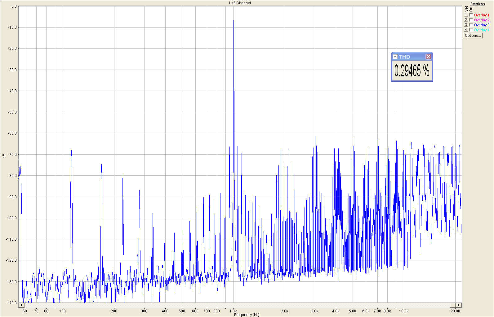

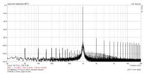

I can. 0.14% and 0.29%. The problem is not the number, but the content of mains lines and intermodulations. This is far away from the amp we tested here.
Edit: I built the Texan in 1976 or so and had an impression it was the worst amplifier I ever heard. Now I can see that I was right. Those were the SS amps of the seventies, at least some of them.

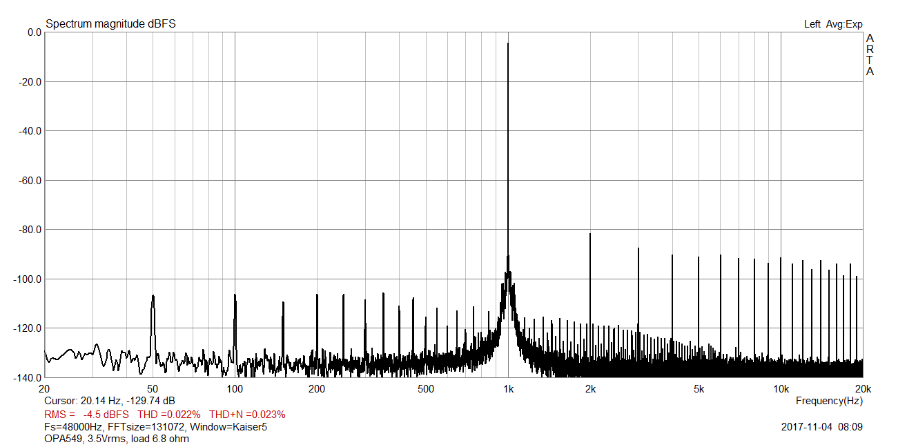

Karl, for comparison purposes, I am posting a 1kHz file recorded through OP549 amp under test, Vout = 3.5Vrms and Rload = 6.8 ohm. This is close to conditions during my test recording.
http://pmacura.cz/1khz_549.zip
measurement attached, THD = 0.022%, this is about 10x less than Texan, but note that mains spectral lines lie more than 100dB below the 1kHz and there are no mains intermodulations. This is a big difference and this is what makes the difference in audibility, not only the THD number itself. Your amp makes too much buzz and intermodulations, so it is not only crossover distortion tested, but rather all other issues. Despite that said, the test with music might be interesting with your Texan.

That's a good question. I didn't do anything That was the result of the simulation. As far as I know this is all pure calculation by the PC, the adio stages and sound card do not play a part. So there should be no outside influence.
