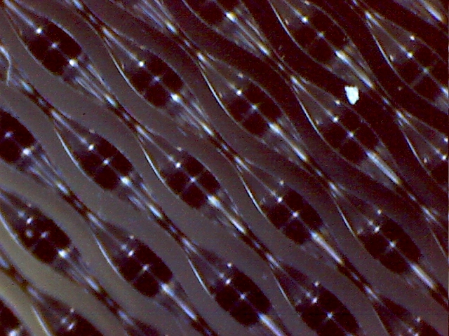

To revisit an old photo. I never noticed the slight errors in this photo of one of the tracking torture tests in the CBS STR series. The frequencies work out to exactly interleave in the ideal so the large modulation does not impinge on adjacent tracks. If you look carefully the alignment varies revolution to revolution. We should be able to estimate the lathe variations from this information.
The main stumbling blocks to getting what we want cut are the cutter head and the cutting engineer. A few have looked at the track list and declined to be involved, and other have said things like "that'll never cut." We don't yet have precise info on what can be cut, or what a certain engineer is willing to try.
We have to remember that this LP has to be cut, and that cutting has its faults and limitations.
