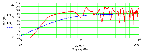

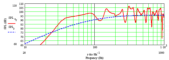

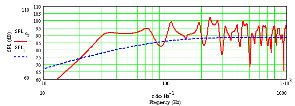

I posted this on the other thread too: suggested dims for Veravox 7x BIB:
Line length 140in
Zdriver 29in
Sl=150in^2
It's got to be pretty big compared to, say, a cabinet for a similar sized Fostex unit because Q / Vas ratio is high. Not a bad response at all though.

Thankyou Scott!
Brilliant work!!! The response of the veravox looks good! Just a question though, what makes a response so jagged, say veravox compared to the HX160 or Seas. More to the point how much of that squiggly line do you hear? Some of the dips are down to 75db...
Cheers Stroop

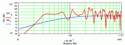

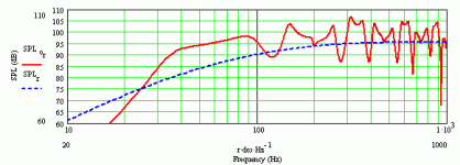

What would you predict the difference be in sound if the 2001 monolith enclosure was 96" in height instead of 72"? Just curious. I am going to reduce my wood requirement by using my wall as the back of the enclosure. I plan on putting "feet" so that the thing doesn't tip forward by an external force. Probably 16", double the depth of the cabinet. This would end up bumping the driver 3/4" in height, of course. Using my crappy math skills, I figured the internal baffle would be ~59" in length. I'm also pondering a 16"x16"x3/4" extra front baffle or maybe just doing a smaller round baffle as seen on the Cain enclosures.
If you increased enclosure height you'd extend the bass, probably by another 10Hz or so, and flatten the curve out somewhat as you've also got a fair bit extra box volume. However, the driver would be about 2ft over your head, unless you listen when sitting on a tall bar-stool. Not a terrible problem of a huge driver, but a trifle excessive for anything smaller... I chose the external dimensions for the monolith specifically to match the 1x4x9 ratio of the Monolith Kubrick & Clarke dreamed up, without needing to go to an excessive number of decimal places. You could do (external dims) 10in deep x 22.5in wide x 90in tall if you like. That would work. Very large of course, but Bigger Is Better after all.
Do you mean why does the response of the modelled cabinets look rough? The models are 1/2 space -they don't acount for the load the room imposes on the pipe when it's correctly corner loaded. You will get some ripple, but anything over about 250Hz is massively over-estimated by these models. In reality, it's usually contained + / 4db in my experience.
