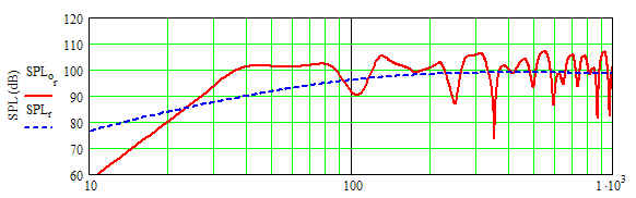

ultrakaz said:GM,
Would you mind sharing your 604E TL plan? I've been looking for a good plan for years for my 604E. Thanks.
Greets!
Are you driving them with SS, or........? The increased effective Qts due to series resistance will affect the design. Regardless, the BIB is a pretty serious sub duty alignment and a 'fun' speaker for wider BW apps, but if you haven't found anything worth building after years of searching, I doubt the BIB will do it for you.

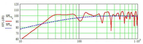

TL? I've only helped folks do MLTLs for 604s. As I indicated, the BIB lives up to its moniker, so a 15" deep driver shouldn't be a problem, though folding it to fit with the driver around ear height may be:
L = 300"
CSA = 770"^2
zdriver = 65.1"
Even this big it won't tolerate much series R if the sim is ~accurate, so I recommend SS for the woofer and tubes for the horn.
GM

GM said:IIRC, your room isn't large enough for two.
If the sim you posted is correct, then no, my room is not big enough for even one. No 14' ceilings here.
Ditto using Altec woofers in a BIB.
Never said they had to be Altec.
As far as woofers mating to the 811, haven't we already been down this 'road'?
Yes indeed. But there was a nasty looking bunch of natives with spears blocking the road. There was simply no pleasing them. So I took off cross country and went to the beach, instead.
Perhaps ..."inappropriate" would be a better term; Shame it is out of the question, unless someone has a school auditorium. Look at that wonderous FR plot and tell me you wouldnt WANT this to be built. Fabulous biamping with SS and tubes.

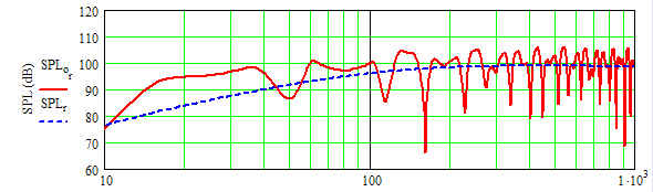

ultrakaz said:Whoa! That is one gigantic BIB.
Now, the MLTL must be smaller. Any dims and instructions on how to stuff it?
Thanks.
Greets!
What did you expect? A true BIB loads to an octave below Fs and all these vintage drivers have a low Fs, Qts, high Vas to keep efficiency high enough to match to low power/high output impedance systems. At ~68 ft^3 gross, it would have to be folded up similar to a K-horn and be at least 6 ft tall, but corner loaded, a pair wouldn't take up all that much usable room 'real estate', creating a 'wall of sound'. From a construction POV, it would need to be folded such that it could be tied (stacked) together vertically as three modules to make moving/installing/removing them a 'one person with a handtruck' affair through a typical width doorway.
Anyway, the room would have to be acoustically large enough to justify such a low tuning or you'd wind up attenuating too much of its sub BW output due to room gain, so the 'it's too big' argument isn't applicable per se since it's all about scale.
The MLTLs I've done range from ~10-27 ft^3 net depending on the system's output impedance and room size, etc., though obviously it can be scaled to whatever half space F3 or size you're willing to accept, so email me your performance criteria/limitations. Stuffing is minimal at most and historically folks wind up using even < what I would use or MJK's WS predict for smoothest response, so all I do is suggest a starting point and it will be up to you to find your 'optimum'.

Well, as much as I would like someone to build those monsters (preferably me, but not going to happen in this incarnation ), I knew it would probably remain a 'pipe dream' , so scaling it to a more typical BIB's height/F3 using SS power for the woofer:
L = 138"
CSA = ~660"^2 (recommend ~21.63" W x 30.56" D)
zdriver = 30"
Still large, but at least within the realm of possibly getting built.
GM
