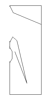

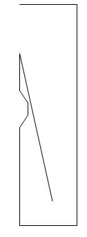

I'm considering a first try at a full range and am interested in the CSS WR/FR125. It seems to offer a lot of options for experimentation. A lot of the Planet 10 designs look great. But, the BIB thread looks really intriguing too. Could the CSS drivers be suitable for the BIB method? If so, what would the numbers be?
Also, the Acuhorn discussion disappeared. The ceiling propagation seems to be a big part of the performance of the BIB. But, could a BIB be morphed to a an "Acuhorn" by:
1) Turning the mouth to the vertical by "sliding" it to be in the front. This would shorten the box slightly.
2) The mouth "swallowing" the narrow end of the taper above the driver so that the taper folded back. The driver would be situated at that bend.
I hope that reads as well as I see it in my head. No drawing software at work. As a new builder, and even newer to TQWT theory (reading Martin King's pages), I did not know what the fold right by the driver might do to the response.
Sorry for a longish post from an unproven source.
Regards.

Close, but to get the driver position "Z" away from the closed end, it might look like this. Please excuse my lack of drawing siftware. The angles and dimensions are of course no where near correct...but hopefully the intent is there. I did not know what the fold right by the driver would do.
The trick, I guess, is keeping the taper going as you would want it to because the closed end's two sides act as one side for each of two other sections of the horn.
