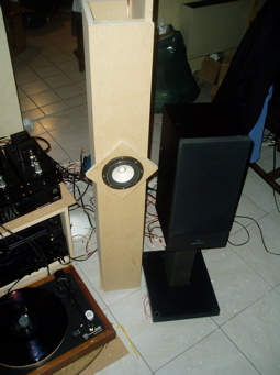

Hello all,
Update on BIB w/108EZs...
'Finished', well finished enough to listen to! Could not resist. I've essentially done it on the cheap, the MDF cost a total of 45 Euro (I guess 55 USD) including cuts, 108EZ 90 bucks the pair on ebay. My local Leroy-Merlin (HD equiv) did an excellent job, all cuts are w/in a mm and done in 10 mins! As you can tell from the photos, I did not have the equipment or space to do this at home (all done in my living room). I enlose a photo and if Godzilla is OK, I'd be happy to post others on his site. If anybody wants the sizes then please email directly (wac38@mac.com).
Sound... (Ariston RD80, Akito, Benz Micro MC20E 2, Linn LK1, Aureavox 5W tube monoblocks [only 5 W])... bass is surprisingly deep and detailed, tails off nicely, full in mid and highs are crisp, even not when against wall the stereo imaging is good. Though mid-high is a bit too clear. Compared to my favourite Linton XP2 (normally a large, warm sound) they are brighter with more detail in bass; Index II, different sound, where the Index have a well-equalised and controlled sound, the BIBs are alive (volume of course much louder with BIBs); TDL NFM, used as rear set in 5.1, more open sound stage, imaging is good in comparison. So, excellent but they do shout a bit in the mid-hi region.
Was planning to do a pair in real wood but I may just veneer, very happy with this project (and a nice easy one to get the ball rolling for those who first attempt this is [like me]). Thanks for the help available on the thread esp. Godzilla and Scottmoose for sharing their experience and numbers...
Best
Wilson
Best
Wilson
IMHO,
... and for those that know Talking Heads' 'Heaven' on Stop Making Sense (good to hear what a guitar sounds like...) it sounds amazing, the difference is akin to when I replaced my plastic receiver with tubes... yes that much!! same with Marquee Moon & Southern Man (wow!).
... put on Mingus, Nomeansno & Joy Division for bass, very clear and tight bass though perhaps not as expansive as I am used to but furniture can be moved to get close to the walls.
... for 'wall-of-sound' Loop and Dvorak's Stabat Matter, the SM perhaps a little thin compared to what I am used to with the Index or XP2 (perhaps because of the loud treble as the bass is good when it kicks in).
... Sketches of Spain, very detailed in horns (hear the brassiness of the horn) and in bass, breathing is easily heard
... Horns are also excellent on Resolution on A Love Supreme tho the bass is a bit lost
Last test...
Ysabel's Table Dance, castanets clear, singing clappng all no problem. Perhaps gets a bit lost when it turns complicated at just over 2 mins. The high treble will be tiring if it keeps up (but I've heard it often enough to know it doesnt!), piano at 3 mins odd is nice as is the sax at 4 mins. Good detail on Mingus when bowing or plucking. Piano sounded good, so
Very last test, as I must go to work
Aldo Ciccolini's Janacek album is a crystal-clear, you can easily hear the effect of pedal use and when he lets the notes trail off. There is no articifial rounding, very crisp. Though it could be a bit more expansive.
In short, need more bass (easy part) and/or less treble. They need to be higher for my listening position, but I will have a small foot made for each by next week.
Dig out your Neil Young, you will appreciate it all the more with these
w.
