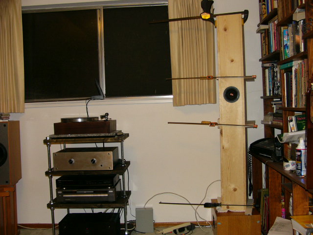

Obviously unfinished! The right side is clamped in place. That's one of my old Paradigms doing double duty as a stand to raise the FR125 to ear level, and as the bottom of the cabinet (with a folded dish towel as padding and gasket).
I wound up using plain #2 pine instead of the laminated panels, mostly for cost, but also because it minimized the number of rips needed and I could get two pieces the right length from each 10' board. Hardly any waste!

Ok, so how does the BIB sound?

How's it sound, you ask?
A little background first: I'm in an 11' W x 14' L x 8' H den with no acoustic treatments at all. The amp was built for me by a friend who worked at Threshold many years ago. It's based on their Forte' 4, with a few changes (extra pair of IGBT output devices). Roughly 50 WPC, high-bias AB operation. Preamp is Joe Curcio's Daniel 2 design, built by yours truly. Sources, a venerable JVC 1050TN CD player, and a much-modified AR-XB turntable with Grace 707 Mk II arm and Shure V15VMR.
Enough already, the sound?
Very nice indeed! Coherent, non-edgy, a little soft on top. A bit colored through the mids, kind of a cupped-hands sound on male voice. Cabinet resonances are probably at play there, this is not a 'dead' box at all, but as the pic's show one side is not yet glued down. Bass is solid to 40, audible even lower, and seems to be going deeper as the driver runs in. This room has a strong resonance around 40 Hz, and it's in fully audible, no 'dipole-like' effect AFAICT. At comfortable listening levels, even fairly strong bass (e.g. Dub Side of the Moon, the Flecktone's "Flight of the Cosmic Hippo") doesn't seem to faze it.
So far, clamped panels flapping in the breeze and all, I'd call it a success. More to come as I finish up the pair.

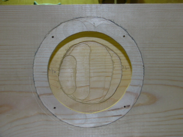

Panels are 3/4 thick. I stole some poly batting from my wife's sewing stash. I cut a strip the width of the enclosure, and ran it from the point above the driver, down the internal panel with a strip of 2" double stick tape to keep it in place. It ends maybe 8" below the driver for now. I'll lay some more of the same in the bottom, once there is an actual bottom. I figure the driver will need some playing time before final tweaking.
I didn't mention last night that with the single thickness baffle the FR125 magnet hits the internal baffle. I had to route out a recess for it, stepped from 1/4" to 1/2" deep.
