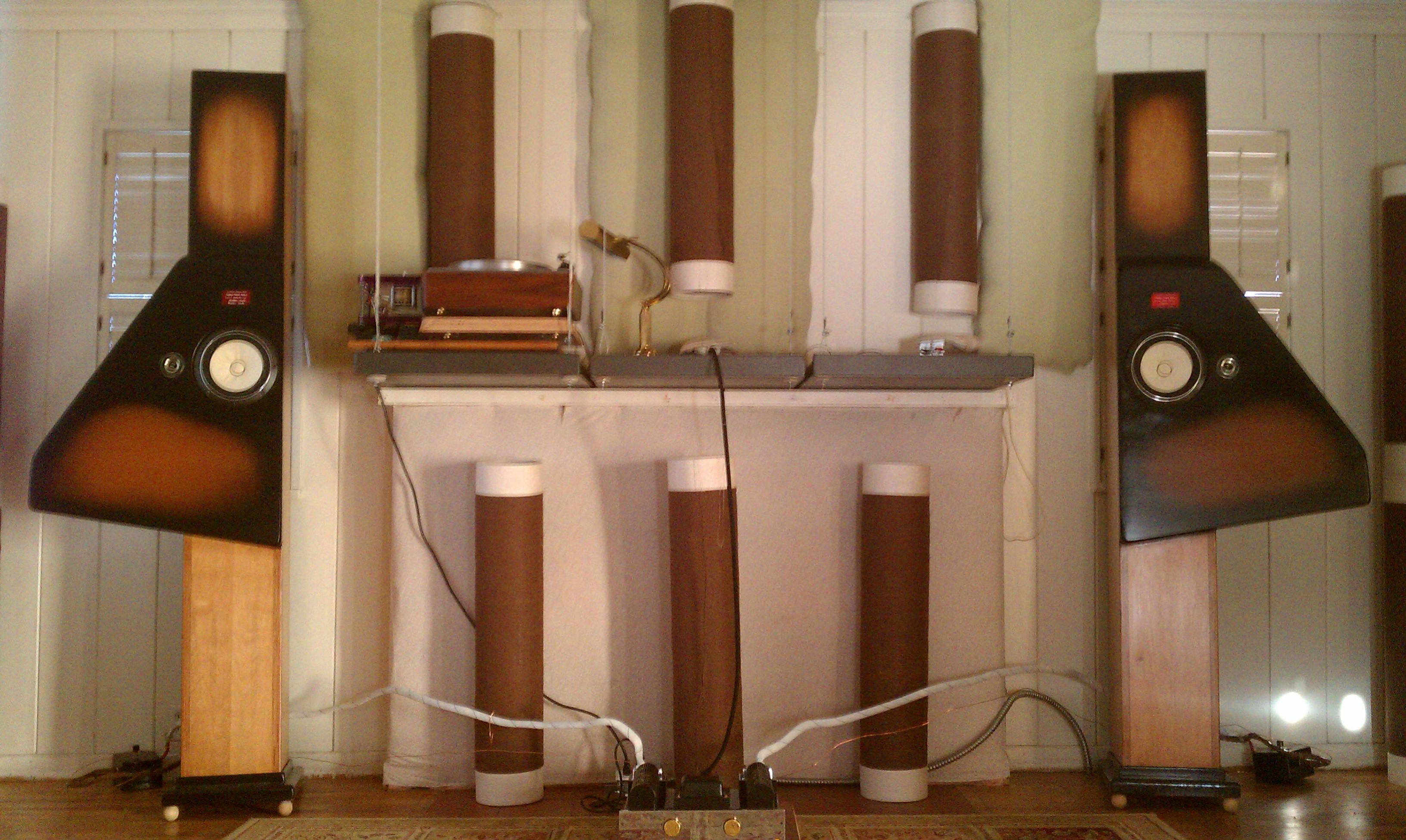

I made som baffles. Now when the mounting of the driver is firmer, the bass is better. Off coarse.
Uploaded with ImageShack.us
It sounds like a + 3000 $ speaker
Marvelous, i am wondering why people buy speakers in the shop.

Looks great. Did you add a tweeter on the back or not?
Not yet. I will first test with a pair John Blue horn tweeters i have.
They will probably be fine. You only have to add some twinkle and air there... i'd be happy with many different types of tweeters used as helper tweeters. Depending on your room, system and taste you may find no tweeter at all sounds good too. Enjoy!

Anyone who can give me suggestion for measures of the Suprabaffle?
This would be very room, system response dependent and even with relatively simple software such as EDGE it's going to be a crap-shoot as to how close to 'best' overall the size/shape would be which in my limited experience of finding it empirically required an organic shape rather than a sharp shaped [highly reflective] one like BW arrived at using EDGE, but then I didn't have any way to measure the results at a > 1/3 octave resolution.
Note that a round one is theoretically the worst shape since it has an infinite number of identical eigenmodes, ergo the highest amplitude peaks/nulls.

Now i am playing with a supertweeter:
It is a John Blue horntweeter, airy, pleasent. Horn is nice
I have chosen setup no 3 (0-1-0):
I will later try the tweeter bacwards with setup no 1.

If i understand you right, its probably better if i remove the round baffle and sand/remove some wood inside so the driver fits?
See my response to Lonnie plus considering your discs appear to be fairly thin and barely wider than the cab, either tapering its edge down beginning at the driver or covering it with a foam ring or similar may, may not make an audible difference depending on a variety of things. Only one way to know for sure though.
