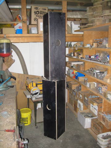

hi,
went to visit bib's and took snap; 25mm black stained ply (donated) awaiting routing of driver hole; stands to bring driver to ear height in conceptual stage...
so, as it was suggested earlier that the mouth should face the floor to load the line - is the distance of the mouth from the floor more important than the distance of the driver from the floor?
thanks,
adam

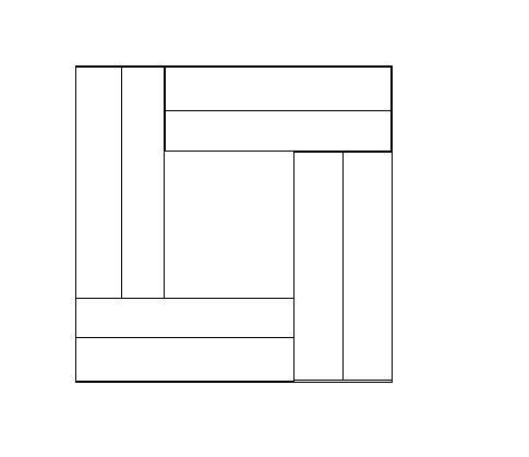

A weird idea ...
From another thread ... considering up/down firing drivers, and then omni-directional speakers ...
developing the omni-directional theme ...
What if one were to configure an internally-partitioned tower as shown?
Let's dub it the "Quad-BIB" - the idea being that 4 BIB-style compartments standing together?
(Leave aside the size implications!)
If one were to use (say) WR125ST's, and kept to the calculated L and Z, what would the effect be (sonically) in squashing the X-section to make a reasonably-sized and aesthetically-pleasing compound cabinet?
cheers
Doug

Re: coral 4A-70 project - photo of boxes 1
Yes since without good pipe loading there's no driver protection below ~0.707x its Fs.
GM
GM
Re: A weird idea ...
Sorry, not able to visualize it in 3D.
GM
GM

Re: Re: A weird idea ...
The diagram was intended as a plan view of 4 BIB's stacked together - "marching in a circle" as it were.
The inspiration came from consideration of mention made by Dave (@P10)
in this thread:
http://www.diyaudio.com/forums/showthread.php?s=&threadid=145589,
"Sonotube FR speakers".
Dave made reference to EPI miniTowers, which were omni speakers, with a driver on each face.
My comment arose thus ...
Clear?
The implied benefit was an omni arrangement with good bass.
Doug
