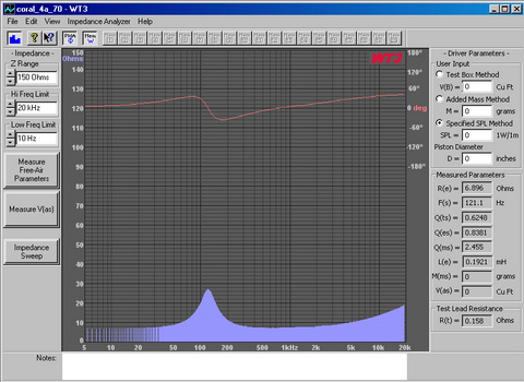

coral 4A-70 project - results from dayton tester
hi,
acquaintance has variety of full range drivers and a dayton woofer tester; presently experimenting with open baffle configurations.... has a technically inclined friend helping out - will encourage them to share their experiences on the forum.
hopefully text file and screenshot from dayton woofer tester attached below,
something to chew on,
thanks,
adam
hi,
thanks,
adam
