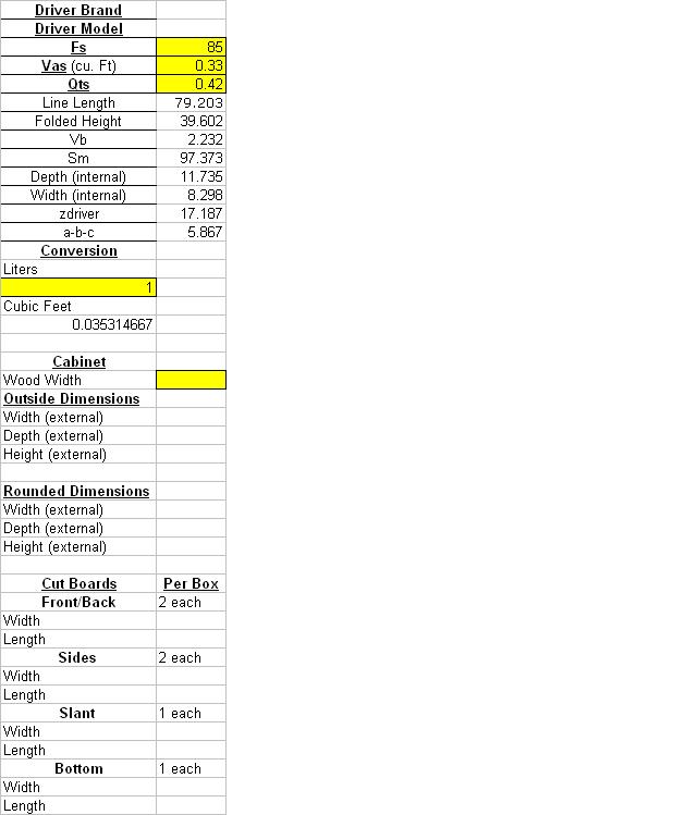

Here is a very rough estimate.

Greets!
Unless you build a straight, full height BIB (pointed end down) and space it up to get the driver high enough, then better to floor load such a high Fs driver.
WRT specs:
Sd = 62.211 cm^2
Qo = ~Qts = ~0.42
Mo = ~Mms = ~2.7 g
Fs = 85 Hz
Vas = ~7.166 L
where:
Vas = 0.01*po*c^2*Sd^2/((2*PI()*Fs)^2*Mms)
po = ~1.21 Kg/m^3
c = ~344.43 m/s
Sd in cm^2
Mms is in grams
Assuming a 2.5 ohms system output impedance, then Qo/Qts = ~0.55, making a maximally flat vented alignment ~19.93 L/63.4 Hz and making for a little bit larger BIB than Zayne's. All this is pure speculation based on somewhat erroneous data/assumptions, but based on the cab specs you used and your comment on its performance that implies too small a cab tuned too high, I feel they're well within the 'ballpark', though of course using measured specs is best.
Anyway, please let us know how the BIB turns out, etc..
