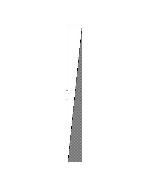

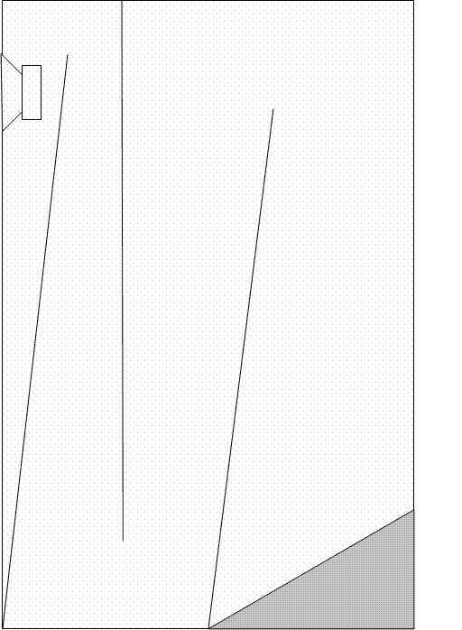

I just finished building a bib for fe126e. I built the inverted version, because my ceiling is 3.7m high. I am very satisfied with the sound, although I'm still testing all the stuffing options and I have yet to cut the k slot.
On the other hand, I was shocked how big it really is. You don't apprisiate the size untill you really see them in the room.
That got me thinking.
Could I straighten the pipe and hang it on the wall (mouth facing up)? That would save me enormous amount of space.
The back side would be flat, and the front would be tilted forward.
A thing that is bugging me is: is my ceiling high enough for that. (3.7m). Since the line length is 97" (2.46m) I would get little more than 1m above the bib to the ceiling.
Is that ok.
And other thing is: since the front would be tilted forward, should I build a baffle so that it's tilted back to normal? Or just leave the driver pointing little down?
Thank you very much
P.S. I will post picture of inverted bibs in a couple of days (when I get my camera back from a friend).
Is that ok.
Thank you very much
something like that
http://www.diyaudio.com/forums/attachment.php?s=&postid=1248596&stamp=1183575564
Yes of course, no reason why not. They should work fine. 1m clearance sounds OK to me. I've got just about that myself. If you're worried about the angles, you could always just build a rectangular box, with a full-length internal sloping baffle splitting it in two (see attached) and use the front half, while filling the sealed-off back part with cat litter or something similar.
I didn't think they were that big though. Mind, I think cabinets about 70in tall x 12in wide & 20in deep are just about right so I obviously have a skewed mind...
Scottmoose said:Mind, I think cabinets about 70in tall x 12in wide & 20in deep are just about right so I obviously have a skewed mind...
Its all in the mind! I am currently conditioning myself to thinking how small my 168BIBs are in preparation for building the 208BIBs

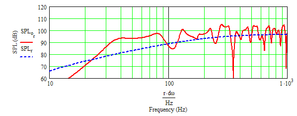

Originally posted by cheda13 Oh, I forgot to cut the k-slot. Well maybe tomorrow.
Btw- what does it do? I have no idea really.
You will note that the sims for the BIB typically have a lot of ripple. This ripple can be heard (but doesn't bother a lot of people). The idea behind the k-slot is that it will smooth the ripple. We don't yet know how well it accomplishes that.

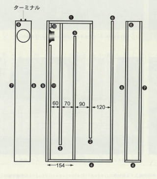

Hey all,
I am about to build a pair of FE166e BIBs. I do have a bit of an issue with corner placement in my room. I can’t help but think that having the speakers out into the room is more interesting for imaging. Placing the speakers flat against the wall or directly into the corners would have a negative effect on the imaging properties of my room.
I was wondering if having a 3-fold BIB (to make it twice as deep and half as tall) would have an adverse effect on the frequency ripples. The 3-folds would mean that the cabinet would be 24 inches deep and approx 8 inches wide and the mouth of the horn would be situated on both sides of the cabinet at the bottom rear (it would kind of look like the Big Fun Horn).
This BIB could be placed right in the corners of the room (and make 100% use of corner loading) and still project far enough in the room to offer good enough imaging (having the drivers away from immediate bounderies).
Please let me know if this has been tried of if you think it could have a desastrous effect on the pipe resonnance.
Thanks.
Thanks.
