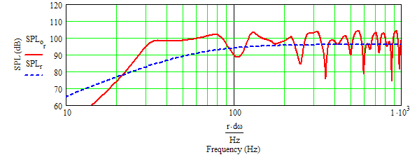

Richard Allan CG10 BIB
Richard Allan CG10 BIB:
http://fullrangedriver.com/forum/viewtopic.php?pid=15452#p15452
Greets!
Well, your limitations weren't very specific and to get most of the bass capability out of this driver requires a large cab. Lots of folks are enjoying simple 'BIB' pipe horns: http://www.diyaudio.com/forums/showthre … ost1245325
Basic layout info: http://www.zillaspeak.com/bib-howtobuild.asp
L = 138"
zdriver = 30"
Sm = 604.082"^2 (recommend ~20.668" W x 29.228" D)
a-b-c = 14.614"
Round off the dims as required and search the thread for folk's stuffing experiments to get you started.
If these are too big, then as size shrinks, so goes bass response with F3 rising.
GM
FYI, enhanced specs:
Fs....................58
Qms................3.58
Qes.................0.63
Qt....................0.536
VAS(cu ft/L)........2.63/74.473307
No (%)............2.2
Cms (M/N).......5.34
Mms (gms)......14.11
BI (Wb/M)........7.8
calc'd:
Sd (in^2/cm^2).......... 48.3291/311.8
dia. (in/cm)............. 7.8445/19.925
Re (ohms) ....... 7.46
sens (dBa)........ 95.48 dB/W/m
