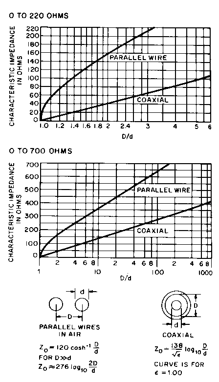

Hope the diagram is readable. Best I could do with a borrowed scanner, and the 100k limit.
It is from the Reference Data for Radio Engineers, out of print for about 5 years.
I have a whole lot more equations/ diagrams for the next time you tweak me. [joke]

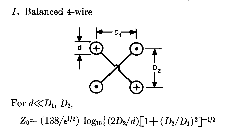

Like this one..........

Jocko's TDR Testing.
Hello All, Thankyou Jocko for your cable characteristic impedence calculation diagrams.
Jocko, what test setup do you use for TDR testing - Can it be economically home built ?
Also, in your library of measurements have you examined Canare star quad speaker cable ?
Has anybody sent you some 10, 20, or 25 pair yet ?
If so, I'm sure we that we would all be interested in your measurement results.

Found 2 star-quad types around here to measure.
#1 is about 0.3" OD, blue jacket, so I suppose it is something Audioquest made at one time. Looks like 16 Ga. conductors.
#2 is by FMS, about 3/8" OD. Fatter, hollow-core (or "flux gate", as Alex liked to say) conductors of probably the same effective gauge. Should have lower impedance due to closer spacing.
#1: z=45 ohms
#2: z=33 ohms
Remember z=sqrt(L/C), so I'm not sure I would use a cable that reaches the mythical "8 ohm" range. Too much C could cause some amps to smoke.
Ciao......Jocko
#1: z=45 ohms
#2: z=33 ohms

I agree that low (8 ohm or so) impedence cable is not desirable because of high shunt capacitance - what about an amplifier purpose designed to drive high capacitance loads ?
Question - Star quad (30-40 ohms or so) should provide a better speaker line and matching at least at HF where drivers impedence(uncompensated) rises to these sorts of values ?
