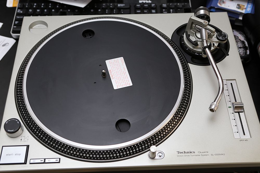

the transformer voltage of the SL-1200mk2 and its heirs is vastly higher than needed.
Behind the regulator the supply rail measures 21V.
Adding 3V for the regulator itself any dc voltage from 24V on will suffice.
The 21V themselves would not be needed that high.
They only supply the motor driver IC, the AN6675.
This IC is also used -together with its partner control IC AN6680- in the SL-Q2, SL-Q3, SL-Q33 and some more.
In those players the supply rail is 12V.
What difference dose this make?
It only reduces the maximum motor coil current, which is used to correct for gross deviations from the set speed.
This happens at start up and maybe while scratching.
Under typical low- or undisturbed home hifi conditions the motor currents are very small and so are the regulating variances.
In other words is the higher possible torque of the motor only due to the higher supply rail and is to no advantage at all for home hifi useage.
The second IC of this Chipset, the control IC AN6680 is not supplied directly but over a resistor with different values for a 21V or 12V supply rail.
This only feeds an internal power circuitry that generates a fixed reference voltage for an external-to-the-IC voltage regulating transistor (Q201).
The output voltage of this regulator (9V) forms the real supply rail for the AN6680 and the FG-Generator circuitry.
In other words the control circuit generates its own dedicated supply rail.
With these infos in mind, where and how could modifications improve matters?
Taking the transformer out of the mechnical systems may put away with possible vibrations.
Replacing the tranny by a lowpower SMPS of 24-36V (or >=15V for the 12V models) may allow to keep the complete electronics inside the player's cabinet.
Other than that I could only think of artefacts of the control ICs supply current (maybe due to gnd-layout, where both ICs share traces) that influences on a very low level on the motor drivers supply rail.
Personally I don't see a requirement for oversizing supply capacitance, as there are only small current variations and it makes no difference at low frequencies down to dc to the supply rail impedance.
I'd rather opt for a low impedance regulator combined with a star-shaped system of supply rail traces (cutting rails and gnd traces and rerouting)
Pushing a bit further one may think about implementing dedicated regulators for the motor-IC and the control-IC and rerouting rails and gnd.
I think I'll do that on my actual project with SL-Q2 electronics even though I don't expect nearly as large improvements than some exaggerated(?) claims suggest.
The reason is imply the way the drive sytem works.
In contrast to some explanations there occur no large current pulses that somehow give the platter short and massive high-torque pushes, but only small and softly varying continuous currents and torque.
The currents and hence the torque are so low that they only make up for the tiny friction losses, added the drag of a cartridge needle and maybe a cleaning brush.
So, within a certain defined range of 'error' load, a weak-torque and a high-torque motor don't make any difference whatsoever!
It just increases the load range to within the PLL can hold the platter speed locked.
Which also implies that the stronger motor is not responsible for any sonic differences between the Technis models (actually the motor is identical, its just the possible higher currents that make it 'stronger').
Besides the mechanical time constants are always vastly larger than the electronic time constants, thereby effectively swapping/filtering out any ripple or wobble of the torque.

In my experience, the things you should do to the stock SL-1200 are,
Platter Mat - Not the stock rubber. Cork is very nice. As is the Acromat from Funk Firm. Most certainly no felt or slipmat.
Feet - even something as simple as placing vibrapods under the stock feet helps an awful lot. I am a huge fan of Isones. Expensive but not silly audiophile priced. Worth every penny.
Tonearm rewire - the stock tonearm wire in your arm is most likely corroded. Of course new wire is going to sound better.
PSU - It punches so far above it's weight that it's silly. A must do.
With PSU, a good mat and good feet you may, without hesitation, mount any cartridge on the table your heart desires. It can handle it, and with style, grace, and a rythm, timbre and tunefulness that you will never get on a belt-drive table.

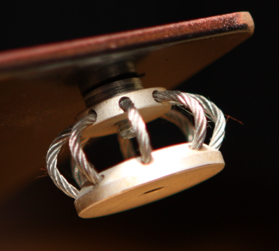

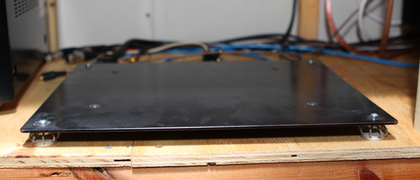

4) Feet - currently have a DIY vibration table that provides three-axis damping, but the Isones look interesting. Got the wire feet from Shock-Tech at a military trade show a few years ago, but I'm thinking the TT may be too heavy for them.
1)Yes
2)Yes
3)Yes
4)Neat!

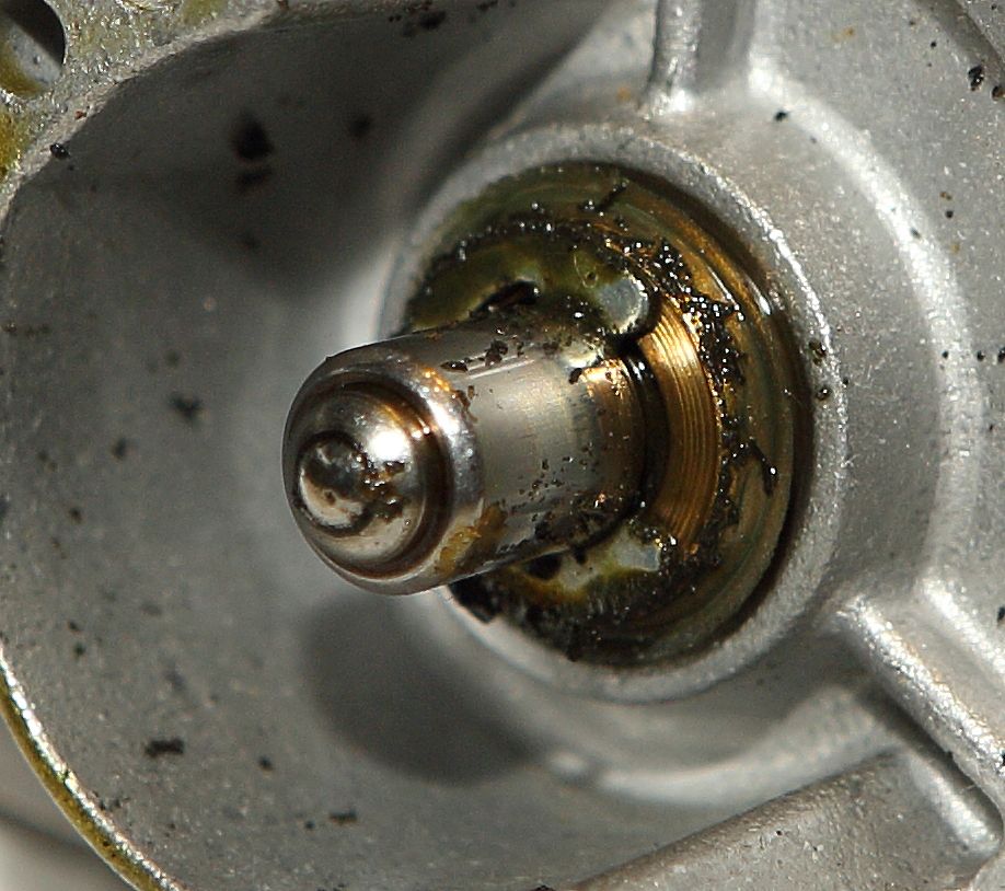

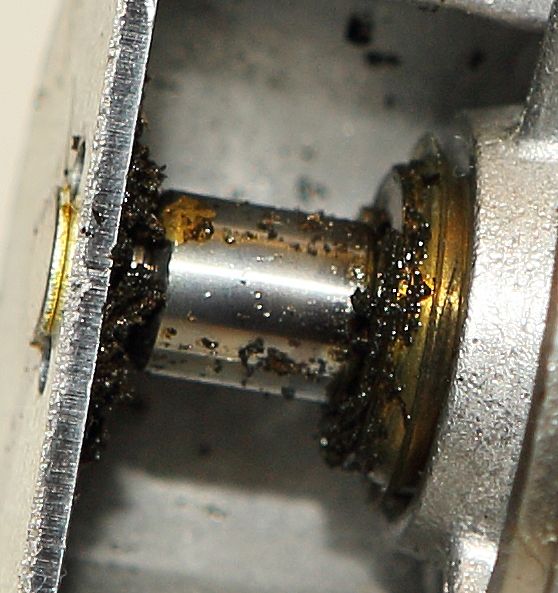

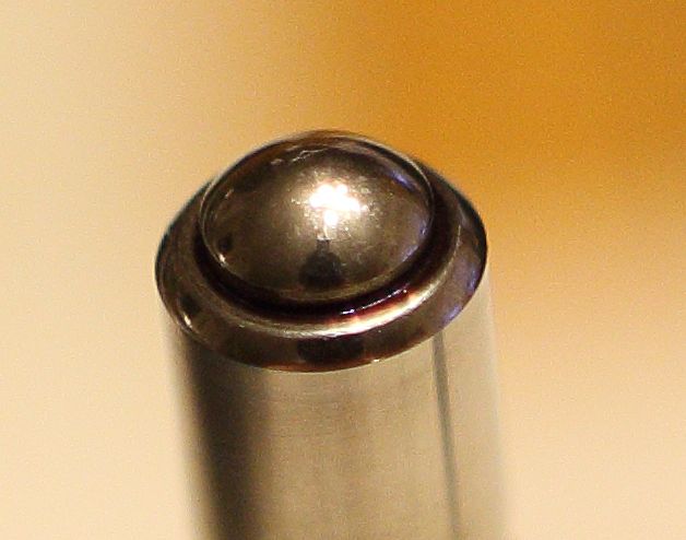

Getting a bit off topic from power supplies, but I figured I would add this here rather than creating a new thread:
Last night I was playing around with the TT and noticed an intermittent and non-periodic grinding or scraping sound as the platter rotates. It lasts for less than one second and sounds a little "gravel-like" and then disappears. I am unable to cause it to happen by changing RPM speed with the power on, or by spinning the platter by hand with the power off. I presume this means I need to remove, disassemble, and clean (perhaps replace) the motor spindle. The ring magnet under the platter appears clean and does not have any debris stuck to it. Is there anything else I should look at? The platter itself appears to spin true, no vertical or horizontal deflection as it rotates and the visible part of the spindle appears steady (no wobble) as the platter rotates.
Thanks for any insights.
Eric

Hmm... I'll have to dig more deeply into it shortly. Like with cars, diagnosing the intermittent problems is always most frustrating, but I'll find it.
My wife already makes fun of me by saying things like "The first thing most people do with products that have JUST arrived in the mail is DOESN'T usually involve disassembling them!"
Pass DIY Addict
Joined 2000
Ha - after 20 years, she just shakes her head and laughs at me while I'm holding my screwdriver...

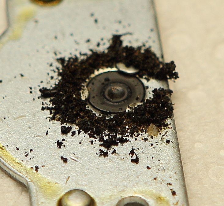

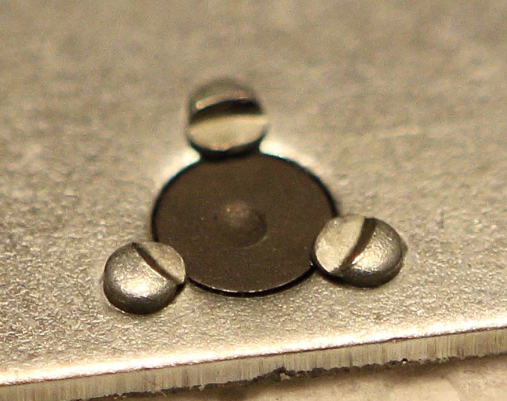

Taking things apart was definitely worthwhile. With a closer look, I found a small rounded blob of a metal fragment hiding on the magnet under the platter. I suspect this was the source of my intermittent noise. But I figured I would have a look more deeply into things and I'm glad I did. Here are some images of what the spindle mechanism before and after a good cleaning. I was surprised by the quantity of debris present and was pleased with how nicely everything cleaned up. With the exception of the shallow cup worn into the thrust pad, everything looks great now. A drop or two of oil makes everything spin noticeably easier than before.
Fantastic that you found the noise, and even better that you dug deeper and cleaned that gunk off the thrust pad!
I enthusiastically suggest getting the proper oil from KAB, it has a very high film strength so it stays on the bearing, but is light enough to be of genuine benefit.
