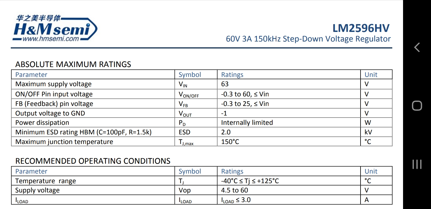

I have been reading this thread with interest and will do this mod also on my SL1210. While externalizing the PSU I also want to replace the voltage regulator? Is using a LM317 or similar better that the linear voltage regulator that was used originally?
Can we also use simple buck DC-DC step down modules, like i.e. the LM2596?

But isn't the LM317 also on the limit? The voltage drops to 31 bolts right when connected?
Input voltage for that regulator is on the limit...
