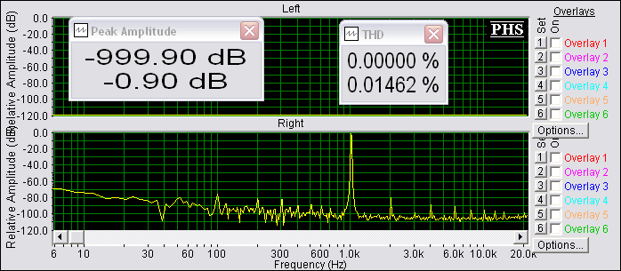

Tried to measure THD and IMD with SpectraPLUS. To feed the output of the amplifier I made a simple resistive divider (100Ohm in series with output and 3.3Ohm between output and ground). Can anyone comment, if these are optimal values, or should I use som other?
The program is realy powerful, I liked it, but for now I still get inconsistent results - for instance one time I get 1.2% IMD, other time I get 0,65% IMD - all with the same levels set in Windows mixer(oh, I chenged small film caps near Vp 0,33mkF, 1mkF, 100nF and got the best IMD results with 0,33 unknown film between -Vp and ground and 100n between +Vp and ground (0,63% IMD) - odd combination ) In non-split unregulated channel I got ~0,83% IMD.
All with 60Hz and 1/4 x 7000Hz frequencies, 60Hz was -10dB.
In other test with 250Hz and 1/4 x 8020Hz the results were MUCH better - ~0.035% in both channels.
THD in split Vs, Vp channel was 0,047% with test signal at 1KHz, -10dB level.
I've attached one of the plots -it can't be fully trusted, but maybe you'll have some comments or suggestions... I'm a newbie, and don't know much, how to interpret them

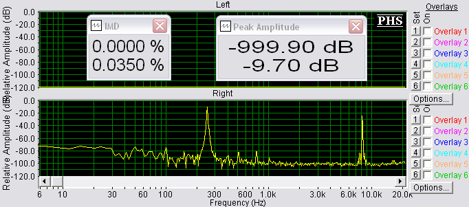

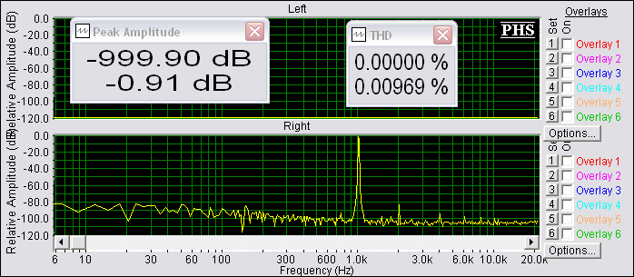

Now I've tracked the problem with inconsistent results - I've managed to connect both 3.3 Ohm and 100 Ohm resistors in series! in voltage divider
After this was fixed I ran the tests again and got following results:
THD 1kHz, signal at -0.9dB:
Unreg. channel: 0.0146%
Split Vs, Vp : 0.0097%
Result: 1.5 times less distortion. Most obvious improvement here is much less higher order harmonics(from 3rd, and so on) in case of split supply. The second harmonic decreased a bit too.
IMD 60Hz, 7kHz, signal at -10dB:
Unreg. channel: 0.0963%
Split Vs, Vp : 0.0476%
Result: 2 times less intermodulation distortion
IMD 250Hz, 8020Hz, signal at -10dB:
Split Vs, Vp : 0.0141%
Result: roughly the same intermodulation distortion, but comparing the graphs, the one of split suppy channel looked smoother.
THD graph of unreg channel:
All these tests were taken at quite low total amp power, because the voltage divider didn't lower output voltage too much. 3.3 Ohm resistor didn't even get hot... however music is already listenable at this volume.
THD graph of split supply channel:

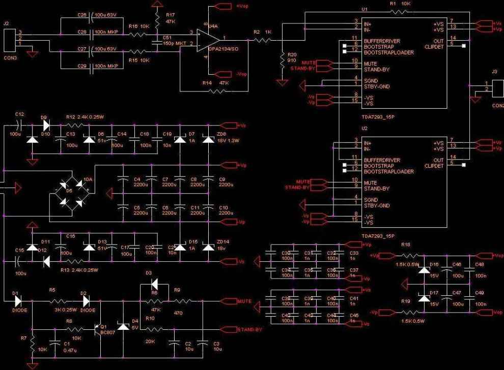

TDA7293 with separate supplies in parallel
Hello folks, first i want to thank you for usefull information you share. I figured out to make working amplifier with separate supplies, it works perfectly. the difference is audible with TDA7293 and TDA7294 chips. BTW the TDA7294 sounds better than TDA7293 and it gives higher slew rate.
My problem is that i blew up two of these chips immediately when i tried to make it parallel. I attached exact schematic i made. Please, help me to figure out how to make it work with separate supplies in parallel.
Thanx
Alex
Thanx
Alex

ilimzn said:Well, I am about 3 years too late here, but anyway:
TDA 7293/94 have relatively poor PSRR, which is why a separate well filtered power supply on the signal section can improve things quite a lot.
Why does it blow up if you connect the signal power via a RC filter to the output power? Well, the reason is rather simple if one knows a bit about IC design:..........
If separate power supplies are used, care should be taken that Vs never becomes over 20V more than Vp.
thanks for your detailed post.
another method maybe safe ,good and simple. one chip for VAS, just connecting the +/-VS pins,and the +/- PVS pins are No Connect.another chip or more chips for power output.
my test of the chip for VAS is OK.the sink is not need for it,cause its IQ is about 13ma,its diss power is about 1.3W at +/-50V(if the +/-PVS pins is connected with the +/-VS,the IQ of chip is 45ma!!)
I will build the power amp of 1 chip for VAS and 3 chips for power output next step.
X.G.
