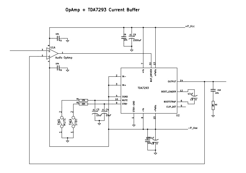

Big Current Buffer??????
The most interesting section of this thread starts with Panson at post 12 and then Abraxalito at post 18.
I wonder if any TDA7293's have been employed as a current buffer for an external op-amp or maybe even a tube or discrete? I may be off the mark, but it looks like you can paste the TDA7293 current buffer section onto the output of your favorite headphone amp and then proceed to drive speakers with it. Has anyone made such a composite?
It has been a long time since my last post of this thread. In this summer time, I want to continue this project. I will evaluate an opam + TDA7293 buffer in a unity-gain configuration as sketched in the attached figure.
