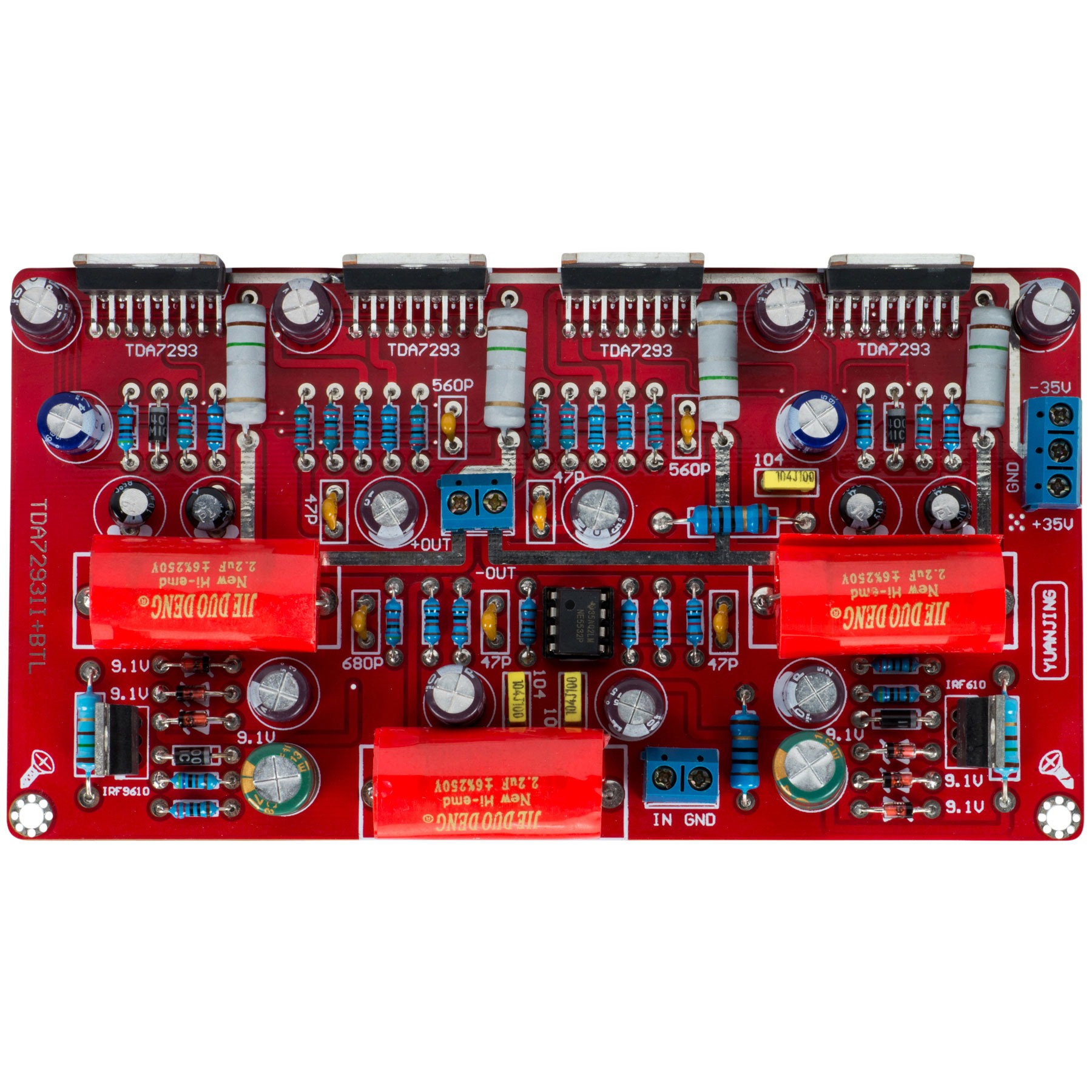

Got the dummy loads mounted on a heatsink today, and got very different readings when measuring DC-offset compared to what I got with unloaded outputs.
First, I used Arctic Silver 5 TIM between the resistors and the heatsink.

So, the numbers measured with dummy loads look alot better, to me atleast.
What do you guys think?
With those readings, you're going to hear a "ka-thunk-a" at no louder than a normal speaking voice and at far less force than the capacity of a speaker that could handle this amplifier's music output.
Well, the voltmeter has shown a turn-off thump at ~1/20th of the required speaker capacity.
That could fry a speaker that is more than 20 times unsuitable for an amplifier with this much output power.
A little 3" full range might x-max to bang the coils. Do use a bigger speaker than that.

The amp is to power one 15" Dayton IB/channel.
You can try the board's default/marked arrangement for the mute circuit, to see if you get a different amp turn-off behavior.
So the ON/OFF "thump" would be to high for my Dayton 15" IB woofers?
I do have a spkr protection board that is currently in another amp....
Oh, no, that thump is not too much for any speaker that could withstand this amp used full blast. Mine says a wee little ka-thunka (through the speakers) and not very loud. Well, at least I suppose it wasn't very loud because, just before that I had the music actually very loud.
I was thinking that it is worth an experiment to try re-timing the standby and mute circuits to see if that has any verifable merit. I would like you to try the board vendor's mute circuit idea to see if it resolves the thunks.
It would be a great favor to me if you'd compare the thonks of my circuit with the board manufacturer's suggested mute circuit (conveniently already laid out on the board).
