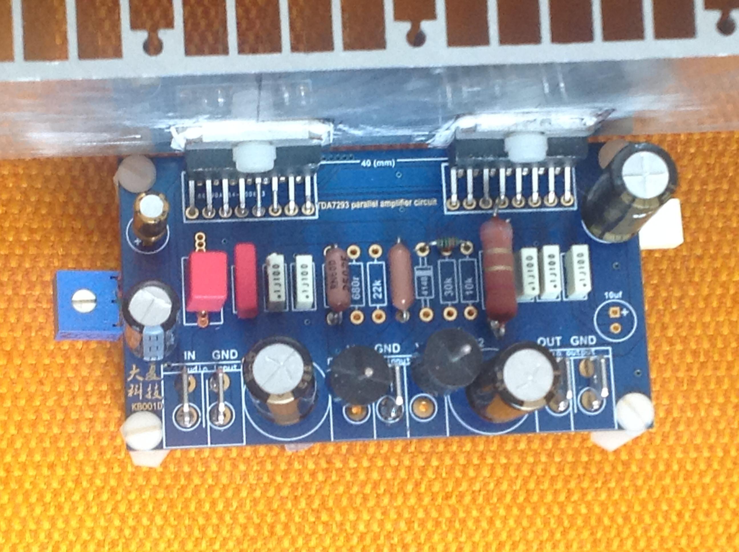

My Corona Virus Build
First, a very public THANK YOU to DanielWritesbac2, his patience with noobs like me, perseverence and dedication inspired me to do this as my first (successful) electronics project.
Also, thanks to social distancing, and work-from home, I've been able to get back to this project which I first saw in 2015. I also compared a couple of single-chip pre-built boards from Ebay that gave me crappy distortion numbers (I could hear it!) so I know this board and these component values deliver on the promise of good sound for just a few $$$.
I used a 3.3 Film capacitor at the Input, because it's the largest I could find that would fit on the board.
Here I used a simple 25K resistor...for simplicity, and because I could not find an easy way to add the 100K VR along with the 39K resistor... I feel I could use a bit more midrange to boost voices... so I might try a 22K next.
See Photo of bottom of board to see how I did this... Had to thread a few length of wire insulator on to the legs to keep the VR from touching the exposed traces. I also have the two pairs of 220 uF capacitors stacked vertically, and use the single pin from the V+ and V- power diodes to connect to the PSU.
First I listened to music with my son and Daughter-in-law (young ears, you know?) and we all agreed the sound was great. Then I used XRK971's REW distotion analyzer rig to measure the amp. It has better numbers than my CARVER M500!!!
I am working on posting a diagram of the board showing how the schematic maps on-to it, and will also try to attach a mouser BOM.... THIS IS FUN!!!
Six.
P.S. I did deviate a little from the schematic and used 100 uF for the Feedback capacitor with a 1uF film stacked trackside. I got that idea from Dibya's TDS7293 Xmas amp by Jhofland

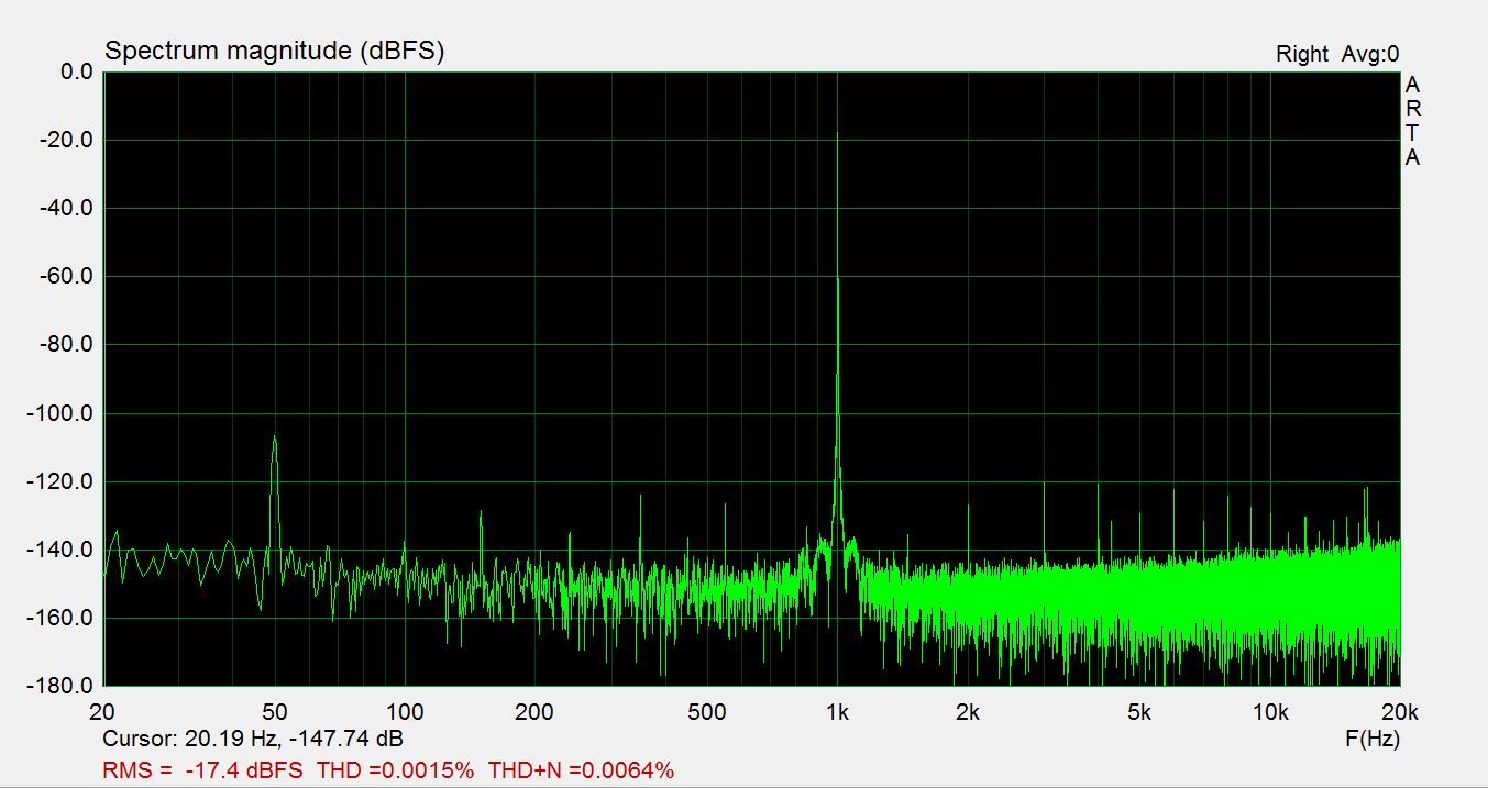

Nice work, Sixto!
Thanks for the distortion measurement - it shows what I suspected, that the TDA7293’s quasi complimentary output DMOS stage makes dominant second harmonic with descending higher orders. Glad you are making use of REW for measurements.
Dibya’s Xmas amp will probably measure similarly and I may not bother to measure now.

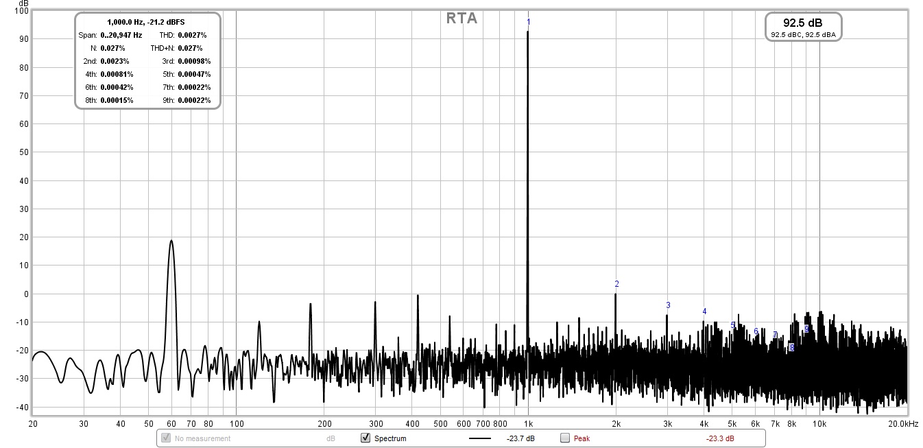

I'm not having as much luck... just tried running a distortion plot with parallell 8-ohm resistors for a 4-ohm total load, and I got a lot of noise, and a lot of heat, both at the amp heatsink, and the resistors heatsink. I think maybe the way I connected the resistors is giving me some weird results (oscillation?) . Photos and distortion plot attached.
I was expecting worse distortion at 4 ohms than 8 ohms but not the level of noise or possible oscillation I'm seeing. Curious about any suggestions folks may have to track down the source of noise?
Six.
P.S. Nope - something else is wrong... went back to the 8-ohm setup and I'm getting similar readings... too noisy!

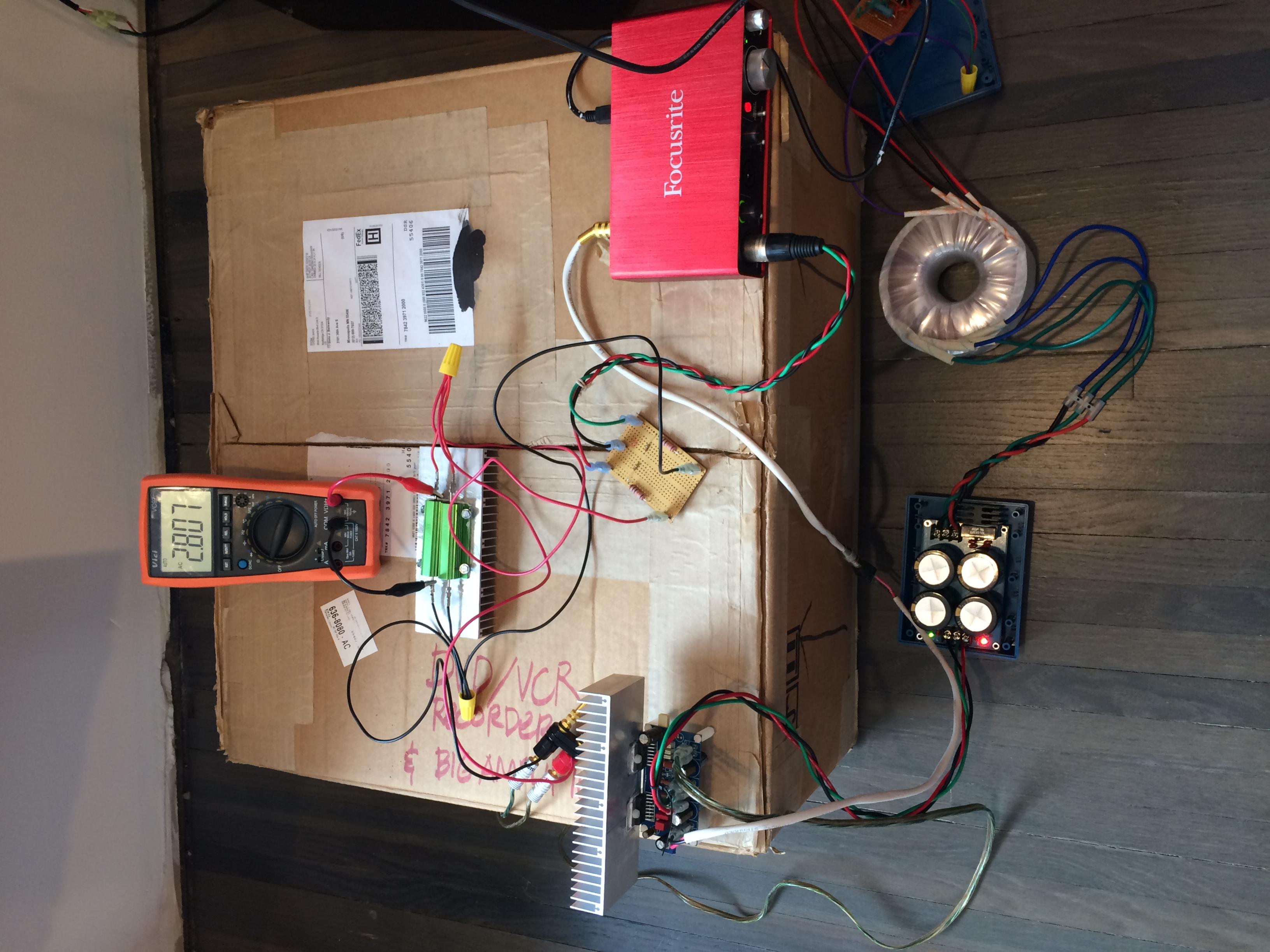

Hi Sixto
at your attenuation board i see 3 cable going into the focusrite box for the THD measurement but i miss the "GND" at the other side......or not?
maybe this fit to your use:

Looking into sudden noise & distortion...
Well, I've determined the USB interface is not the issue, and neither is the attenuator with the 3 wires to the Mic-in plug though I will look at grounding that back to something... (Plugged the Carver M500 back in, and it performed just fine with the same setup... plus I can hear the extra noise and distortion the TDA7293 puts out when I listen through a speaker) I looked through the board, and it was clean... checked all the solder joints, and made sure the 200r VR pins were well insulated from any ground traces on the board. No luck.
I'm afraid I may have done something to the TDA chips (maybe I got some bad clone chips?) so I will try to desolder and install 2 new chips. Now that I'm back to work after the holidays, I only have time to play on the weekends! :-(
Does anyone know if there is a way to test the pins on a TDA7293 V6 chip to see if everything is fine inside?

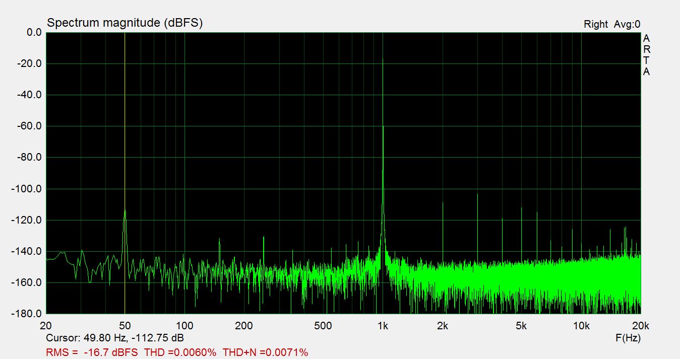

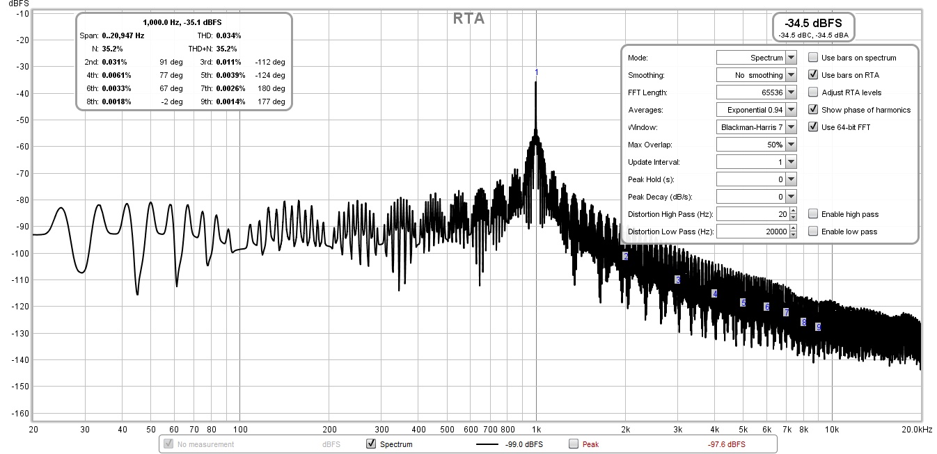

@Sixto and @xrk971
Thanks guys for publishing the distortion data. This is what I was missing in this otherwise great thread. What I wanted to say is that we have seen proposed modifications without a proof of their advantages.
On the snapshots below two measurements of unmodified stock design with a single IC are presented.
Measurement conditions:
Power supply: +/-35V, CRC
Sound card: Xonar U7 MK2
Dummy load: 4 parallel 22R, 100W resistors:
Heat sink: SK 56/100/SA (0.4K/W)
No smoothing and averaging has been applied to the measurement to avoid "better" results
By using rather large dummy load I was able to torture the IC at long high constant power output runs without the risk of thermal destruction.
It is important to note that besides low THD I was able to attain low noise too.
Also, another important conclusion is, that it is possible to attain Hi-Fi quality by using stock design on wide range of output power. For example: at 10VRMS (18.2WRMS), THD and THD+N were 0.0015% and 0.0064%, respectively. At higher power output both THD and THD+N have remained consistently at low level reaching values of 0.0060 and 0.0071 respectively in the proximity of clipping point at 20VRMS (72WRMS).
Conclusion: with proper PCB layout, stock design may result in respectable performance.
Fig. 1. ) 10VRMS
Fig. 2. ) 20VRMS
