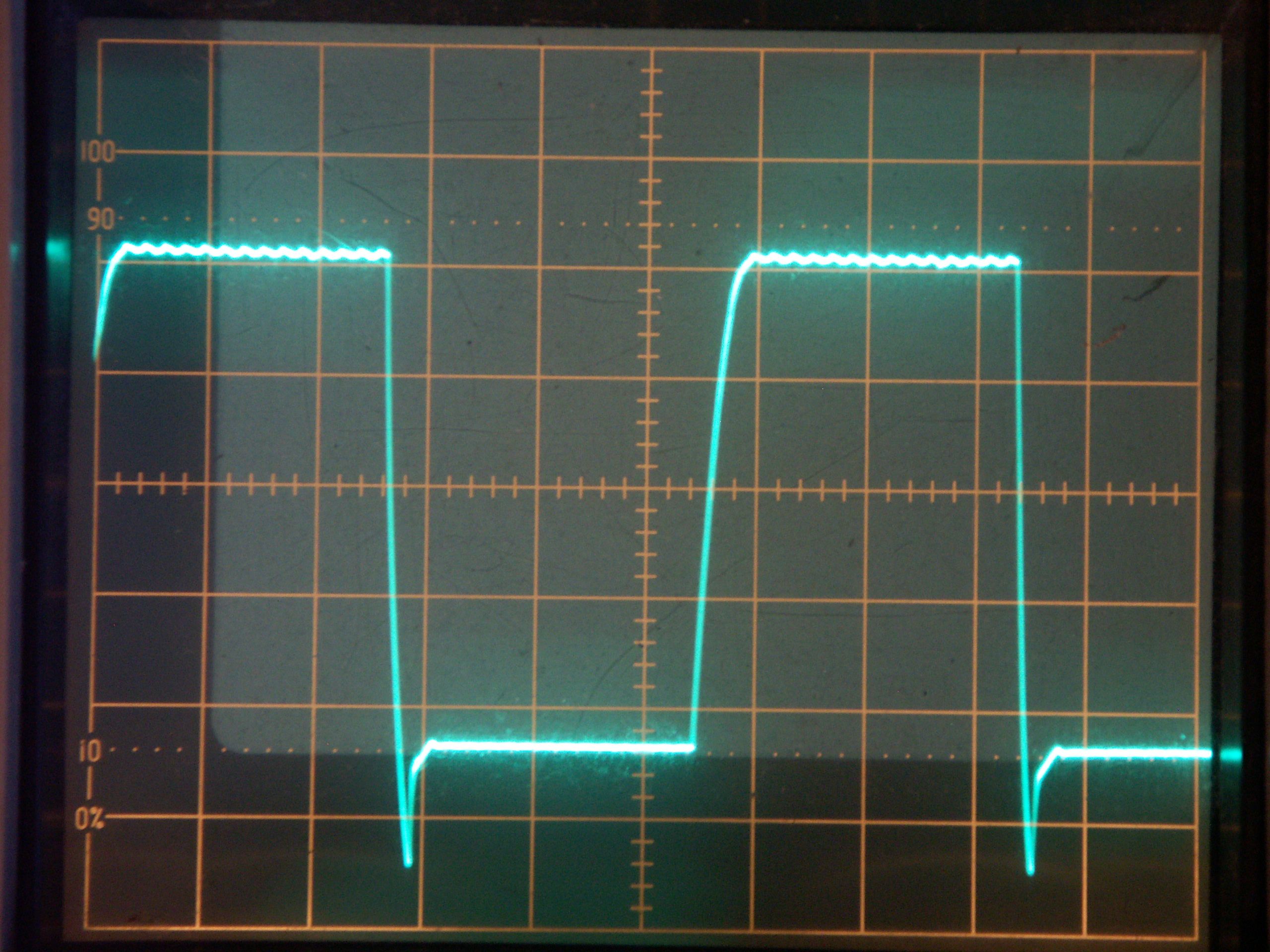

Waveform of the Grundig solution. Horizontal: 1 us/div, vertical: 500 mV/div. Measured at pin 16.I just tried the Grundig solution, where the DEM oscillator is driven from WS (4x OS), that is one full cycle per sample. I haven't listened yet, just checked the waveform on pin 16, looks nice. Pin 17 is AC filtered to GND. On the Grundig diagram the MSB filter capacitors at pins 13 and 18 are 1uF, all the rest are .1uF. Shall I increase all capacitors to 4x their value if I go for NOS? Why would be 44.1 kHz DEM frequency too low?

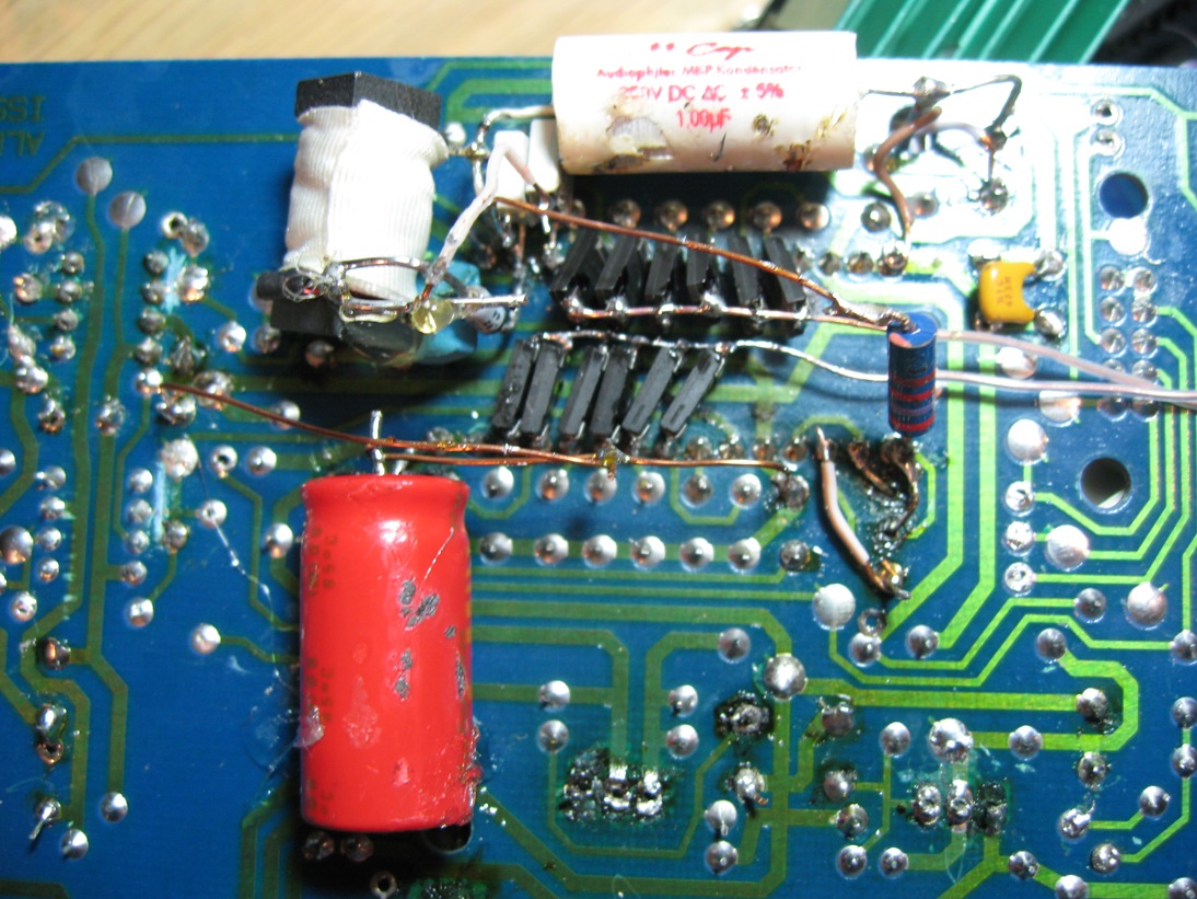

I currently use 8u smt polymer caps soldered right on the 1541a pins, and a Riken carbon resistor to the WS pin for clock signal.
Here is a useful thread where I first learned about modifying a tda1541a dac.
http://www.diyaudio.com/forums/digital-source/167068-arcam-alpha-mods-23.html but the caps now used are better.
I even share an old pic of my first prototype using 220nU film caps to prove this does not need to be neat to sound great. I also put a choke between the +15v pin and the DEM circuit to keep each other from poluting the other's power supply. The big red cap is a BG N right on 15V. No wonder it sounds so good. Forgot that is under there!

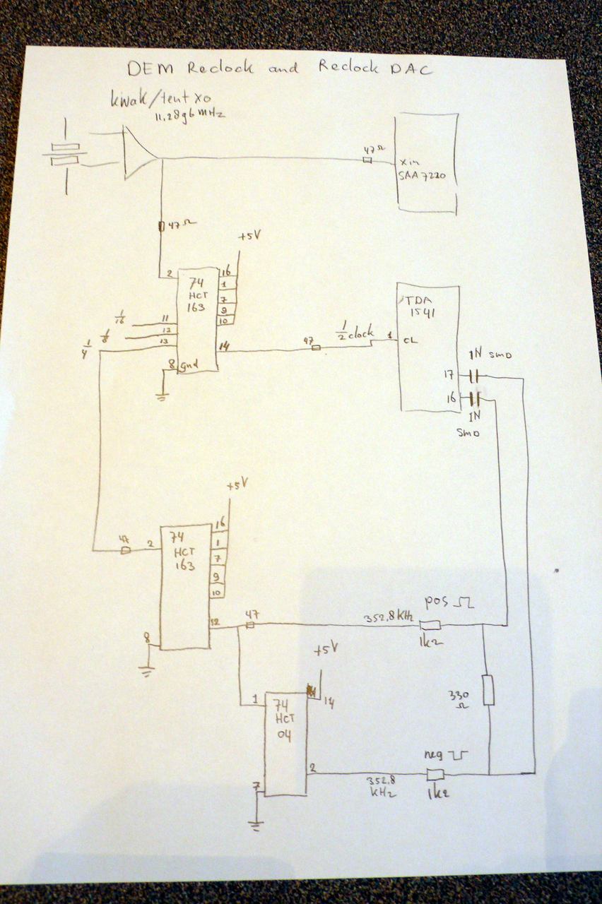

Finally, made a drawing to dem reclock a 1541. Have fun with it. Remind: all the credits goes to ECdesigns!
How i did it:
Added 2 counters and an inverter on the Kwak pcb

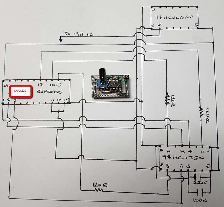

I know this is an old thread, ish, but I have a re clock circuit that doesnt match up with anything else I can find on the site, thought this may be a better place to post the image as you guys were into this until at least last year it seems, apologies if everyone has moved on and this is a dead duck, I still have a few TDA players that I collected many years ago and life just got in the way of modding them....
So if anyone could have a look at this and tell me if its any good or just wrong I would be much appreciated.
