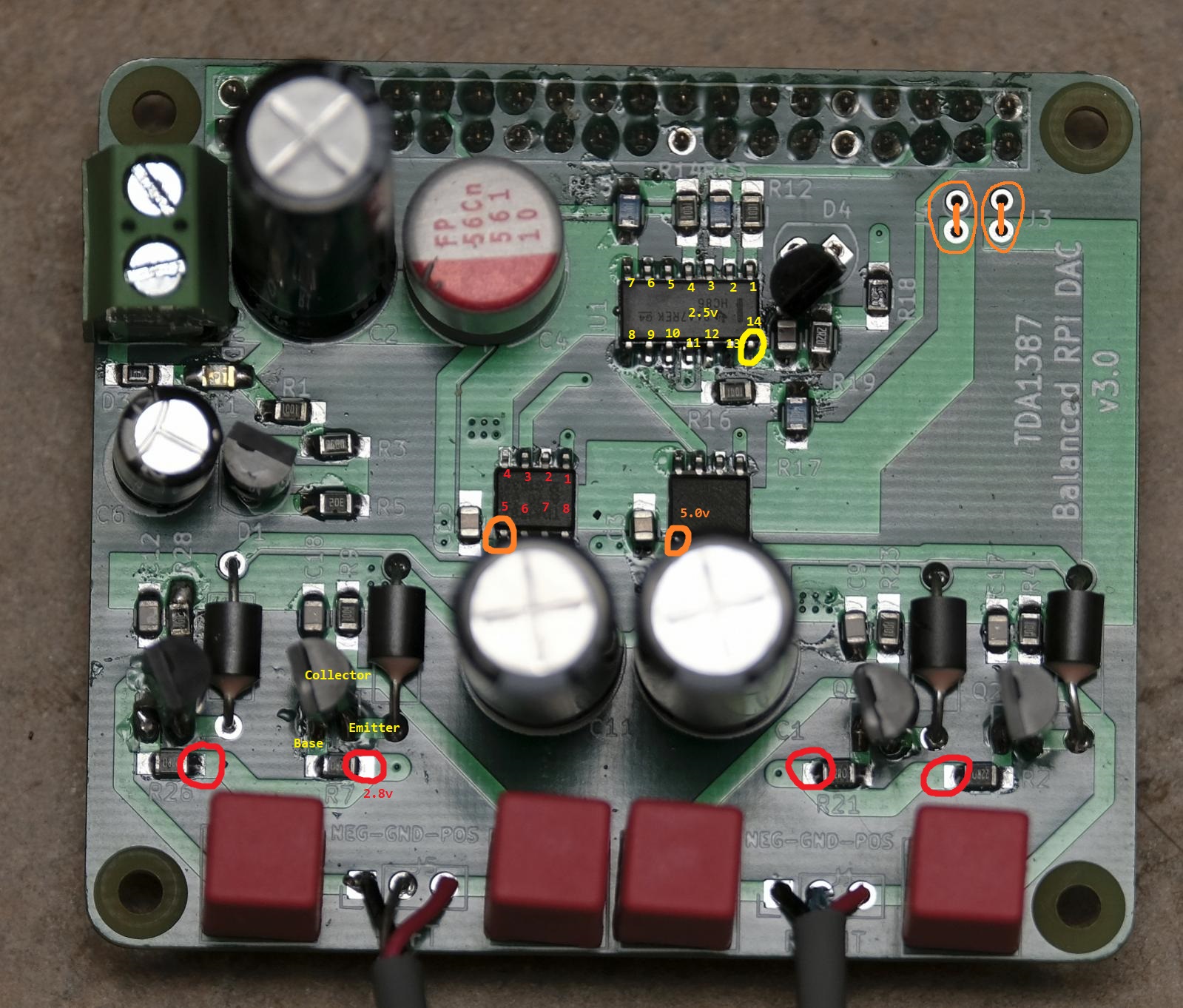

I am having no joy with this build. I am guessing I may have soldered the ICs incorrectly or overcooked them on the hot plate. Also, when I configure Volumio it asks for which DAC is installed. Quite a few listed, so perhaps that is also a problem.
Hi David! Nice to see another build in the wild, even if it's not currently working. Hopefully we can get you squared away! (I can't remember, did I send you that board, or did you fab it yourself?)
*** I typed up everything below, but as I was reviewing, I noticed something in your pic. See the two orange circles in the upper-right in the image below? You need to jumper those (I use left-over component leads). The board has multiple ground planes, this is the "star" connection point for those separate grounds. If you don't jumper those, much of the circuit will be open. :) So that's step one. After you address that, I'd suggest running through some of what I wrote below, at least the powered-off sanity continuity checks.

Next up, with the board not powered on, you can do some basic sanity checking with your continuity checker. See the image below, I marked it up a bit. Check for continuity (zero or near-zero resistance) between the following tda1387 pins:
1 - BCK
2 - WS
4 - GND
5 - VDD
In other words, pin 1 on both tda1387 chips should be connected. The same goes for the other pins listed above.
Then you can also check for continuity between the following HC86 pins and the corresponding tda1387 pins:
HC86 pin 3 - tda1387 pin 1 (BCK)
HC86 pin 6 - tda1387 pin 2 (WS)
HC86 pin 8 - tda1387 pin 3 (one chip only)
HC86 pin 11 - tda1387 pin 3 (the "other" chip)
HC86 pins 7 and 10 - GND
HC86 pins 13 and 14 should be connected
Next, for each tda1387 chip, check that no pin is shorted to any other pin. This is very tedious! Do the same for the HC86 pins, noting the above pins that are supposed to be common (7/10, 13/14).
Looks like you figured out (or maybe I told you?) about the tl431 silkscreen being misleading. Next step is to power up the board and check voltages. Pins 13 and 14 (yellow circle) of the HC86 should be at 2.5v.
On the tda1387 ICs, pin 5 (orange circle) should be at 5.0v.
What kind of transistors are you using for the "active" I/V? Where I've made the four circles in red, those should be at 2.8v - assuming you're using BC857, BC807 or similar. Do make sure you have the leads soldered correctly! In particular:
Emitter connects to the ferrite bead
Base connects to the 22R
Collector connects to the RC network
Hopefully we get you playing sweet sweet music!

Yes the boards you sent Matt, thank you. A big oops on the jumpers. I will try that, perhaps it will play, fingers crossed. I will double check my work and the voltages. You are most kind to lay out the points to check. Volumio does offer a hifi berry dac.
I will work through this tomorrow during the day.
David
Thanks for these suggestions, Matt. Added jumpers, check continuity and voltages. All good. I have a dedicated Pi, Kali, Piano rig. In order to leave that setup alone I ordered another Pi and will go the DietPi route you are using. I think this will be easier than going back and forth with the only Pi I have in house.

Success Matt. It was a case of BE (builder error) on my part. Your suggestions were most helpful in steering me in the right directions.

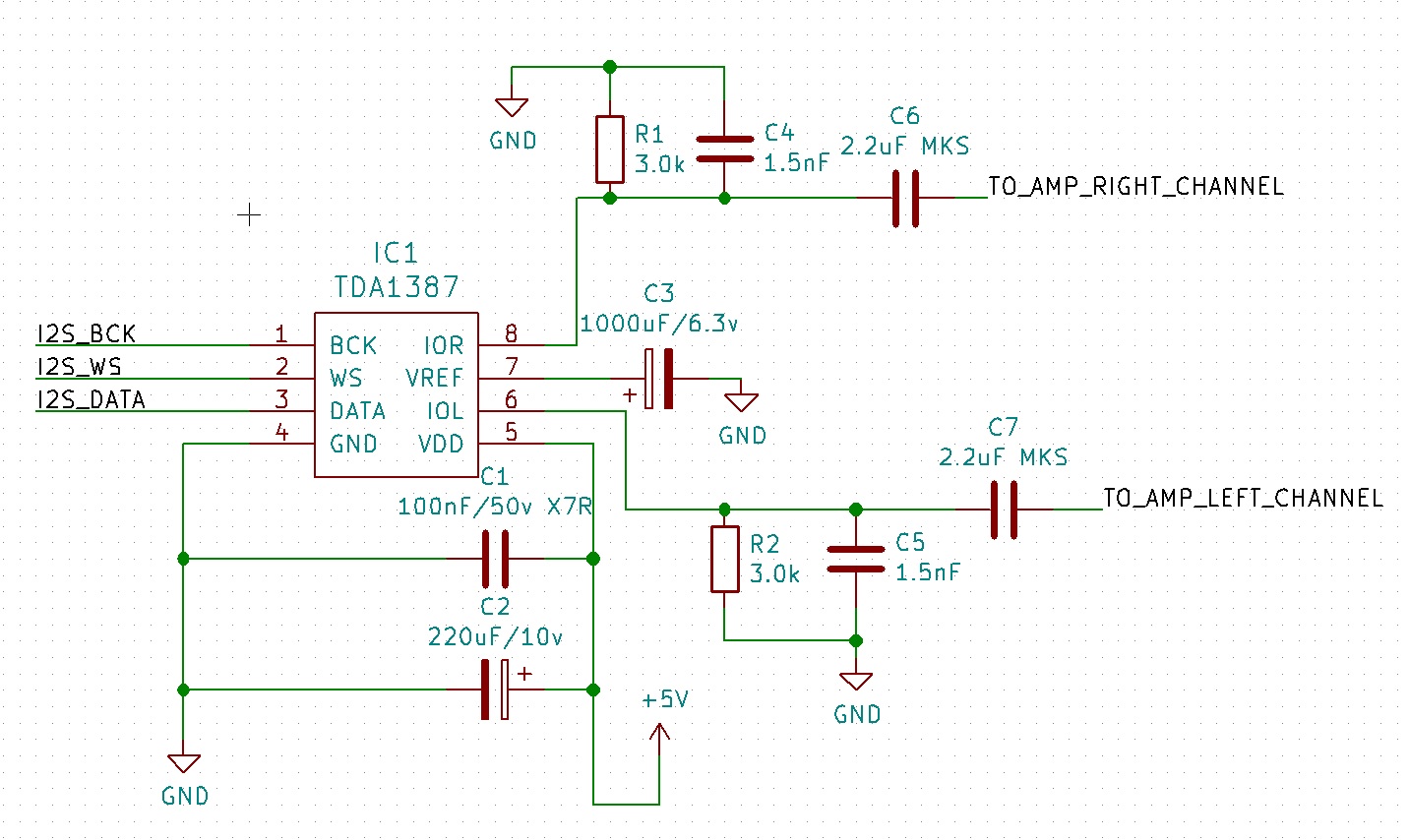

OK, one more option: the tda1387 chip itself is cheap, you should be able to source them for $1/each or less. A very basic implementation can be created on breadboard for very little money. Something like this:
  • 5v power supply (e.g. USB charger)
  • 220uF (or more) 10v PSU decoupling cap
  • 100nF 50v X7R (or C0G) PSU decoupling/high freq filter cap
  • Capacitor for pin7/VREF (1uF per datasheet, or 1000uF or more for better bass)
  • Two 2.2uF (or greater) output caps for DC-blocking (ideally film)
  • Two I/V resistors (in the range 2.7k to 3.5k)
  • Two 1.5nF film or ceramic caps as a basic high-frequency filter
If you have all or most of those parts on hand, you could whip up a basic tda1387 DAC with passive I/V in maybe an hour or two. If you have to order all the parts, it might be cheaper just to get the x4 USB DAC I mentioned above. But the idea is the same: it gives you a taste of the tda1387 with minimal cost-risk. (The DIY fun factor is off the charts for this option!)

Let the fun begin! I whipped up a quick schematic for you, see attached. I matched the components in the schematic to my original parts list:
  • 5v power supply (e.g. USB charger) - "+5V" on schematic.
  • 220uF (or more) 10v PSU decoupling cap - C2 on schematic.
  • 100nF 50v X7R (or C0G) PSU decoupling/high freq filter cap - C1 on schematic.
  • Capacitor for pin7/VREF (1uF per datasheet, or 1000uF or more for better bass) - C3 on schematic; I made it a polarized 1000uF/6.3v, but you can do pretty much anything here, datasheet minimum is 1uF ceramic.
  • Two 2.2uF (or greater) output caps for DC-blocking (ideally film) - C6, C7 - I indicated MKS, but whatever you have on hand is probably good enough for this test.
  • Two I/V resistors (in the range 2.7k to 3.5k) - R1, R2
  • Two 1.5nF film or ceramic caps as a basic high-frequency filter - C4, C5
Hopefully "TO_RIGHT_AMP_CHANNEL" and "TO_LEFT_AMP_CHANNEL" are self-explanatory.
On the left is the I2S input: BCK, WS, DATA. I assume you have some kind of device that outputs I2S (raspberry pi, Amanero, XMOS, etc).
Let me know if you have any questions!

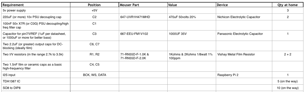

Well I gotta wait for the IC's to arrive from China, but at least I made a step forward. Now looking at my shelf I realised I might not have the exact parts and still lack some others. See below.
I will salvage more passives from an old DVD I have in the shelf, otherwise will have to buy some at ebay (Mouser for less than 50$ is too expensive)
Yeah, got a RPi2 around.
I think that's all for now. Just need to salvage more passives and get the ICs to my door.
