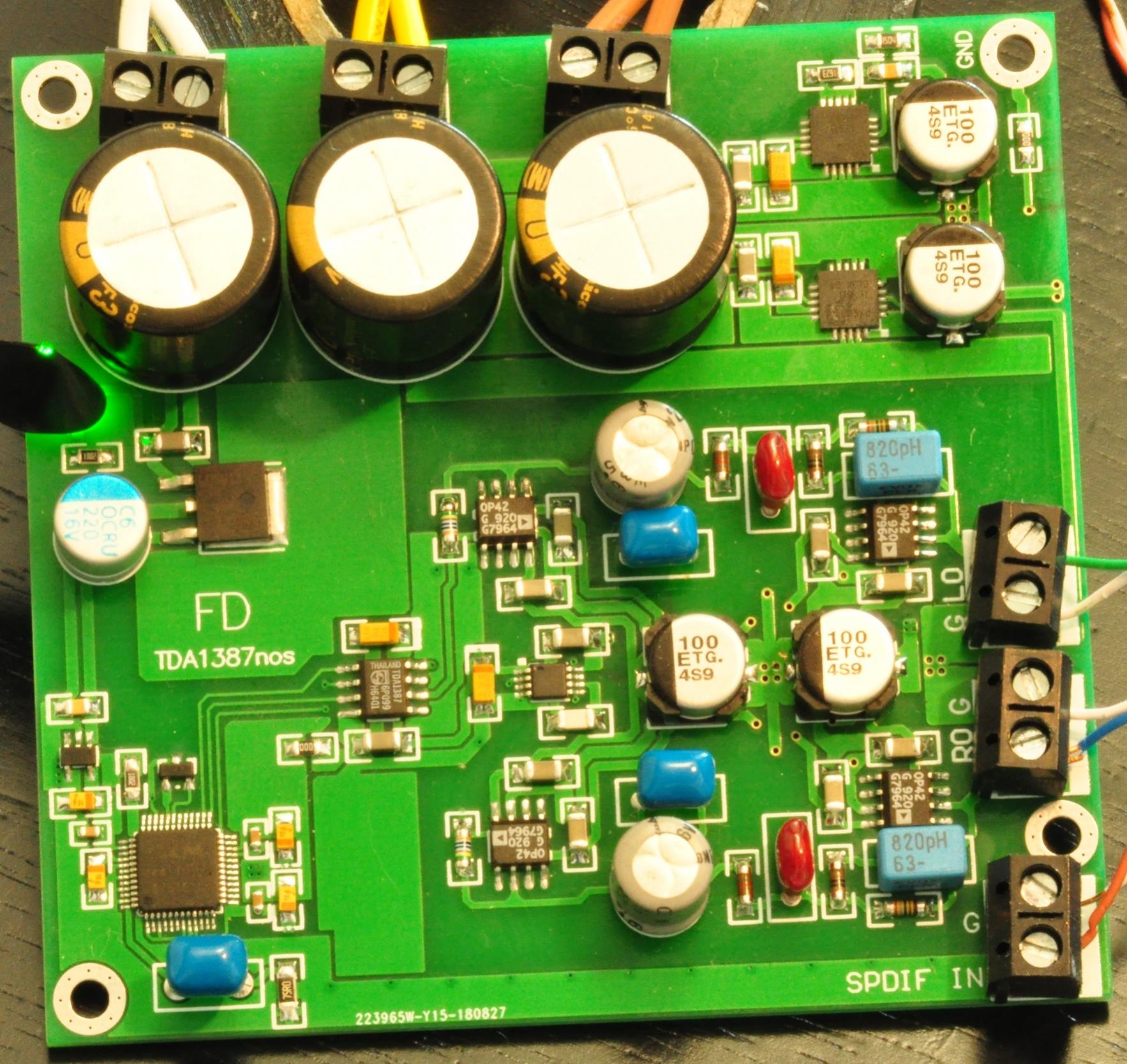

Here's a semi-decent detail picture of the board. About the best I can do without turning it off, which I'm not ready to do yet. :) But hopefully later today or tomorrow I'll give it a rest and then be able to get some more pics, including the back.

I will look forward to your direct I2S mod.
It won't really be a mod, just soldering wires directly to pins 1, 2 and 3 of the DAC IC. :)
looks pretty. does it have pins to add a potentiometer? i guess not, but would it be feasible to hack it?
No pins for a pot. But I don't see why you couldn't hang one off the output.

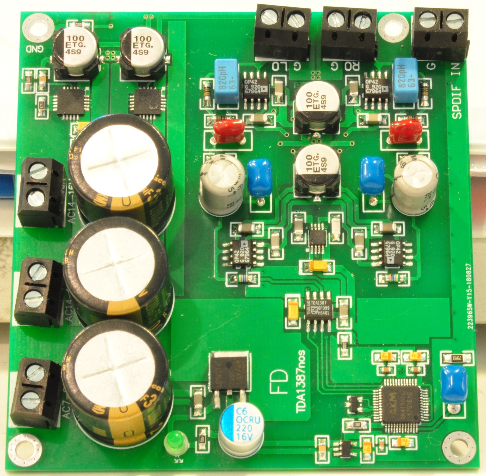

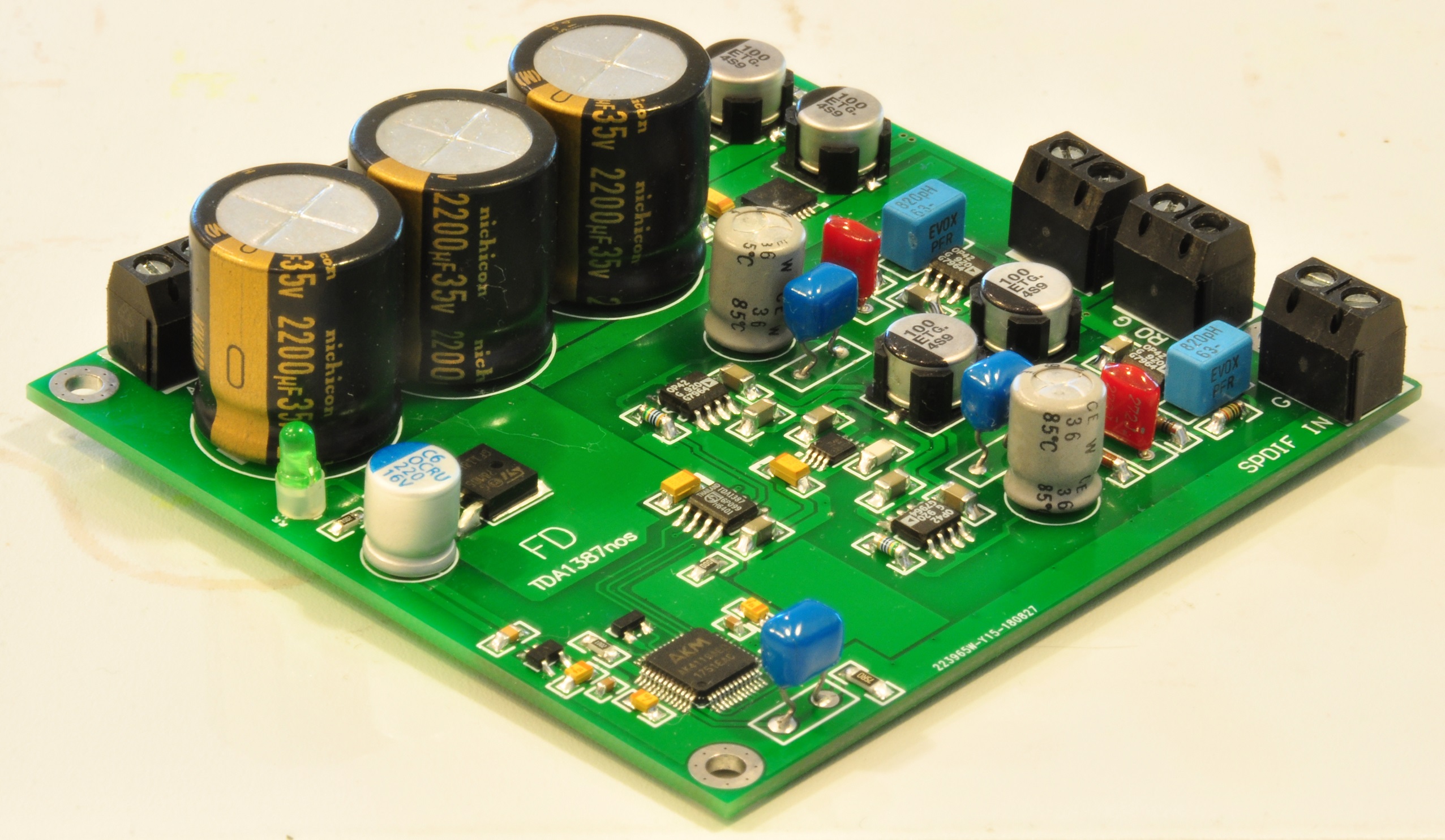

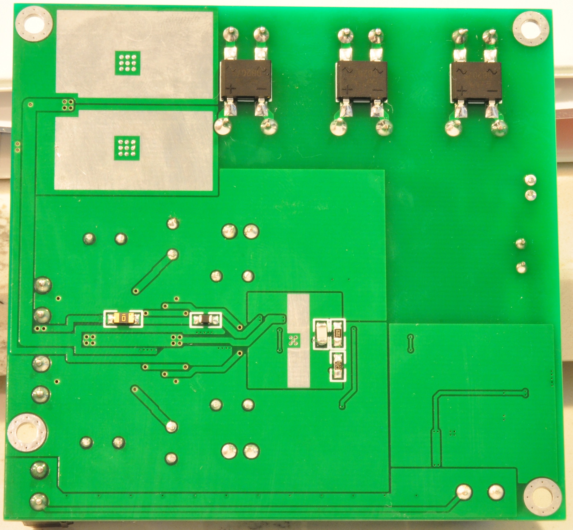

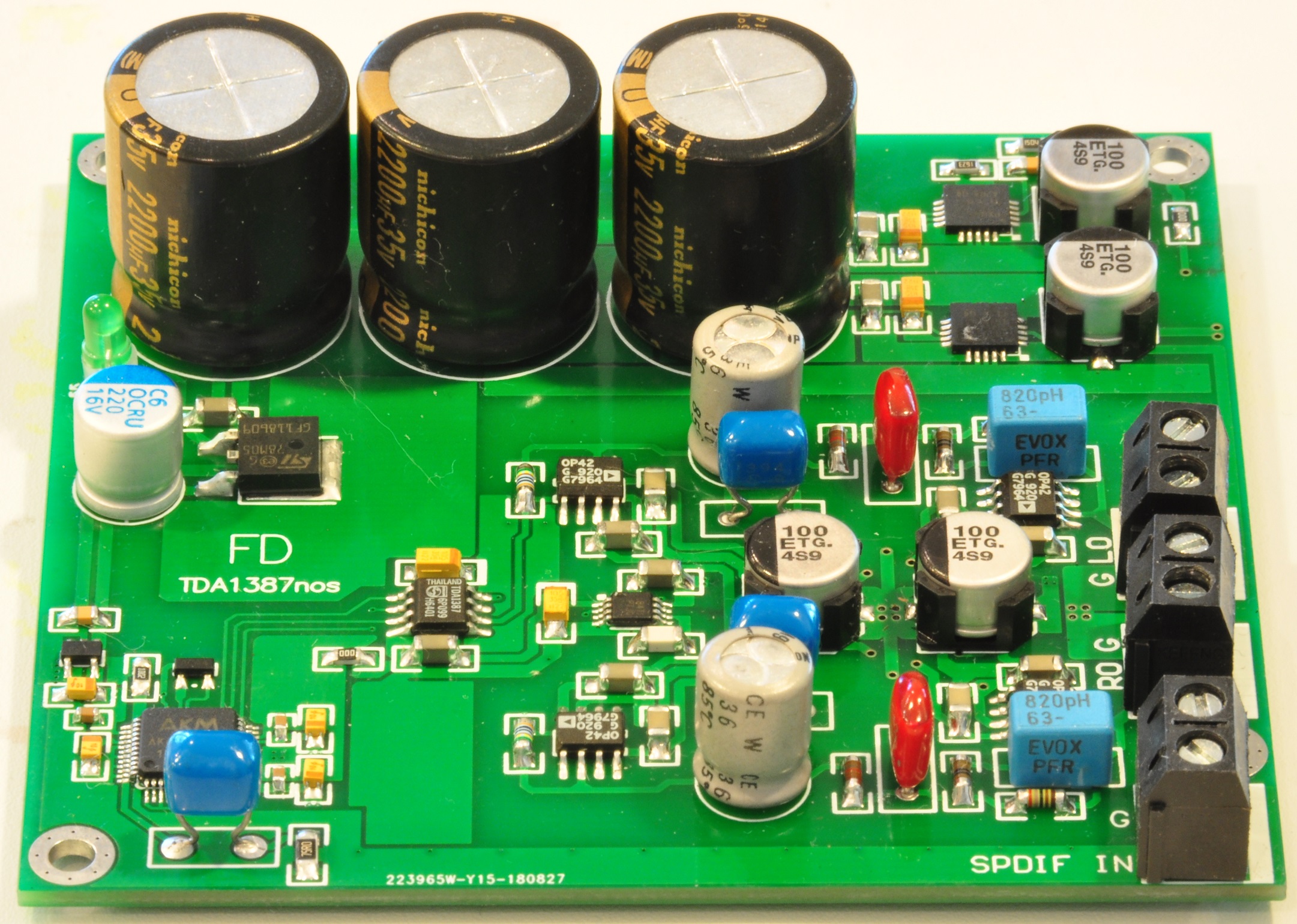

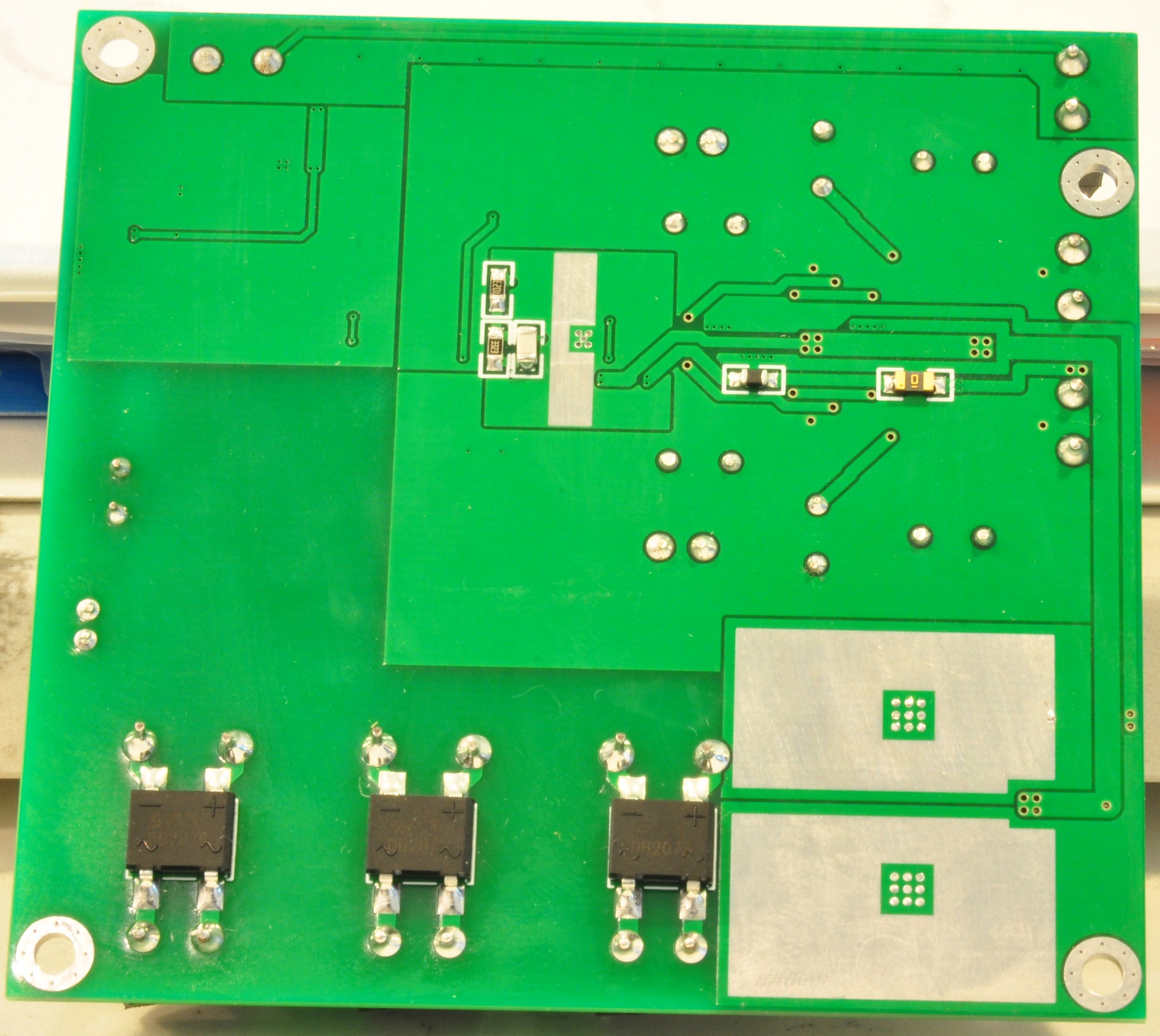

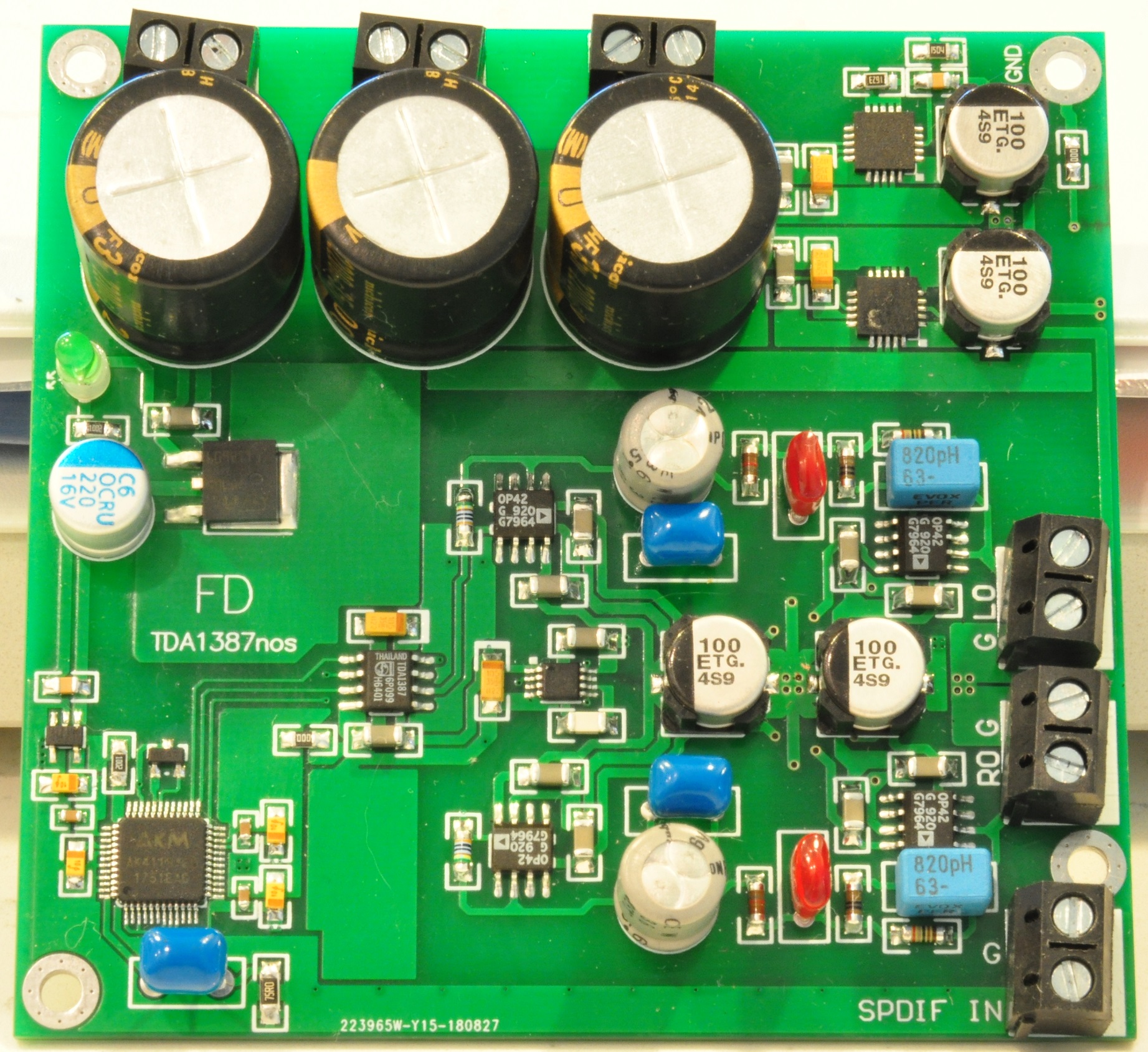

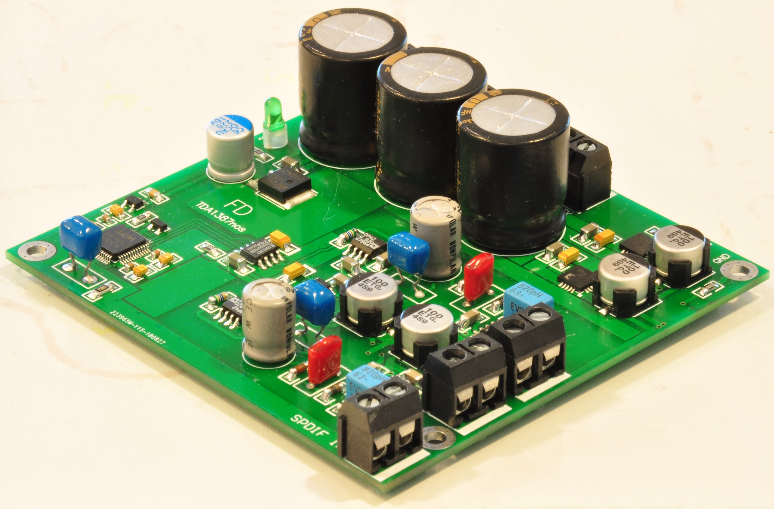

Attached are some better pics.

Certainly, hanging a pot off the output will definitely change the impedance characteristics. You may or may not be able to hear it though. I've seen lots of people do this (self included) on the amplifier end of things (quick and dirty way to turn a "power amp" into an "integrated amp").
Perhaps it's possible to hack the output buffer circuit for volume control?
You could of course also add a pre-amp with volume control to the chain.
Variable transformers are another option.
While I used to use pots between the DAC and amp input, these days I use digital volume control on the source. I know it's imperfect, but it's easy. :)

4. Here's another random ebay find: Philips Little Giant TDA1387 hum decoding (nos mode) (upgrade tda1541) (seller shenglongsi). I placed an order for one of these last night (came to just over $42 with ebay promo code "PREGAME15"). We'll see how it looks in person, but to my untrained eyes, it looks to be one of the most sophisticated tda1387 implementations I've seen outside of this forum. Going by the pics, it looks like it has a complete output stage (I/V, filtering, buffer), and also appears to use LDOs fancier than lm317. I thought it was worth a gamble if nothing else.
Nice find, Matt!
Since it's NOS, does the filter correct the sin c droop at 20kHz?
Do you have the output stage schematic?
Jeff
Joined 2008
I'm not sure. If I had to guess I'd say no, but that's just speculation.
I wish! I asked the ebay seller, he said he didn't have one. I'm going to try to see if I can back out the schematic from studying the board itself. But that will take some time.

Having said all that, my suggestion would be to start with the $50 tda1387 ebay board pictured above. It hasn't been fully vetted by the diyAudio community yet; I'm going on my initial impressions from minimal time with it. But those initial impressions were good, and most importantly (IMO) it's cheap! This limits your loss if it turns out the tda1387 isn't for you.
