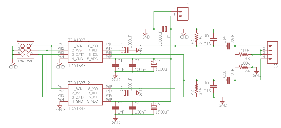

hello, does someone have schematics for a parallel TDA1387 with passive I/U ?
Not sure if this is what you're looking for, but see attached. This is a very simple, rudimentary tda1387-based DAC with passive I/V. There are two tda1387 chips in parallel. I have not tested this design! But I believe it is simple enough that it "should" work.

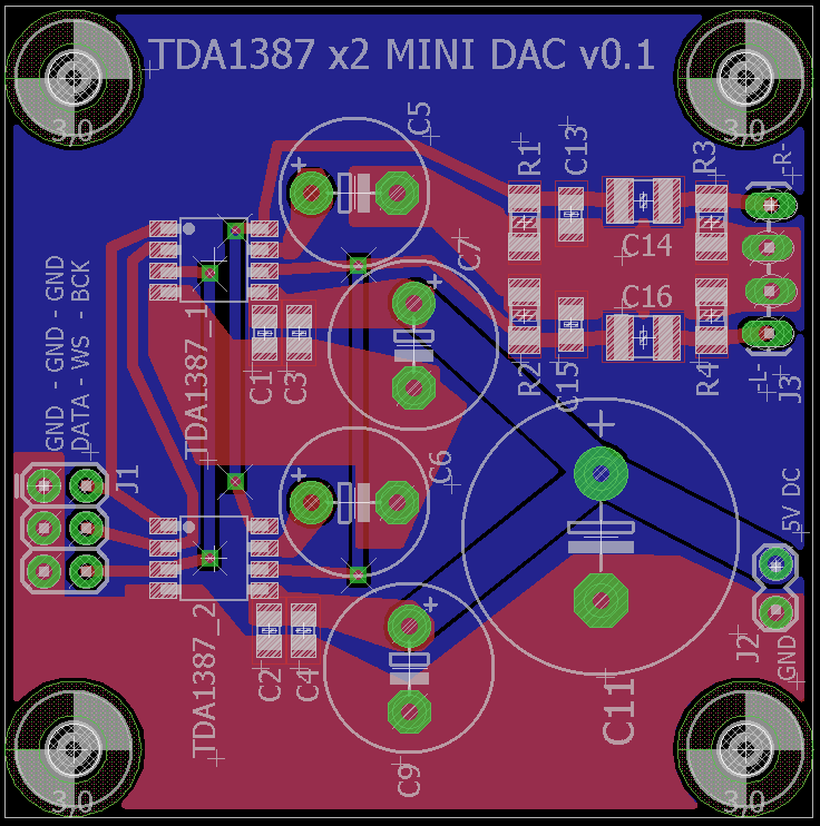

You're welcome! While I'm at it, here's a picture of the board for that circuit. I just submitted this to Elecrow for fabrication. So in 2-4 weeks I can tell you if it works or not. :)
It's not meant to be anything special, just a "warm up" for another project I'm working on. I'm having it fabbed mainly as a sanity check (and also because it's so cheap with Elecrow).
Looks like you're in the USA, so if you want a couple of these boards, let me know. When I get them, I'll give you a couple if you cover shipping.

Nice, how much voltage can it put out in RMS ?
I'm not sure offhand... I stole the passive I/V circuit values from one of the tda1387 threads here on diyAudio. I may have taken them out of context, too, so there's a chance these values aren't right! :eek:
R1 and R2 are the I/V resistors. So you'd have to back out the voltage based on the current the tda1387 chips put out at a given power supply level (5V is what I specified for this board).
My plan was to wait until I got the boards, then actually sit down and do the math to make sure all the I/V values make sense. But I'm not 100% sure how to do that offhand, so I need to track down some old threads and review first. Hence, why I'm putting it off. ;)
For a 5V supply the I/V resistors are a bit on the high side, given the DAC puts out 1mA maximum and the output compliance is 0 to 3.5V. It would be safer to fit 3k3. The output per phase then would be just a little over 1VRMS, taking two phases together would more or less match the CD standard of 2VRMS.

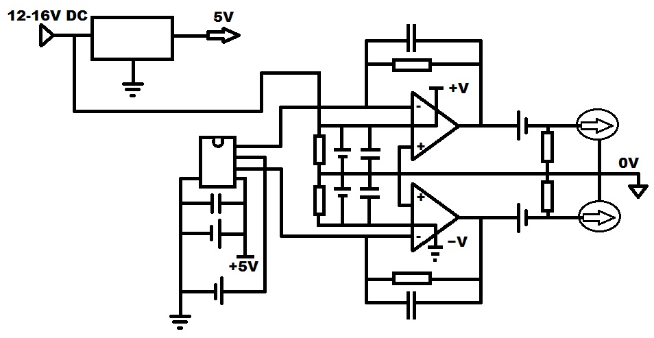

Hello folks, after finishing passive i/v for both tda1387 and a tda1543 DAC i wanted to try opamp approach (a good way to learn and ear differences).
First with some headphone amplifiers and then with DAC's. :)
I got a tda1543 working with this kind of schematic (a while ago) with Vref tied to the virtual ground through a resistor (variable for precise adjustment) but I can't get a functionnal tda1387 (Vref tied to ground or virtual ground through a capacitor) using the same topology. :confused:
I tried multiple variants (even one using transistors) to split the rails and the resuslts are all the same, the only way I was able to make it works is by using a dedicate power supply for the opamp section. :usd:
Sorry in advance if that sounds dumbs but what am I doing wrong or missing ? :eek:
Could this just be as simple as a ground issue (i did not tried with a refined star ground topology yet but i'm tired of experiments on bread board or protoboard that goes in smoke or just appear to be stone dead) ? :mad:
Could a lm317/lm337 rail splitter be able to fix this or I definitely need a separate power supply or a complete new design ? :(
Thanks in advance ;)
Simplified view of the design (hope this explain it all at first glance) :

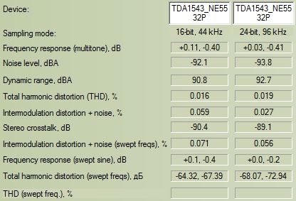

Results obtained with my single TDA1543 DAC using 2 NE5532P with their second half used as a buffer (why not ? :D).
For me it looks pretty decent for a first DAC/Opamp try :

Looking at your schematic I can't see a reason why the output RCAs should have 0V as their common, I reckon you'll be better off with the earth symbol connected to them.
Thanks, to be honest i just wanted to have the opamp i/v section and output separated from the rest of the circuit and though it would lower the noise present in the signal. ;)
And if i'm not wrong or remember correctly this is also the way it is done with cmoy types headphones amplifier but now i'm not really sure anymore... :eek:
So, can I share this part with the line where there is also return path for i2s shielding without concern for noise ?
In this case, should filtering ceramic caps present at OPA supply inputs be tied to real ground or only virtual ?
What's the best path in therm of noise reduction, or doesn't this matter at all as long as group all the return path of the parts (except OPA) at the same point ?

I had a bit of time today and finally make it work ;)
I tried a different approach to supply both the dac and the opamps though (by using two adj voltage regulator in series). Easiest way i had at hand to get two stable fixed voltages of 10V and 5V (using AMS1117) with a 16V supply.
Talk about shame, i spendt almost a week before to test differents topologies and values both on breadboard and protoboard only to find that some of the opamps used where dead from the start (forgot to bin them) :rolleyes:
