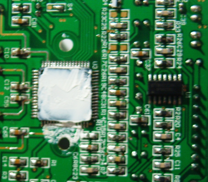

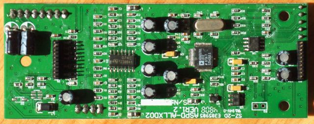

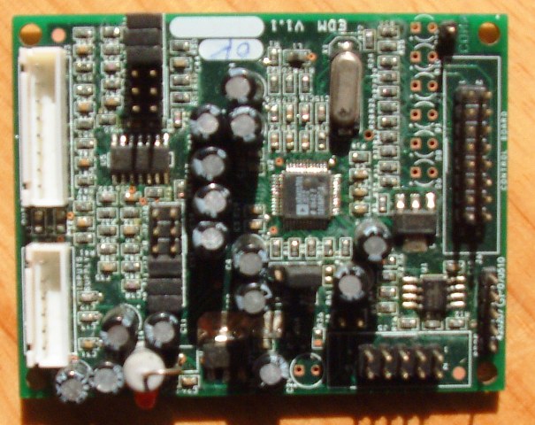

Yes we have DSP for active speaker,use ADAU1701,sound excellent,useually suit for active monitor or active speaker,it has 2 analog input and 4 analog output,EQ\NOISE GAT\DELAY etc.can be adjusted by software and download to EEPROM,it can selfboot when power up.use easily.
The chip datasheet,ADAU1701 | SigmaDSP® 28/56-Bit Audio Processor with Two ADCs and Four DACs | Audio Signal Processors | Audio/Video Products | Analog Devices.
we have board of it ,it have mass produce,any friends like it can order it .

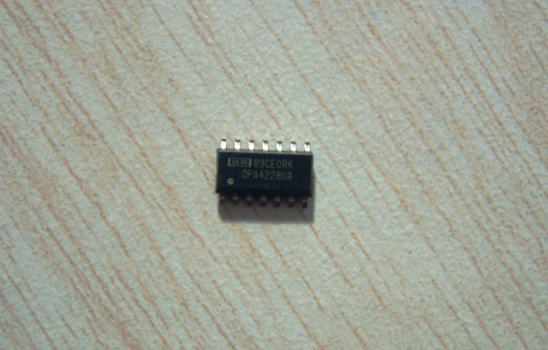

Which OP amp is the best partener with TAS5630?
I have test some op with TAS5630,finally found OPA4228UA very nice performance with it.
Dynamic range very high and Bass excellent,sound very very good in swith amplifier(include class D/class T/class I/class TD)
Suggest guys try it and use it when you use TAS series chip for AMP,
datasheet :Precision Amplifier - Low Offset Voltage - OPA4228 - TI.com
Price high,but sound excellent indeed!!!
Better Than OPA1632.

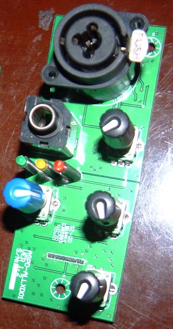

What type of volume pot is used?
Ok!TAS5630 more pwerful than TAS5613,but TAS5613 more clear,
input impedance 1MOHM ,you can replace it with signal transformer.
OP power supply is +/-15v
100kA pot can select

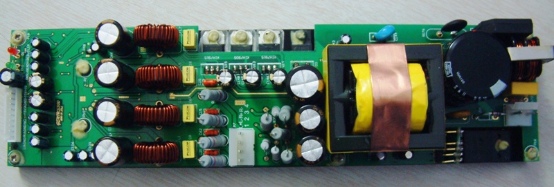

I think you have order TAS5613 from us,how does it feel?
Yep, that's me. Just got it a few hours ago.
Initially, there was some frightening buzz noise, but now seems to be gone, strange. Anyways, so I open box to check if anything is loose and measure some voltages. I got below:
7815 input: 16.35v out: 14.6v
7805 input: 21v out: 4.94v
7915 input: -20v out: -14.75v
Ground to speaker out: 15.7v
other voltages I found is 29.7v and 12.78V
(note my meter is not very accurate)
But clearly the 7815 voltage input is too low to maintain 15v regulation. When I measure while playing music, the voltage jumps between 14.5~14.6v while the 7915 output is stable. Is there anyway to fix this?
For the sound, too early to say, so far not too bad and does sound musical. But compare to my highly modded 2022 t-amp, the music sound less organic and mid lack a bit of body, it also has less bass too. But the details in the high seems a bit better and complex music seems to be a bit better resolve and have more control.
So for classical music, it is a bit better than the t-amp.
I know think this amp can stay virgin overnight at my home. I will certainly replace the Alps pot as I think this amp deserves a much better pot.
I think the 7815 voltage is bad for the sound and needs to fix! And probably is part of the reason for lower bass as not enough current can be sourced.

Oh!Chuckt,I think no noise like Buzz in our amp,maybe the input signal have bad GND,please check it yourself .if meet problems we will replace it.
I think 7815 output should ok,you can try it and replce it for other type,we use ST 7815 from Morocco.
The buzzing is now completely gone. It only happen when I 1st start up. Maybe the smps needs some time to stabilize?
Was I talking to u at taobao?
I will change the R201 resistor from 51R to 33R to fix the 7815 voltage problem. I think this amp has lots of potential and might be a good replacement for the t-amp. Esp for the price.
