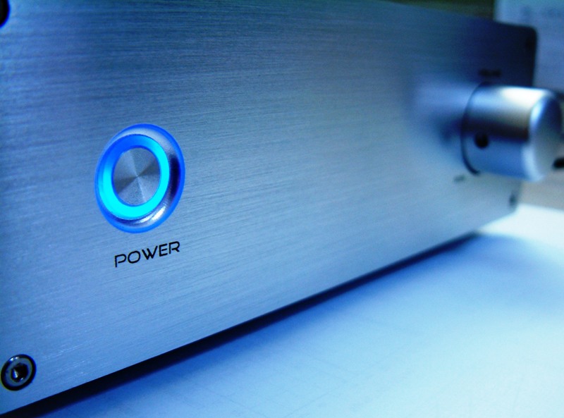

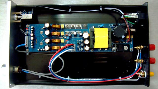

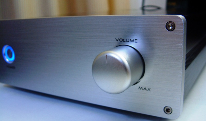

Tas5630+SMPS module wear the new coat in new year!
I put new aluminum case on TAS5630+SMPS module few days ago,looks good,New Year coming!I think this treasured object should wear new coat in new year.
