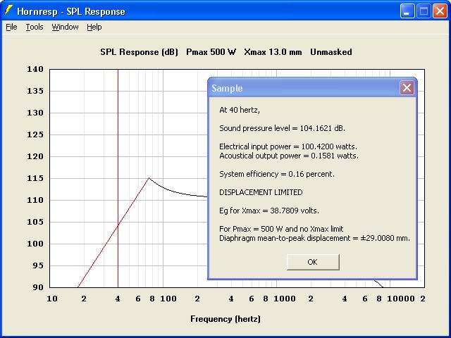

  • Without a doubt, the biggest danger in a tapped horn is overexcursion. In my measurements, I found that the gain of the tapped horn "drops off a cliff" below the tuning frequency. Below this point, the woofer is *very* exposed to detonation. So if you want very deep bass with a tapped horn, you should consider using a pathlength that will get you down to 25hz, or even lower. The Triple8 is tuned to about 30hz IIRC.

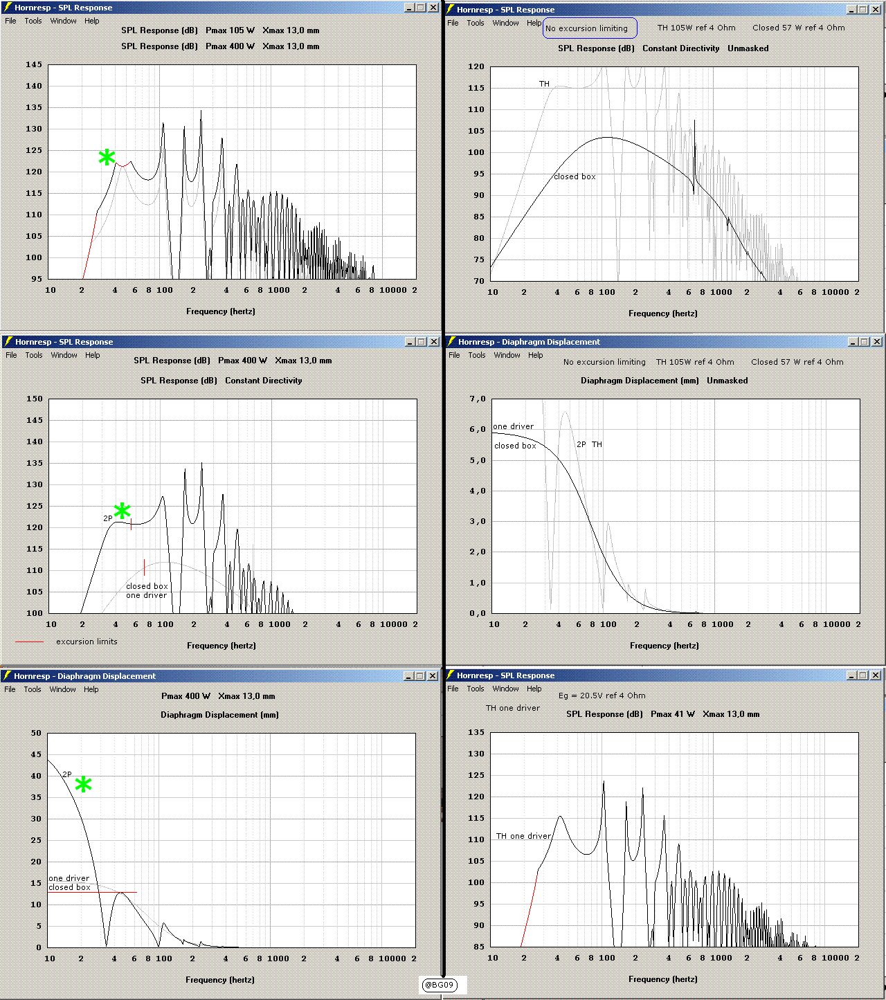

One of the things that's frustrating about debating box alignments is that people assume that simulations are accurate. And I've found time and time again that simulations will only get you "in the ballpark."
And I've been guilty of this myself - I dismissed tapped horns a couple years ago, because my initial results were poor. What I didn't realize at the time was that there are some simple tricks that can be used to bump up your output.
  • When you build a horn, measure the impedance curve. You'll be surprised by what you see - a big bump in impedance. This bump in impedance allows you to use woofers with reaaaaaaaaaly low impedance. For instance, my Triple8 would dip down to 1.2 ohms if it was sealed. Yet my impedance is THREE ohms in a tapped horn. (Low passed at 80hz btw)
    The difference between 1.2ohms and 3ohms doesn't seem like a lot, but that's HUGE. That change in impedance lowers the power consumption by over FIFTY percent. Just a crazy improvement.
    I wonder if a lot of people build horns without considering the change in impedance? Because doing that really robs your SPL potential. Obviously a 1.2ohm load would blow up most amps, but a 3ohm load is quite manageable.
  • The other "trick" is to use a MASSIVE flare. When you look at the sims, a big flare doesn't make a huge difference. But in the "real world", the boxes I've built with a substantial flare sound a lot more dynamic, and just plain louder.
I wish I had some measurements or experiments to illustrate the second point. It was one of those things where the improvement was instantly noticeable, and I just stopped doing things "the old way." (IE, I will never build another loudspeaker that doesn't use a substantially flared port.)

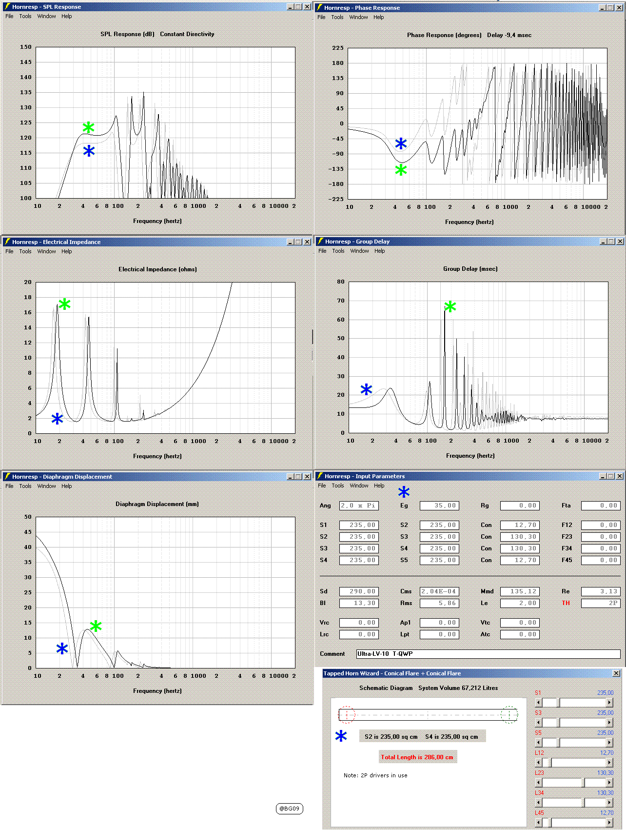

After building a few tapped horns, I've noticed that more "extreme" designs are less forgiving.
For instance, here is the measured and the predicted impedance curve of a prosound twelve in a four cubic foot tapped horn. Hornresp predicted a strong resonance at 48 and 110hz. In the measured results we see a strong resonance at 100hz and a slightly deficient resonance at 48hz.
Above is a pic of a tapped horn with three eights, and it's measured impedance. (The purple trace.)
The impedance curve is screwed up. There should be a strong resonance at 35 and 85hz, but there's only one resonance. This "tapped horn" is behaving like a bandpass box. Sorta.
Here's the exact same subwoofer, but I took it apart, and went CRAZY sealing gaps. I literally went up and down the seams with a flashlight, and found about a dozen pinholes. And then I dumped half a tube of liquid nails into all the seams, to insure they're airtight.
Now the resonance is deeper, and more pronounced. But it still doesn't match the prediction.
On the upside, tapped horns seems to be a lot more forgiving of mistuning. For instance, if you mistune a bandpass box, it could create a six dB peak, or it could drop your efficiency by ten dB. When a bandpass box goes wrong, it seems to wrong in a spectacular way.
One the downside, I'm starting to believe that ultra-small tapped horns are VERY unforgiving. For instance, the build quality on my 40hz tapped horn is shoddy at best, and it works just like the prediction. But my 23hz tapped horn, which is half the size, is anything but forgiving.

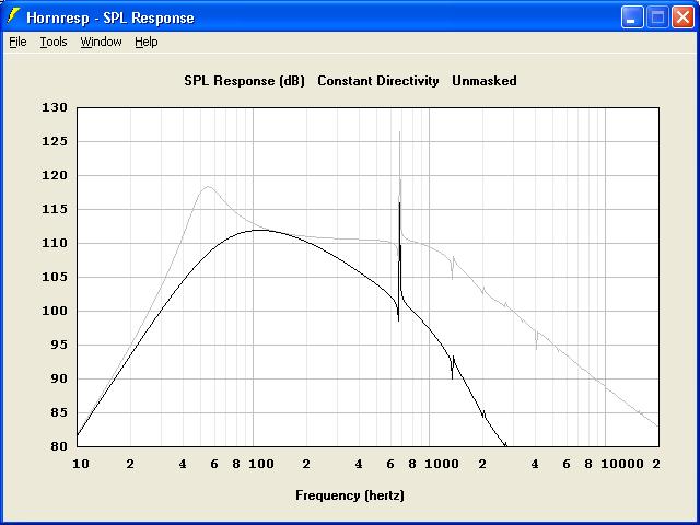

With a couple more years of building under my belt, I threw together this post to describe what I think one should expect when they sim speakers:
Audio Psychosis • View topic - How to Make You Speakers Sound Better (for Free)
In a nutshell -
  • IMHO, WinISD should only be used if you're building a sealed box
  • If you're doing anything more complex, Hornresp is the easiest program that will give you accurate results.
  • There are so many variables in all other box designs, that using software that ignores these variables is a recipe for disaster. For instance, simply moving the port on the loudspeaker from the front of the box to the back of the box will alter the frequency response.
  • Narrow 'blips' in the predicted response will likely be absent or reduced in the real world
  • Broad peaks and dips in the response are what we need to look out for
Sometimes it can be helpful to use an iterative process. For instance, when doing 3D design I will sometimes start with a design in 2D, get it correct, then export it to a 3D package. The simpler 2D interface makes it possible to 'rough out' and idea before I do the heavy lifting with a more complex program. It's the same way with speakers. It's fun to 'knock out' a simple design in WinISD or the like, but I always fire up hornresp or Akabak before I get ready to make sawdust.
The latter two programs are time consuming, but not as time consuming as a failed or poorly engineered project.

Another thing that I've noticed in my measurements is that a sealed box mounted in the trunk of a car sees an increase in the impedance curve. My hunch is that the air in the trunk "presses" against the cone, raising impedance and lowering excursion.
Impedance should go down as excursion is reduced. Perhaps you meant the Fb is reduced?
