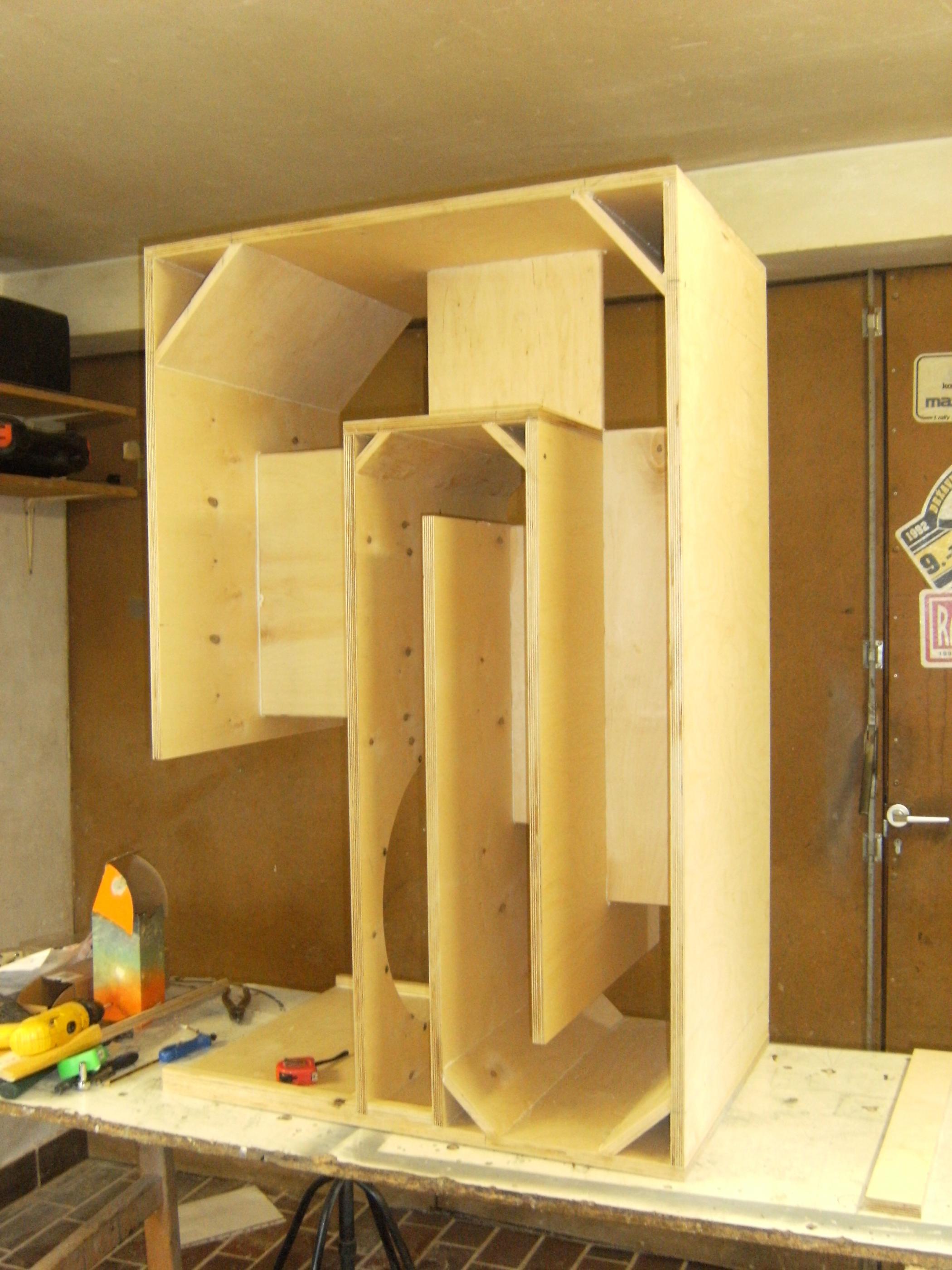

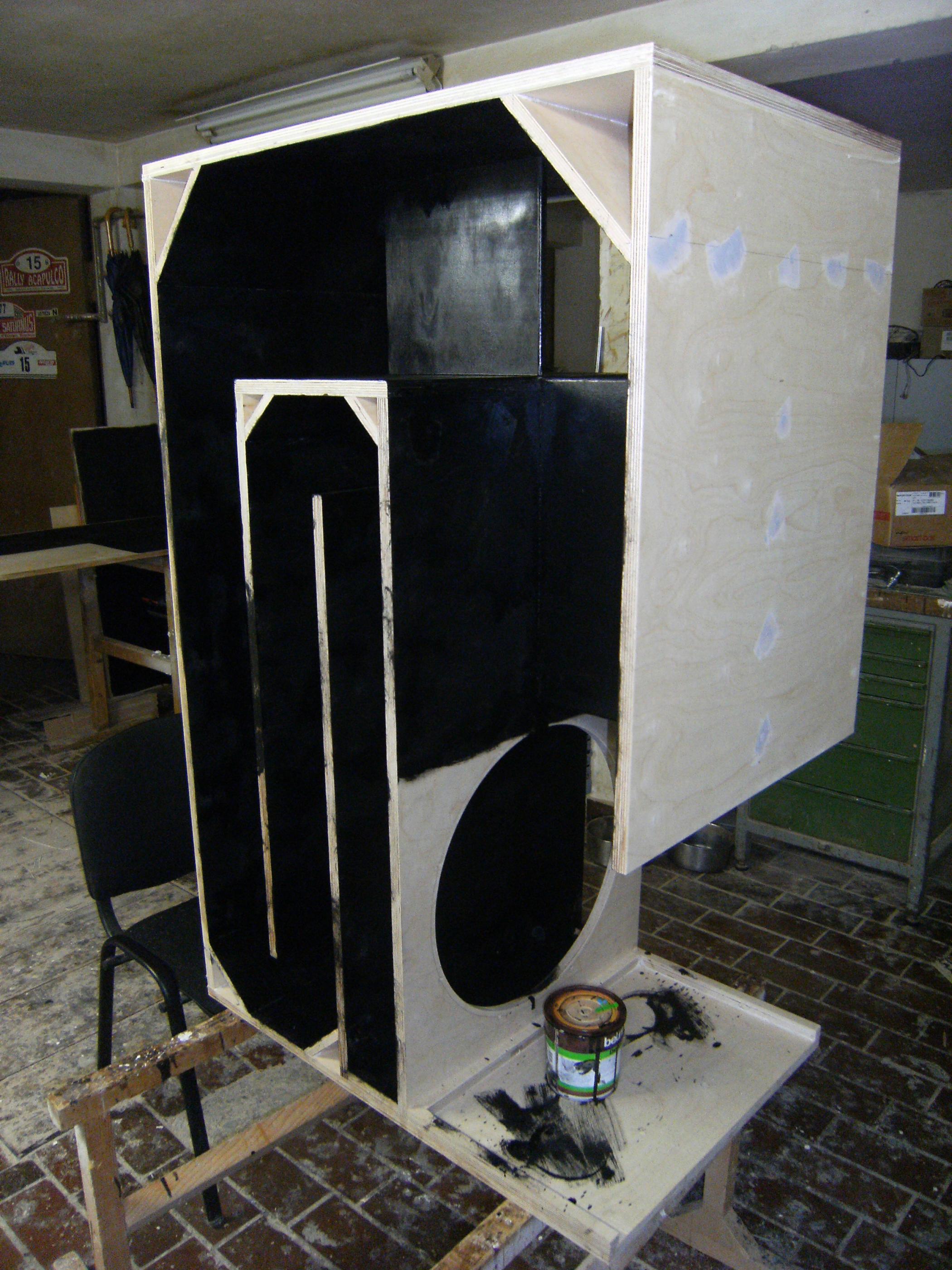

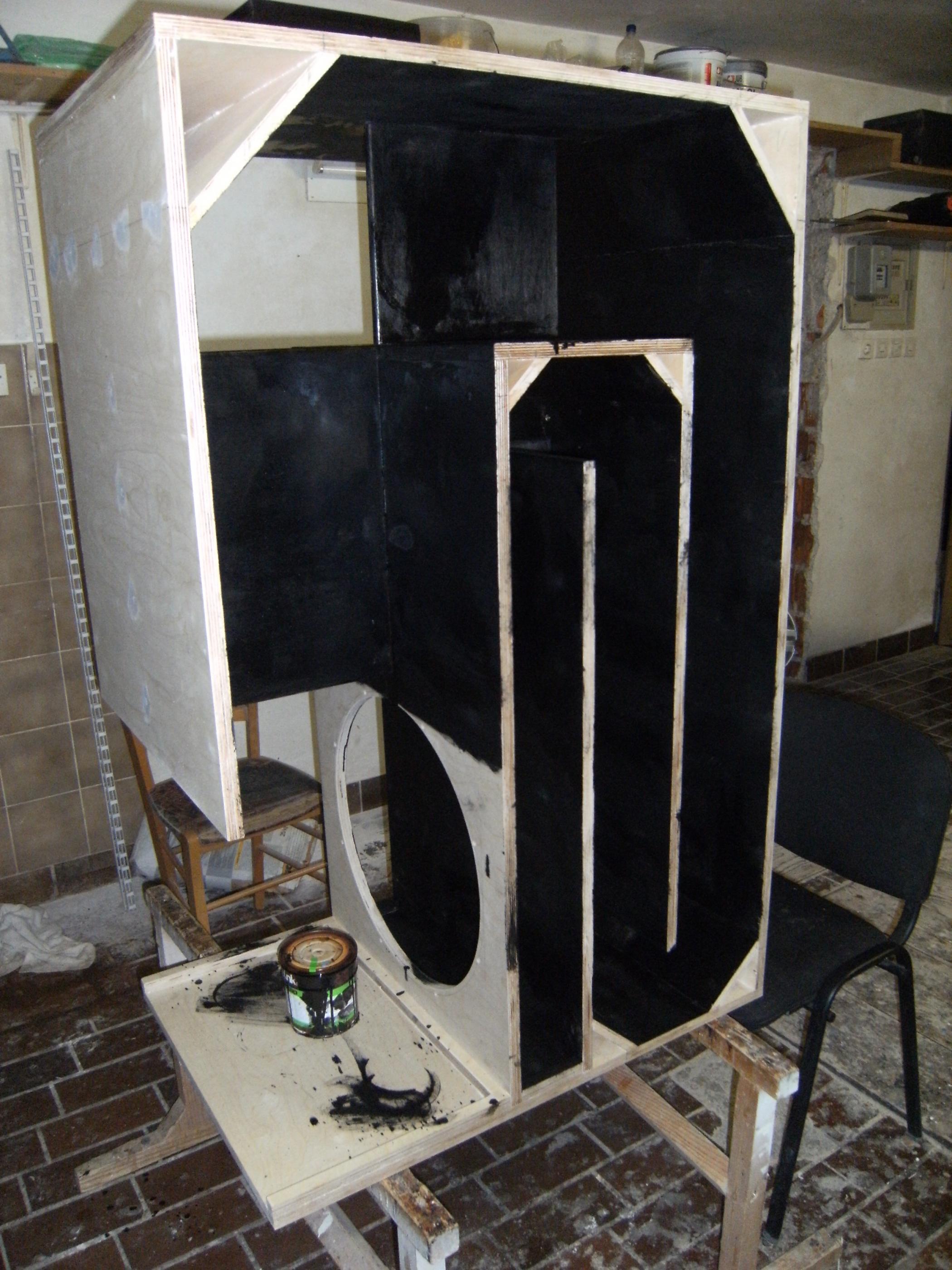

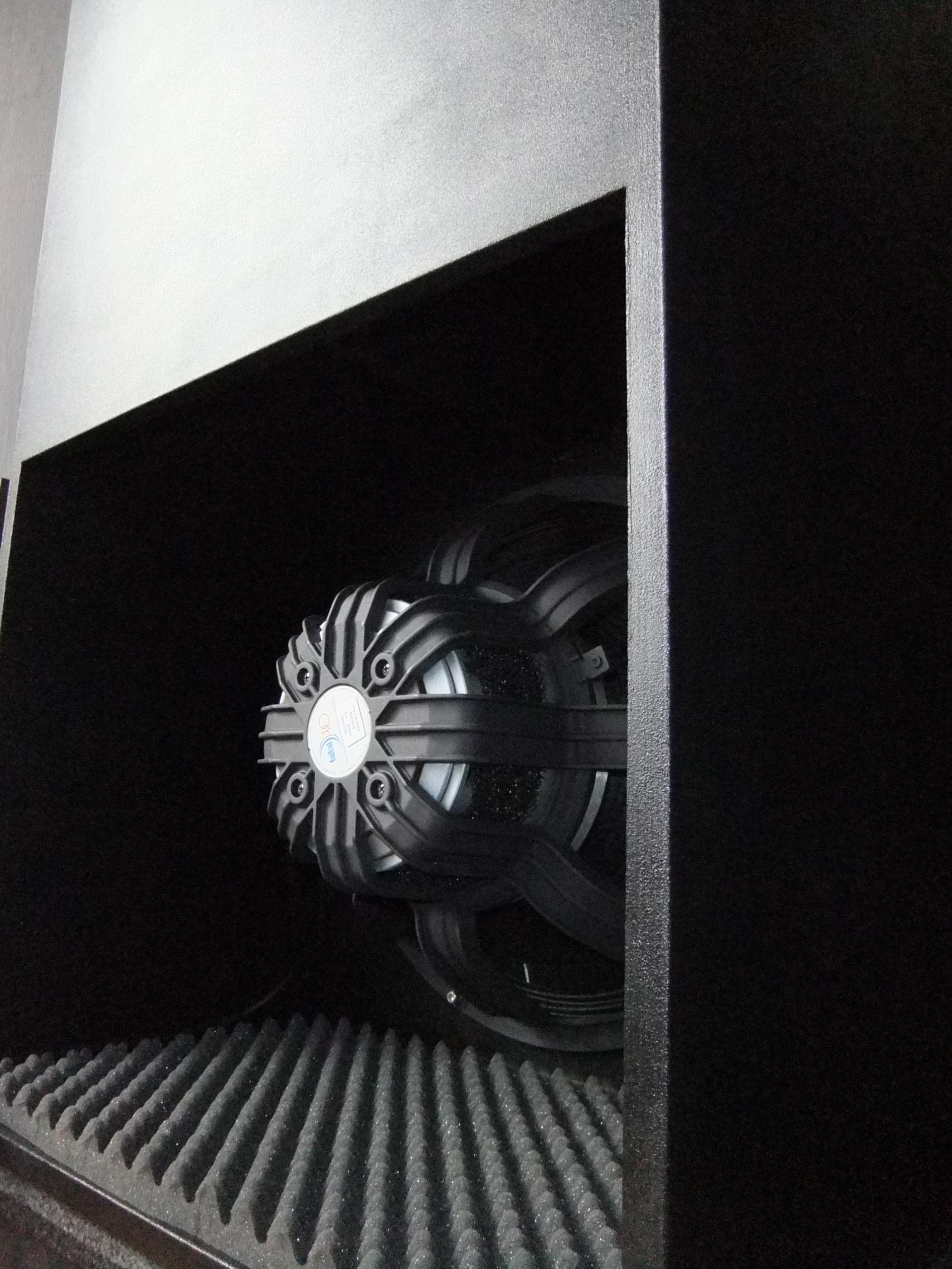

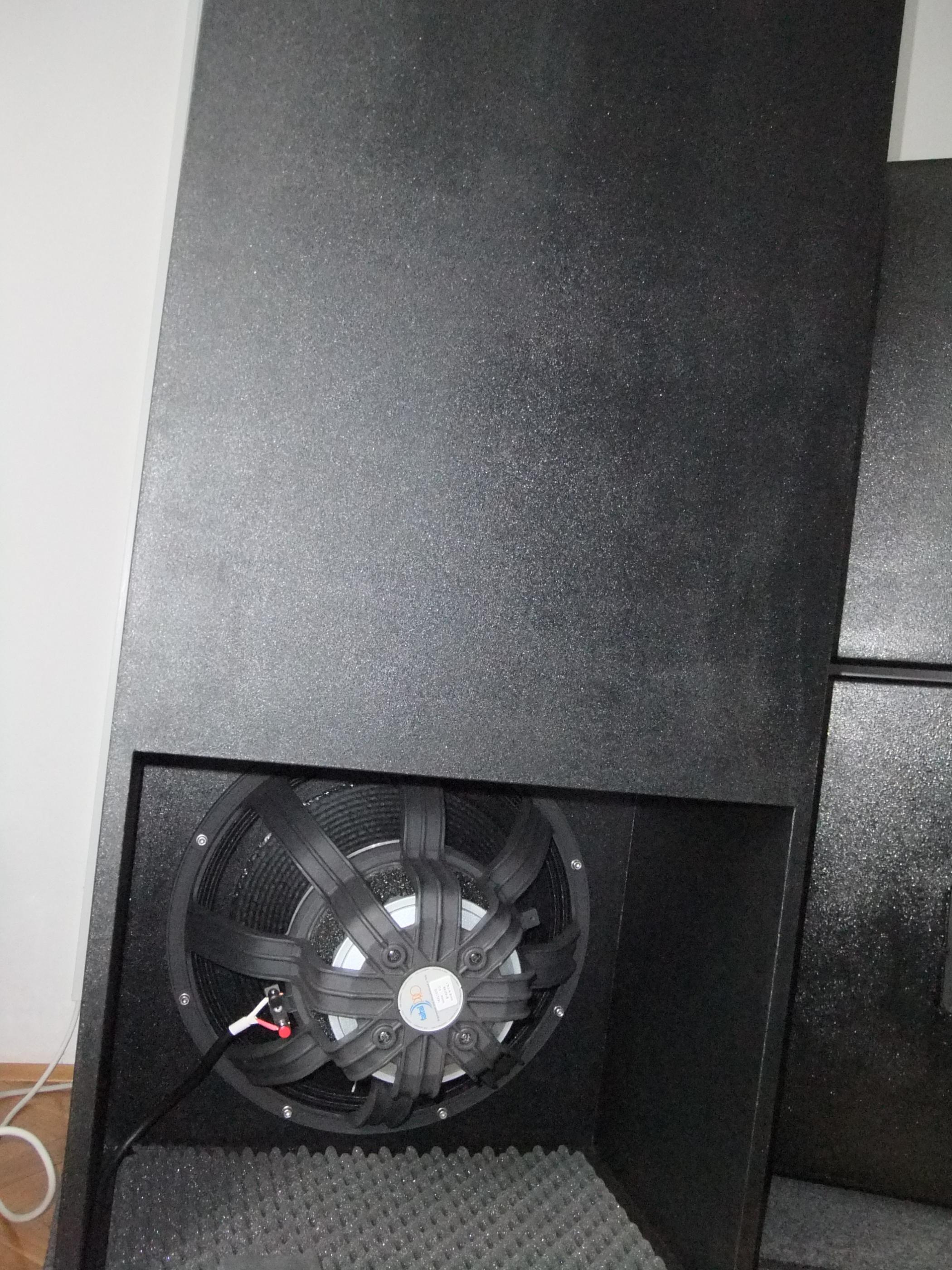

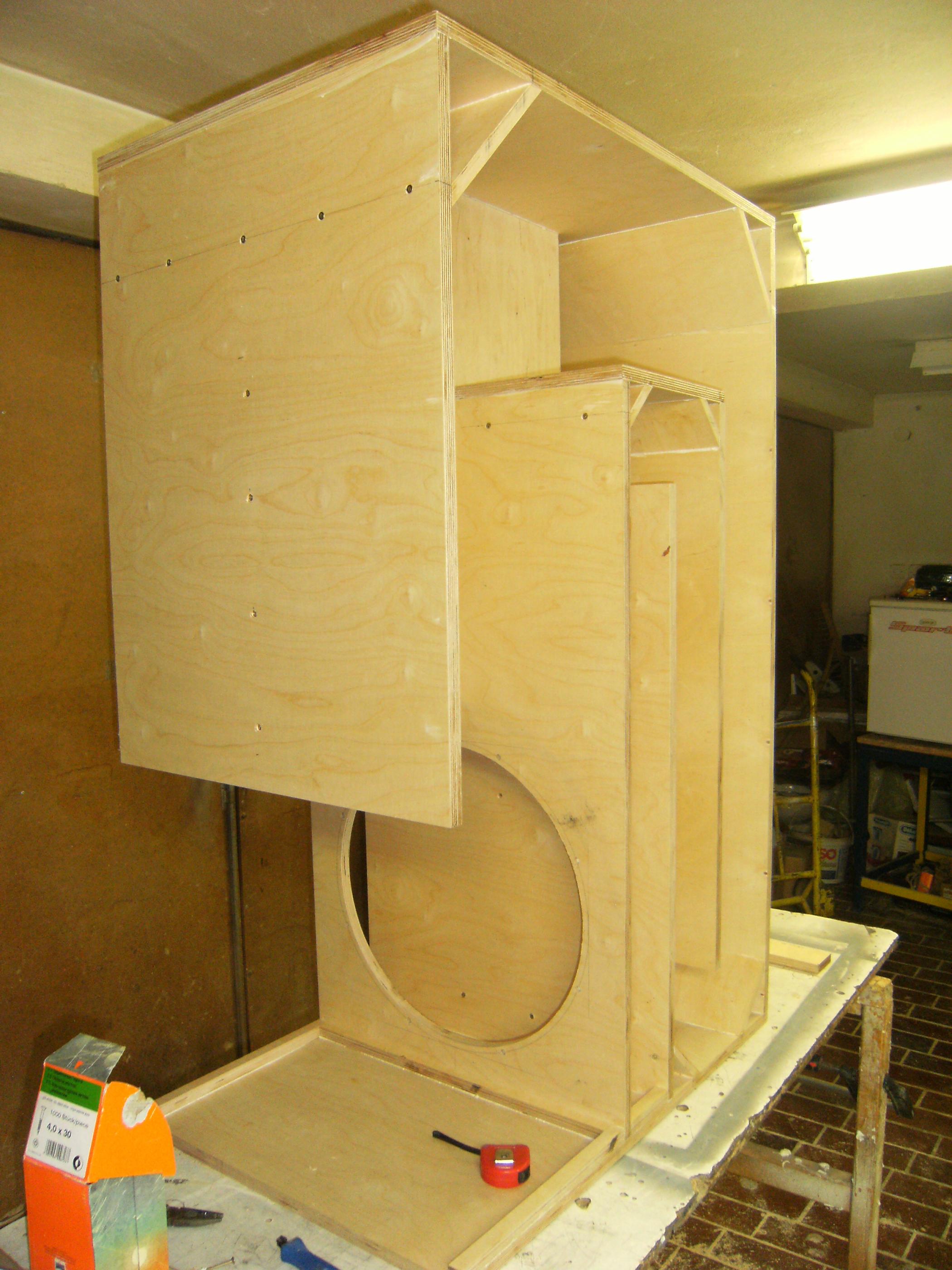

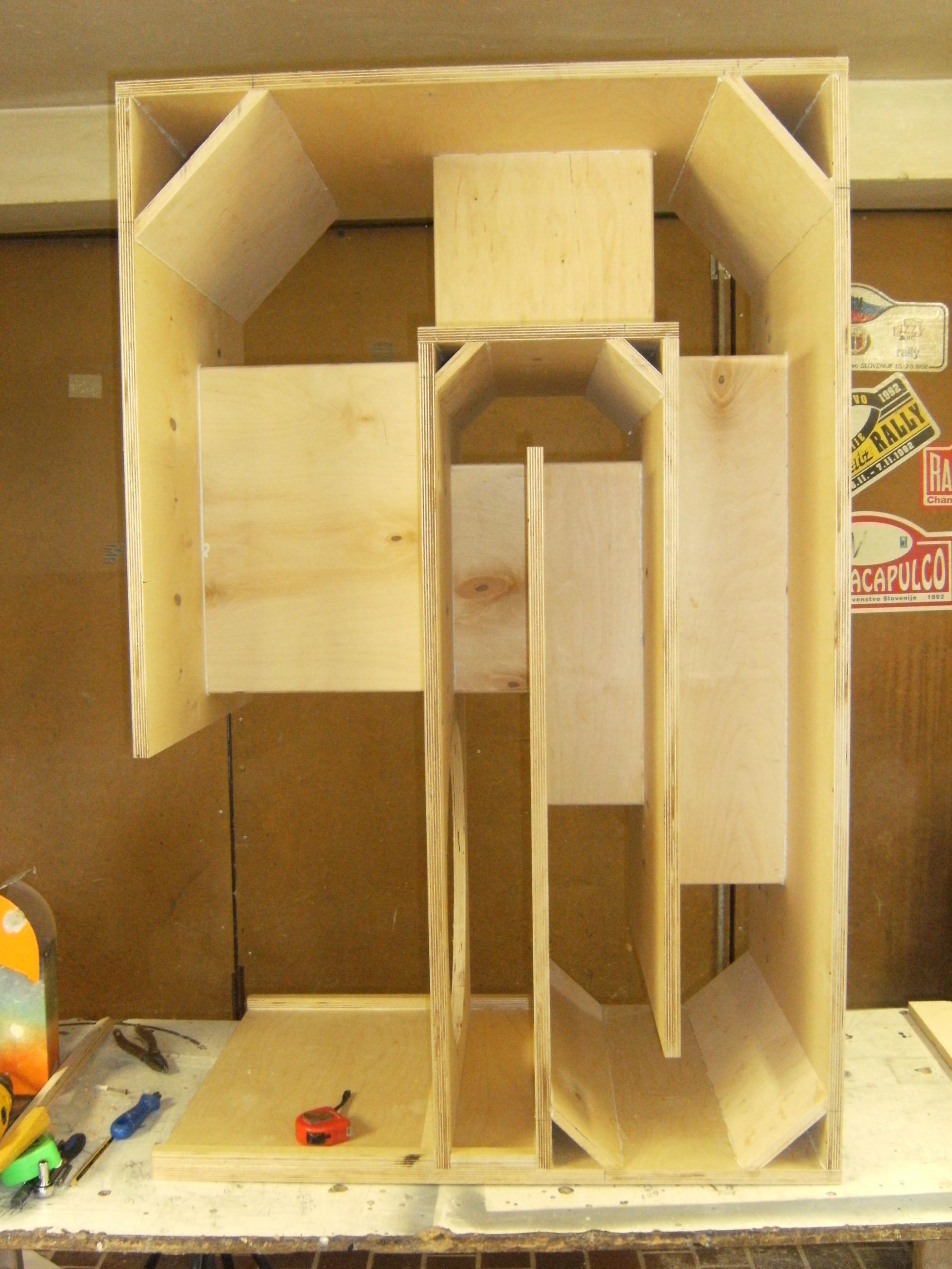

Tapped Horn TH-121 build
Assembley of the second one :)

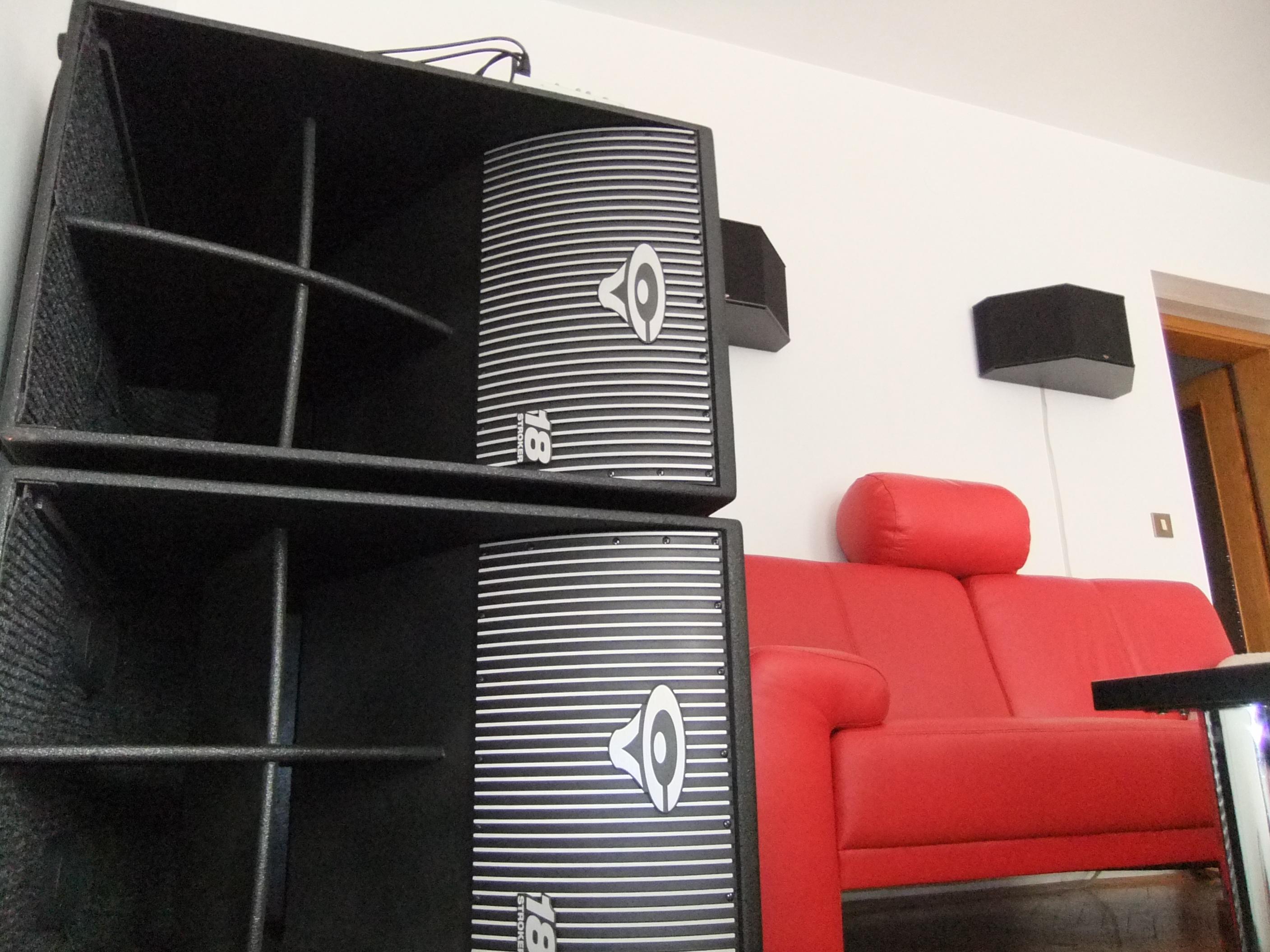

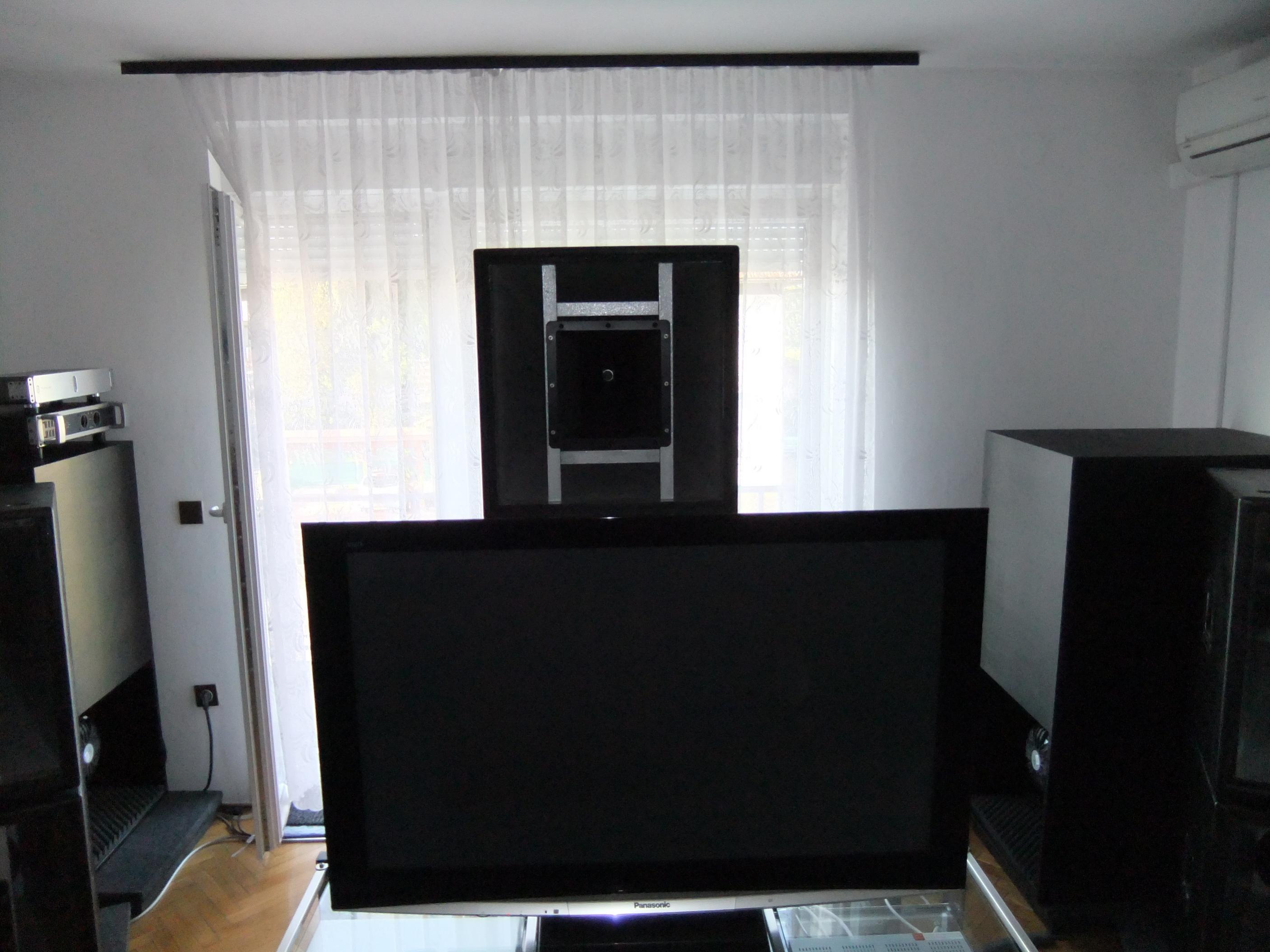

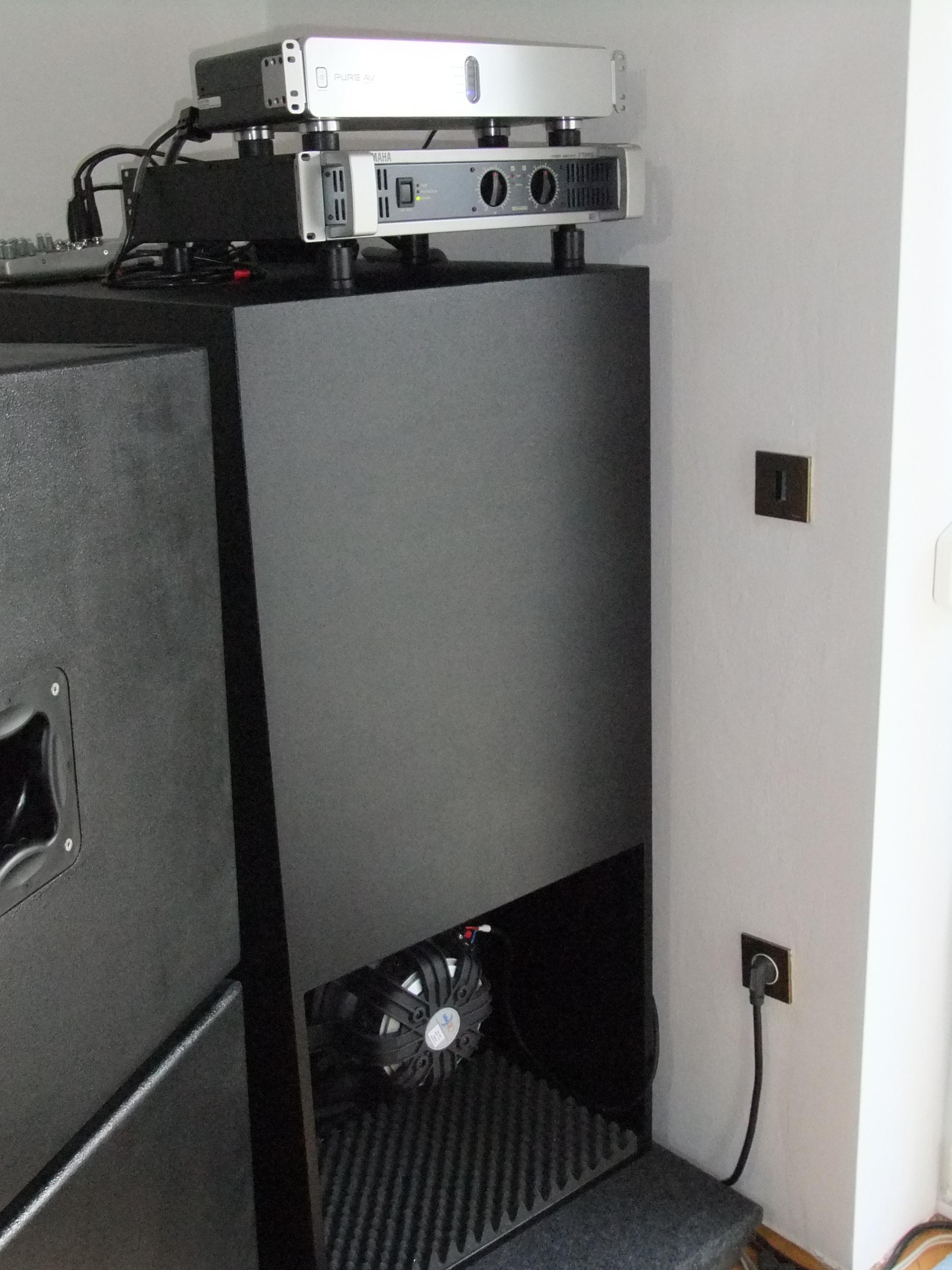

Wow! Zivko, are you really using 5 of those 150l horns for your front 3 channels in that small room? You are admirably crazy! Can't imagine you ever turn the volume knob up very far.
Hi jwmbro,
yes knob goes not up very far, high sensitivity, less power, more SPL and energy saving, I can see up to 1-2W at LP which is 4m away, room is not so small 5,5m x 5,5m x 2,7m but speakers are big, I have two more FLH in right back corner :)
