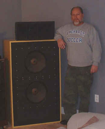

We'll have to agree to disagree that it's a TH beyond that it's an acoustically efficient way to lay out a 6th order BP, so from this POV it should perform well. :D
This is a truism and why I upgraded to a stereo pair 40+ years ago at the first opportunity, only changing their tuning as required to blend well with whatever room they were in:
GM
Greets!
You're a horn designer, so I'm surprised you would consider it one since the horn's way too small/short to be other than a low Q expanding vent. Regardless, thanks for sharing, it's a neat project, though I suppose it should be in the car audio forum. ;)
Yeah, had eight with four in a pair of ~70-500 Hz compression horns, but life 'happens' and right now all I have are my old subs that started life in '69 with a couple of old Altec horns perched on top. Anything but optimized, but still pretty impressive in a '50s high end HIFI sort of way.
No, I don't and it's one of those long, sad soap opera scripts as to why, though I did cobble together a 'bargain basement' Unity concept many years ago using a pair of RS 4" 'FR' drivers and a piezo horn that worked well enough to make me a believer of both it and the TH variant that followed even though it couldn't do the most important part, be completely time/phase aligned. If I ever get to make another big rig for myself it will be a Unity concept one assuming something better doesn't come along in the meantime.
Agreed, most of the DIY THs are simple driver-in-mouth pipe horns which perform virtually identically in the LF BW to the offset driver Voigt style pipe horns I've done, so very familiar with their performance benefits, though until MJK's, DB's and a few other DIYers recent keen interest in TLs, etc. due to their software efforts and especially DSL's products, their virtues have been pretty much limited to the 'FR' forum crowd.
