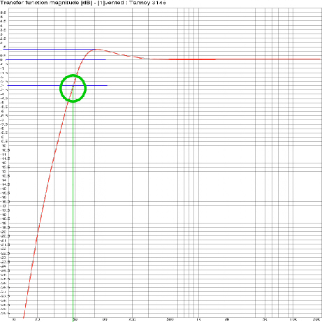

ok, so I've done a little work.
the spec quoted on the Tannoy page is
(BL)^2/Re=22
Re=5.8 Ohms, so that implies:---> BL= 11.296
Vas=9,54 ft^3,
Fs=32 Hz
I also input the Qts=0.4
I got a pretty nice "response" from Win ISD, Basically what I would consider good. 3.5 ft^3..4"diametre port, 4.5" long
-3db@47 Hz , +1.5dB@60Hz
I could easily live with this.

OK, now.... tell me how big the port needs to be for a 3 ft^3 box.:)
edit: I only ask this because I used the same set of number you did. Guess what.... The box you quoted won't work in real life, I guarantee it. This, at least with the drivers I have.
Changing the BL from 22 to 11.5 does little to the modeling. Have you tried it both ways? No difference in predicted response that I can see.
seems easy enough
Yes, your right. It does SEEM that way.
However, I have to be honest. After a couple of weeks since I ditched the numbers and software you are using now (because it is garbage) (for my driver at least). Spending hours trimming the vents through trial and error endlessly, your stating that it seems easy is mildly insulting IHMO.
If you want to discuss the driver spec'd in the data sheet, which has nothing to do with my drivers or my project (my conclusion), that's fine. We can predict that all day long:smash: It really has nothing to do with this though
With all due respect, I have already been there; in the real world. It could be a simple issue that the driver I have is not a K3149, although many Tannerds say that it is.
The drivers I have will NOT tune in a box that size with a 4" vent that long, I have tried 4" diameter vents in 1/2" increments 6" long on down. The box literally chokes. Just look at the vent that ACTUALLY makes bass: 4.5" dia X 1.5" long. That's about equivalent to a 4" X 3/4" vent... a far cry from your 4.5" length. REAL WORLD.

that response hump (post46) indicates that the box is too small. I suggest you make it bigger than 3.5cubft, not smaller.
A Tannoy with a hump like that will sound one note boom boom in a small to medium room even if it is well furnished/damped.
The chosen Qts=0.4 gives the lowest FLAT frequency response.
A Qts that is either higher or lower will raise the F-3 flat response.
If Qts is 0.4, then for a maximally flat response then the box volume (after subtracting all the bracing, vents and driver) will be about equal to the Vas volume.
Most domestic Tannoys have a Qts much lower than 0.4
You really need to measure your Tannoy.

I did send some sine waves thru via a cd I made at 5Hz increments. Output seems to build considerably with port contribution at somewhere around 35Hz.
Andrew is right. The only way to 'get to the bottom' of this is for me to measure my drivers. Then we will see why things are the way I see them, and the numbers see it a different way. My next 'project' is going to be beating a bit of the learning curve of speaker workshop.

Interesting, considering their in-room placement I figured you would tune them a bit lower than higher.
WRT to a few of things in later posts, my base tuning was 3 ft^3/4" d x 1.5" l = ~47.7 Hz Vs what you arrived at: 3 ft^3/4.5" d x 1.5" l = ~51.5 Hz, suggesting you traded some LF extension for a bit more midbass 'slam' to keep from shelving the HF more; and converting Nanook's alignment to yours: 3.5 ft^3/4" d x 4.5" l = ~34.8 Hz = 3 ft^3/2.51" d x 1.5" l, a much smaller vent that may 'chuff' at high SPLs, though they would sound somewhat different due to the cab's different Vbs. Regardless, both would require what I consider excessive HF shelving if not corner loaded and of course any added series resistance in the signal chain combined with room acoustics can significantly alter any alignment for better or worse.
WRT the questionable published specs, I arrived at a 0.359 Qes and chose a 2.2 Qms based on some other models, so I used a 0.30863 Qts for half space sims. Anyway, calcing BL using this Qes yields a mean ~11.33 N/A since it varies depending on what 'c', 'po' is used, so if the 22 BL^2/Re = 11.296 N/A is reasonably accurate, then the 0.4 Qts is BS.
