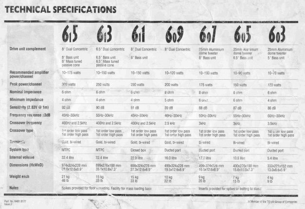

Okay, I haver managed to resize the four page manual so that is small enough to post here. It would be much easier if I could remember where I got it from in the first place!!
(The original is available by Email to interested parties.)

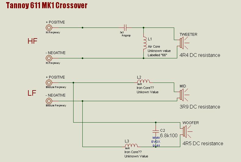

Your crossover should be very similar to my 611 (Mk1) except obviously for the extra driver. The dual concentric in the 611's still reproduces the bass just as yours do. The 611's have an extra driver that works only below ~250Hz.
I have tried Sonicaps and Clarity caps. The latest modification has been a change from a 3.2uF cap on the tweeter to a 3uF. It doesn't change much but it is perhaps in the right direction by crossing over to the tweeter at a very slightly higher frequency without leaving a gap in the speakers response. Your mileage my vary.
Ultimately I wanted to get rid of that Tannoy "honk" or "shout" that comes from the horn. (The sibilance problem with S an T sounds.) I am now resigned to the fact that a notch filter is needed for the crossover but at what frequency? I lack the experience to decide. I'm going to have to try this soon I think.
I will eventually, when funds allow, go for an active setup possibly with a Behringer DCX for a truly flexible solution. But for now I'm just trying to make do with what I have.
Anyway, sorry for rambling! Here's a schematic I made of the 611 Crossover as compensation. It may be of some use. Does yours use similar values?

Hi Martin,
Thanks for your schematics and thoughts on the crossover. Very good gen (again).
It's good to know that the Mk1's might be the better choice at the end of the day.
My 6o9s are at my sister's place in NZ (where I am now visiting for a few weeks). The visit here is flying by, so I'm not sure when (or even if) I'll get to take a close look at the crossover on this trip (as much as I'd like to). If I do I'll email you with my findings.
I have no idea what to suggest for a notch filter frequency. I'm wondering if it might be possible for you to somehow build and try a rough variable notch filter initially to 'experiment' and give you a better idea, before building a fixed notch filter of more 'sonic quality'.
