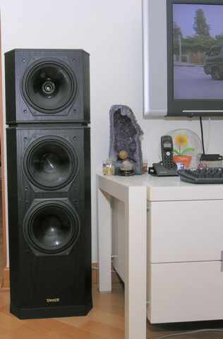

hi martin please give me your email and i will send you a pic of the crossover.i have lost the email password i set up for this account so will contact you with another the 615 is warmer sweeter i do not think the mk2 was an improvement worth shouting about. i have just changed the diodes on the cyrus 2 pre section and it sounds smoother the more i listen to the 615;s the more i just will not part with them i love themthe bass is deeper honest you will enjoy there sound after a day as they sound totaly unique. the bass has a 17 watt resistor and a cap and the other drive unit an inductor, so i do not know which is the pasive bass unit i have tried to attach a pic but it says file too big thanks for the tweeter cap tweak
these are like mine i got the pic off the net as my pics are too big of a file need to send them through email

So does that mean that you got the Mk1 version?
One inductor on the bass is similar to the 611 but the 17 Watt resistor on the mid/bass is different. Interesting. I'd like to see the pic if possible. It's against forum policy to post email addresses in public but if you drop me a line via my Email button then I'll send let you have it ;)

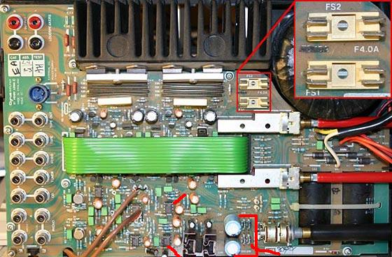

hi martin there are four diodes next to the volume pot on the cyrus there are also opamps in the pre amp section which can be replaced but i will let you know the results once i changed them i will help you mate also i have replced the cd 4se with a modified cd 63 se which is much better only in modified verison mid range sound stage and treble is miles better

I know that we're supposed to stay on topic here but anyway (I tried),
I'm using my Cyrus 2 with a PSX so I'll replace the diodes there first. I'm not using the Phono section so changing the opamps for me is not necessary yet. What diodes did you use? Do you have a link to a supplier?
My CD4SE has been modified and I would love to test it against a modded CD63. It would be very interesting. For now I'll stick with the Cambridge since the warmth compliments the forward nature of my amp and speakers. I've tried other players lately but none has the X factor of the CD4. Let me know if you ever get around to modding your Cambridge. I'd be very interested to hear what you think of it against the marantz.

hi i am not sure all the opamps are for the phono someone told me two were for the pre section ..........
Hi again and thanks for the diode info. Did it make a big difference?
All of the opamps are for the phono section only. Some people refer to this as the 'pre' and this can be slightly misleading. Anatech (Chris) has reliably informed me that the phono section is prone to oscillation and instability whch can affect the main section. Obviously this is not good but is easily remedied. You really should read this thread since Anatech repaired (repairs) these amps under warranty from Cyrus so he knows his onions.
http://www.diyaudio.com/forums/showthread.php?s=&threadid=89479
The Cyrus One and Two have completely passive preamps. They are basically a low pass and high pass filter and a potentiometer.
