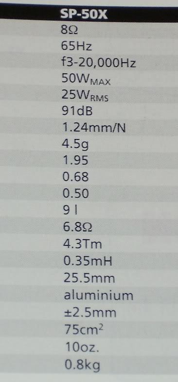

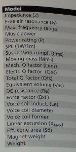

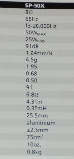

monacor spx50 specs
Here's the specs for the monacor 5 1/4

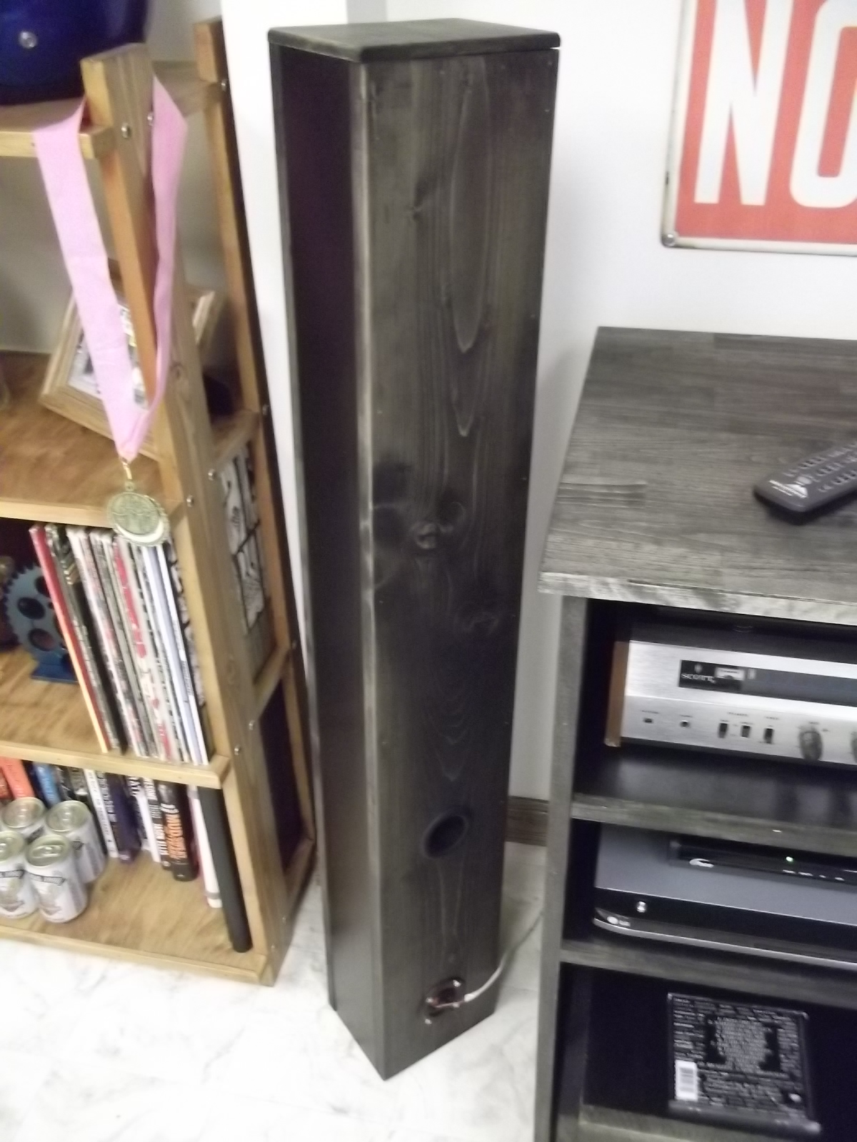

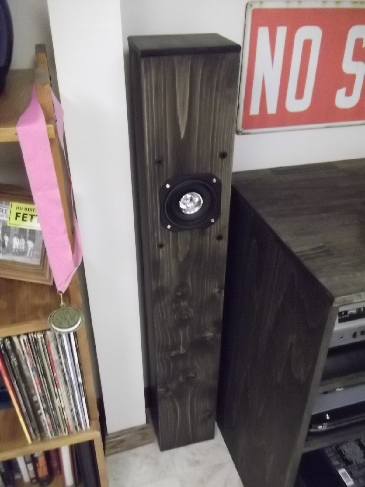

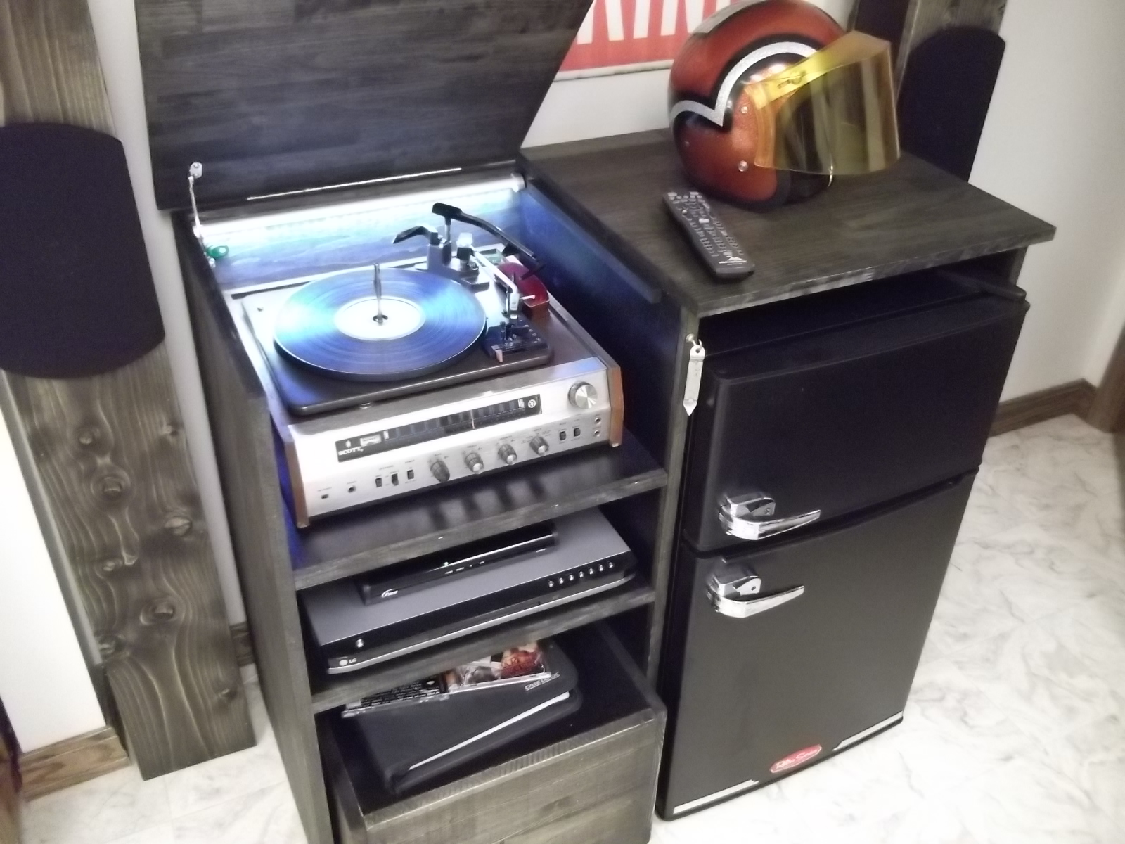

Here's my current setup in my basement. The driver is 12" down from the top and the vent is 16" up from the bottom. Vent is 3.5" long by 2" wide. I modeled the enclosure in winisd.
Aesthetics was the reason for the placement of both. Nothing more. Almost a truly AMLTL!

I bet you built an AMLTL with this. If you were to do a measurement with a mic and Holmimpulse, I bet the low freq is about 5 to 10 Hz lower than the tuning predicted by WinISD. It would also show up in an impedance measurement. Placing the vent at 6 in will probably make it a truer MLTL. Do you have any stuffing inside?

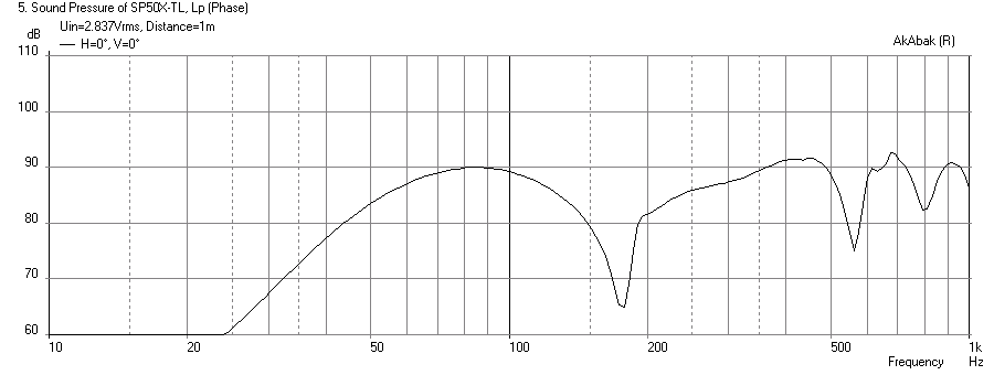

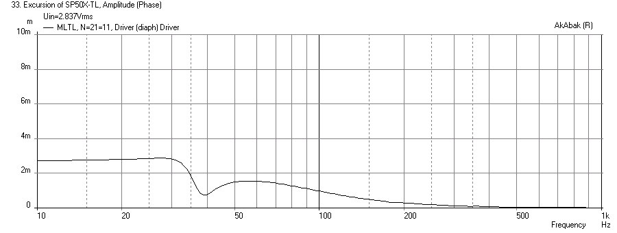

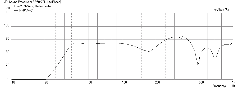

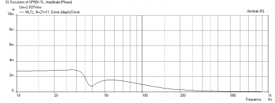

SP50X MLTL Model
Ryan,
I ran a simulation of your as-built SP50-X tower speaker, and unfortunately, it doesn't look too good. The bass is what I would call kind of weak as it appears that the cabinet is too small in volume and the port is too high up. The bass starts rolling of at 80 Hz and there is a big dip at 175 Hz (see freq response of simulation). I think the default volume suggested by WinISD is just too small when stretched out to a long slender column.
I then proceeded to optimize it by increasing the volume, locating the port lower, and moving the driver location to 1/3. The optimized response is much flatter and reaches down to 40 Hz with a flat 'authoritative' bass shelf. You should notice a big improvement if you were to build the new cabinet. The calculated driver cone displacement also seems to be well controlled.
The new design is as follows: 6 in wide x 9 in deep x 46.5 in tall, vent 2 in dia x 3.25 in long located at 5 in from bottom, driver at 15.33 in from top, usual stuffing. These are all internal dimensions. To get the best response you should use a 0.8 mH inductor and 8 ohm resistor for a BSC circuit.
Sorry your as-built doesn't look so hot as a MLTL.
