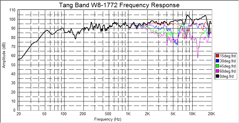

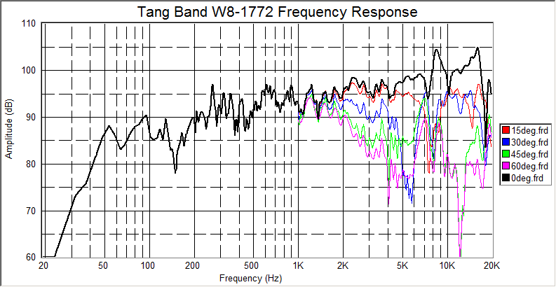

Sure here they are. The original links were through Geocities, which is now gone.
The W8-1772 is mounted in my TT-2000 cabinet without any filters.
Bob

what's it sound like at 10' away ?
I like them in an 8' triangle. Much better -- smoother yet more detailed than the FE207E.
rising response should be fine due to lack of dispersion.
Well, the farther back you get, the less you need to worry about rising response. I just use a (DSP)BSC and some toe-in
Does it need a notch just ast 8khz ?
Note that off axis, there is a hole at 8K.
Thanks for posting the graphs.......
Norman
Anytime!
Bob
