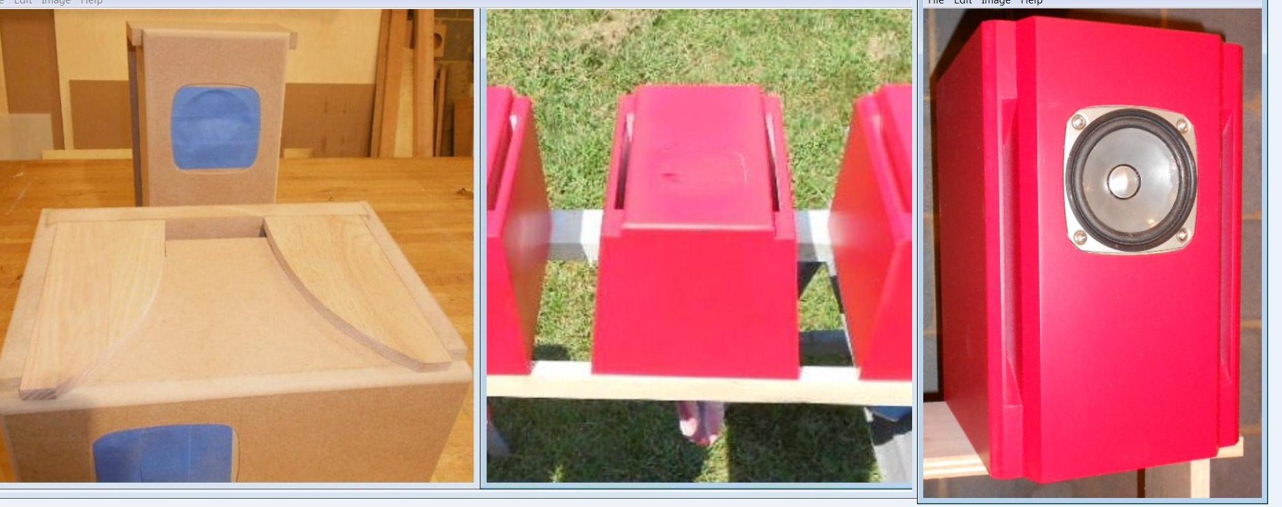

Well I wanted to say I did see the metronome awhile ago. I didn't build this diy box to copy or look like anyones else's speakers. I wanted to build something different and why not do a trapizod box as they call it.
I clearly remember other trapezoid designs so it is not unique at all. And if you had a proper understanding modelling and the interactions with a room then you would discover that putting the port in the bottom as with the metronome has some some very large benefits.
Yes that is what I am saying the design is not new and not mine own design adn I will not take credit for the shape of the boxes. Now whats in the box and how its braced and how the air is directed out is new and my own design. Now putting the port at the bottom hummmm? I would have to think how well it would work on a carpeted floor,tile floor,wood floor, and a cement floors? I put the port in the back for me to be able to give more bass out of this design and out of the room by pushing it towards the wall or pulling it out to have less bass. I also did it due to little kids hands and kids dropping or putting things in places they should not be. I have dealt with this alot of times. Also I love the way your speaker looks but, again I am doing my own thing. If you lived near by I would enjoy sitting and talking and compairing notes and see what you thoughts were on this speaker I built? Thanks for you help. Jdm
