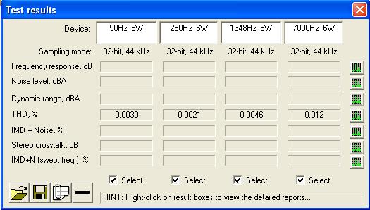

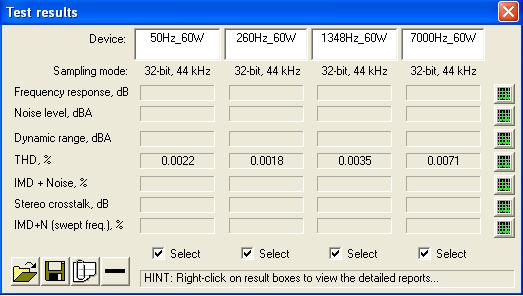

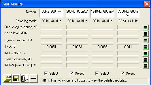

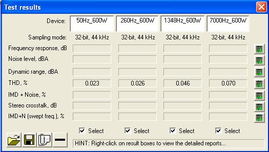

This morning I measured THD vs frequency at 60W into 2 Ohms, circuit identical to yesterday's measurements.
My equipment allows THD measurement in the frequency range 50Hz-7000kHz.
I divided this range into 4 steps, always increasing the frequency by factor 5.19 .
Very clear his point is valid, if you want to run from unregulated supplies.
Here the full picture of the THD.
THD from 50Hz to 7kHz for 600mW, 6W, 60W and 600W.

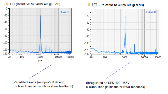

Hi, the measures are not bad, but just on fft, you have the classic defect of harmonics reversed, and repeated many harmonics. this does not adjust by changing the toroid unfortunately. responsible for this is the circuit that runs the dt and shape of the square wave in the driver circuit. of course, the feedback can help later.
sorry if placed two pic in your thread, maybe you can use as a reference. the second pic refers to similar your amplifier, the harmonics are resolved as you can see but it remained the second harmonic reversed. (this only characterize the sound, maybe it's not bad, sound similar at tube, of course fast.
the first pic is the best I got. by value and projection of the harmonics.
your low thd vs. frequency, is a great achievement (not easy), maybe you can get even better on the fft. this is all about how to play music on your amp.
P.S. for precision on measure...i see it's not bad, noise is flat on right ch. is better you ceck spectrum on generator also.
regards

Your opinion is fitting to earlier results.
Earlier I had high k5 and k7, which I was able to bring down by 15db with adjustments in the gate drive.
So I will have a look to this direction again, thanks for remotivating me to optimize there.
I was already a little bit annoyed by the earlier gate drive adjustments...

I went on experimenting. Almost any change makes things less fortunate.
The set up seems to be already mostly in the optimum.
Another close-to-the-optimum-adjustment allows to bring down K3 further and get rid of the K9, but at the same time suffer a little bit on the K7. Overall still a similar wide spectrum, but all in the -100db area or less.
I also experimented with some ns additional delay, they systematically made things worse. Which is an important observation, from horse sense one could guess that some ns delay don't make difference compared to the group delay of the output filter.
The design has a propagation delay from comparator output to half bridge output of 140ns. From comparator input to half bridge output around 200ns.
And the group delay of the output filter.. - feel free to calculate/simulate on your own
... but adding just a few tens of ns already doubled the THD, unfortunately I cannot easily substract some tens of ns and see what would happen.
Overall I am glad that the amp really turns out to be well balanced over all disciplines.
- Fast and blameless step response, with rise times in the range around 4.5us
- Very forgiving on load impedance
- Almost free of carrier aliasing
- Blameless clipping recovery
- Low distortion over wide frequency range and over a wide power range, but with wide spectrum in the -100db range
- No annoying noise
- PSRR suitable for unregulated supplies
P.S: Still no indication of massive errors in the measurement equipment.
P.P.S: K11 is a known artefact of my measurement equipment.
P.P.P.S: The discrete gain stage has a very calm nature in the region K5, K7, K9.
P.P.P.P.S: The triangle allows similar possibilities for adjustments like the shaping network of the gain stage.
