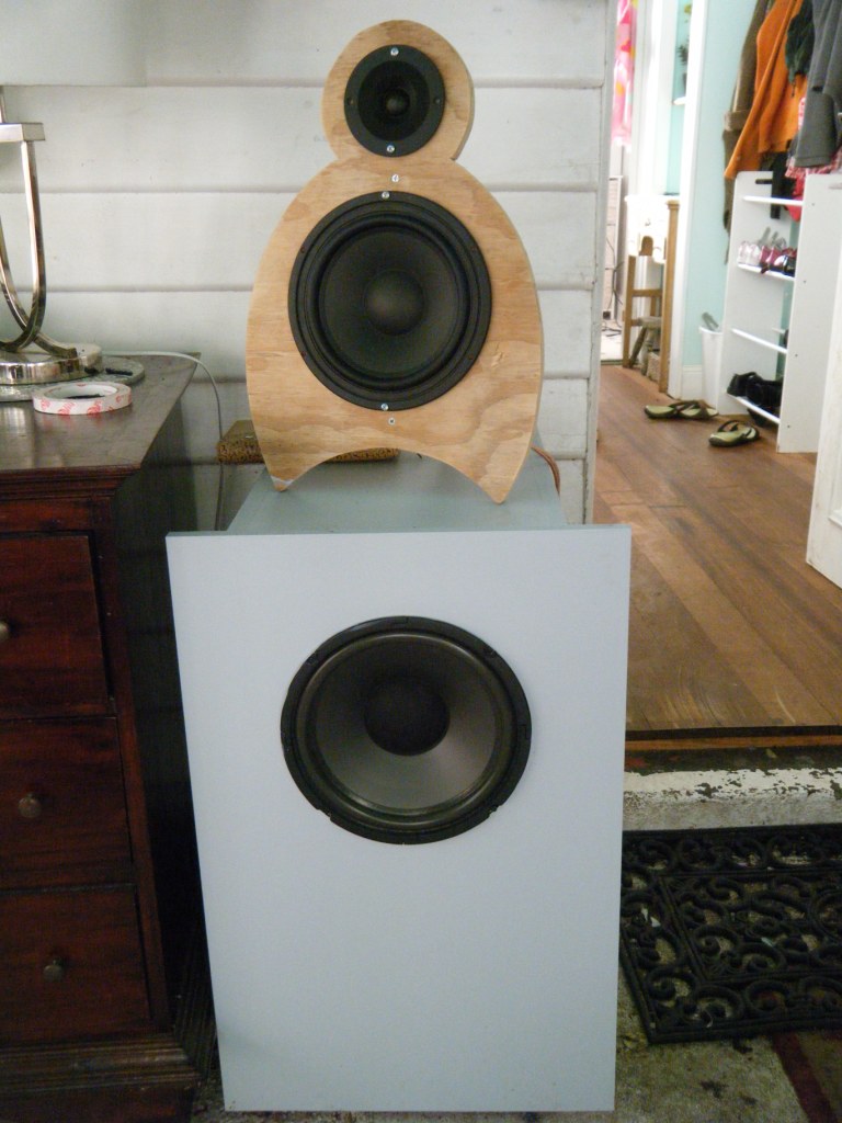

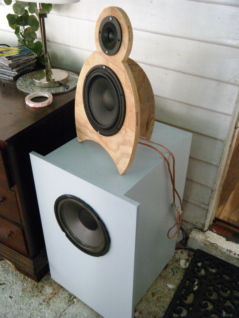

This is my first diy speakers system in years.I remember my first was to put car speakers in cabinets powered by a walkman cassette 25 yrs ago!
3 way Hybrid open baffle (driven by 3 way active crossover amp)
Crossover at textbook 300hz/3.5kz.
HF dome and Mid 8" drivers cheap DME brand ($80 the lot).these i hope to upgrade in the future.
Open baffle section is to be remade in nice wood by a freind with good woodworking skill.
LF 10" Redback brand spec states go down to 30hz.Mdf cabinet about 110litres ,reflex port at back.
Of coarse im going to say they sound great!!having active system means they play well beyond confortable levels and stay clear.
The bass is the standout quality in this system.clean,smooth and deep. i dont have a measurment setup but listen to some dub (Pitch Black from new zealand) the bass drop sweeps must close to 30hz. My other system is Monitor Audio bronze bookshelfs with a sub so i know what low sound like.

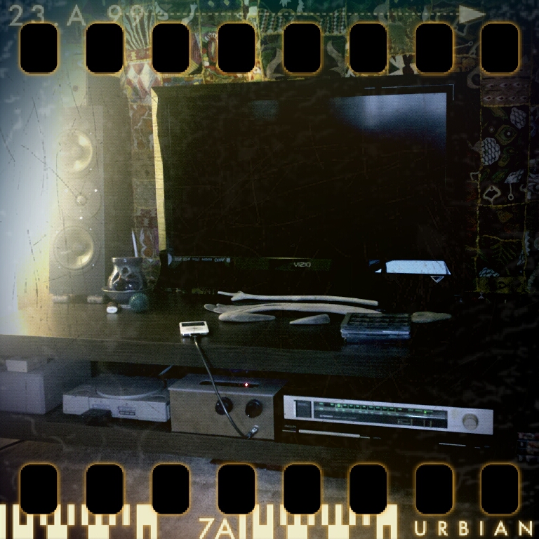

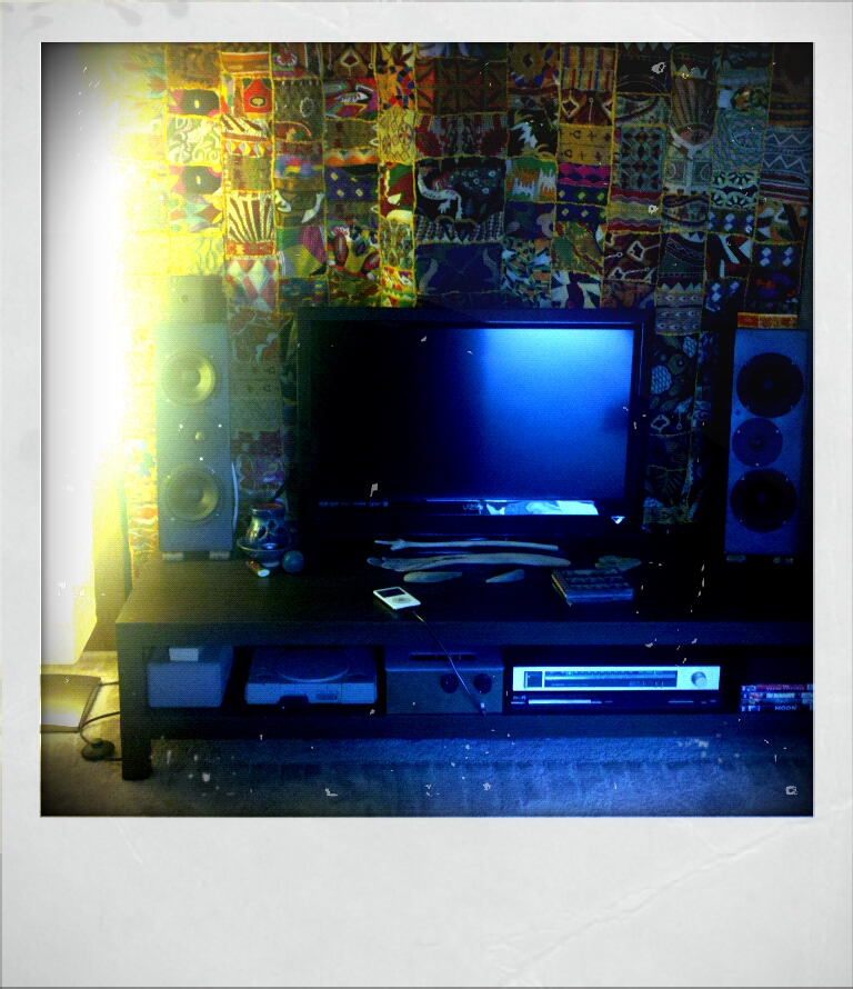

Sorry for the odd photos, but they are the best my Droid X can take. My sources are a Playstation SCPH-1001 ($15, Salvation Army), early Airport Express ($20, eBay), Pioneer TX-540 FM receiver ($13, Goodwill), iPod with line-out dock ($10, eBay), and Vizio aux. out (well, came with the TV).
The amplifier is a LM1875 (following the Makezine Squelette article, total of $40?) boxed in an Ikea tissue box ($8) with a four pole, five position rotary switch ($5) and 50k surface-mount pot for volume control ($15).
The speakers are Tritrix MTMs -- the drivers and crossover components came as a kit and the enclosures were my first DIY speaker project, totaling about $125. Nearly all interconnects and both speaker cables came from one run of patio cord (dubbed 'White Lightning Moonshine') with affordable connectors I picked up in Saigon while traveling.
I have a very small budget, being a recent post-grad in the USA, but I have to say that this setup is the ultimate 'starving-[recent]student' system! Decent CDP (trying mods soon), digital out from iPod and Airport, great sounding FM for KEXP and NPR, and reasonable DVD/TV audio output. All for less than $300.

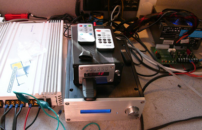

MY STUDIO SYSTEM
How is this for a different system:
Preamp along1986090 preamp kit with their cabinet
MP3 WMA Player by Along1986090
Car 4 channel automotive amp. 200 Watts [the power supply is a 650 watt computer power supply.]
I am driving a pair of hombrew e ways speakers in ported cabinet.
Sounds great.
I now have this hooked up to a NAD 912 main amp and it all sounds wonderful.....also using an external DAC and Foobar for music from our computer network

Thanks for the compliments on the speakers! They sound great but could definitely use a subwoofer to fill out the bottom end (they're the sealed Tritrix enclosures).
As for the Playstation, I didn't know that it was started as an April Fools joke, but it sounds great to my ears and for sure is better sounding than the DVD player under the FM receiver. I've never had the pleasure of owning a decent CD player, so until I can find (or build) something nicer, the Playstation will have to do!
