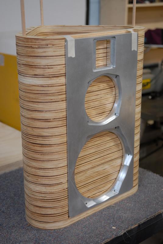

Here's the striplam section's for a 4 way I'm putting together .
Cheers

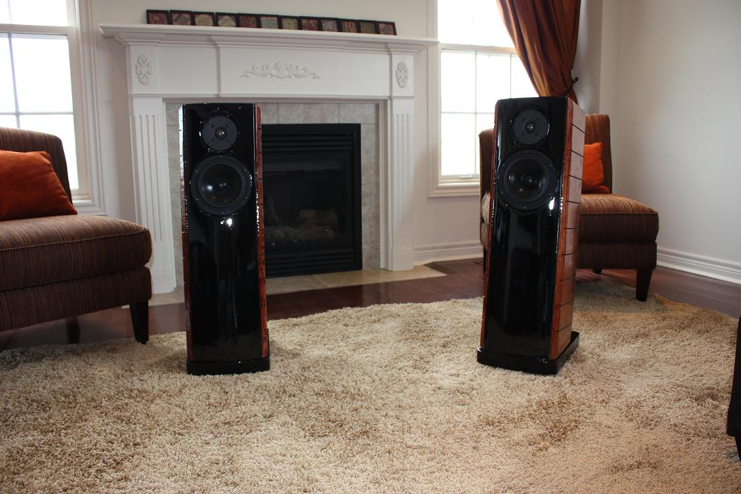

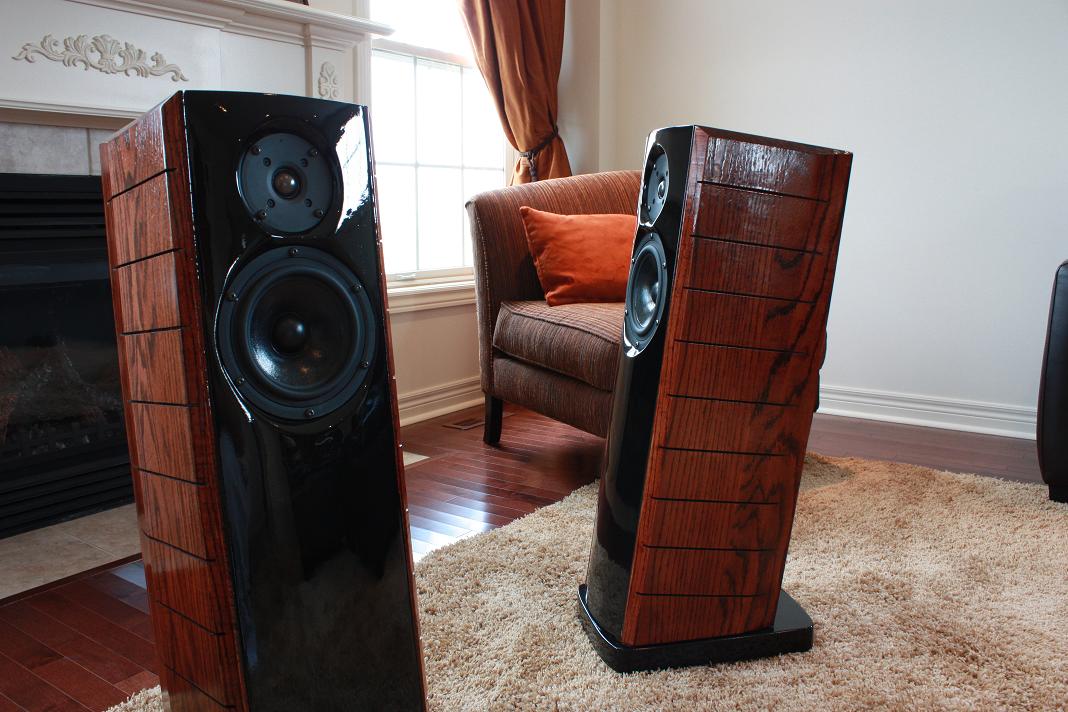

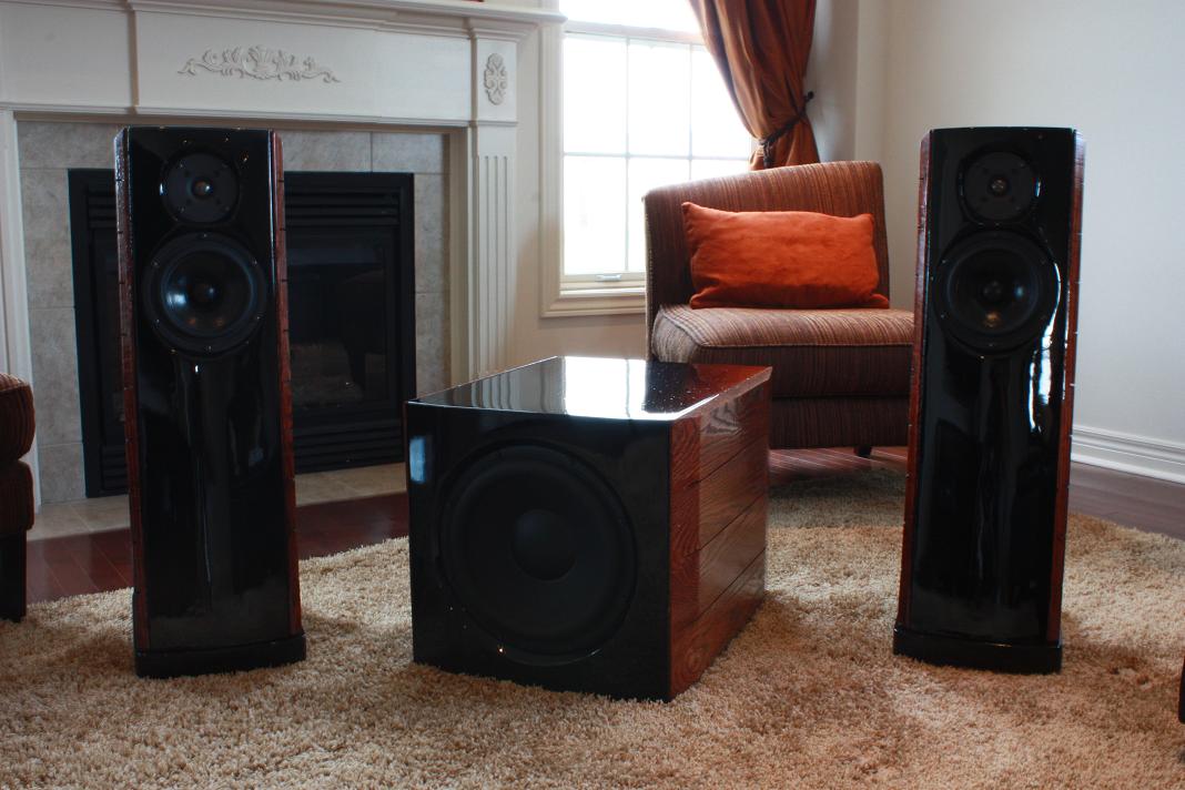

All:
Here are some photos of my system.
2-way bass reflex enclosure.
Vifa PL series 7" woofer
Peerless HDS Tweeter
External crossovers 24db/oct centered at 2.2 khz.
Subwoofer - 12" Peerless Woofer on 360 watt BASH amplifier.

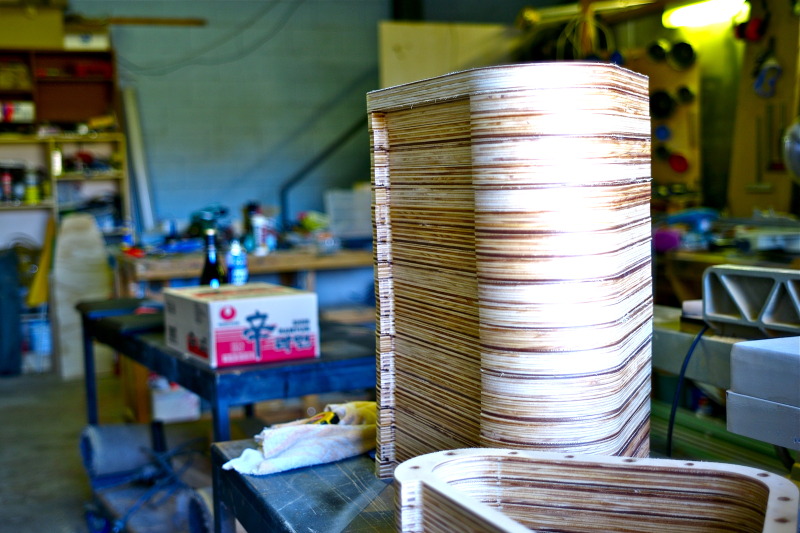

How did you make the curve on the front baffle?
The curve was made by first making a 10 degree cut using a table saw on either side of the front baffle lengthwise. This took care of most of the material that had to be removided, then i used a belt sander to curve the front baffle and ensured consistency using a template cut at a 36" radius.
Thank you for the compliments.
WOW!
And How long did it take for each baffle?
And how thick is the box?
Cheers
Here's a mock up of the striplam ply & alloy baffle
Cheers
Details. What drivers are you using?
It took me about 4-6 hrs a baffle (pefecting), i went from the belt sander, to a palm sander, to hand sanding. Because the speakers were going to be clear coated, any variation in angle was going to be quite visible.
The wood work is fantastic. High gloss polish is so reveling of any errors yet you dared to use it. Fantastic work.
