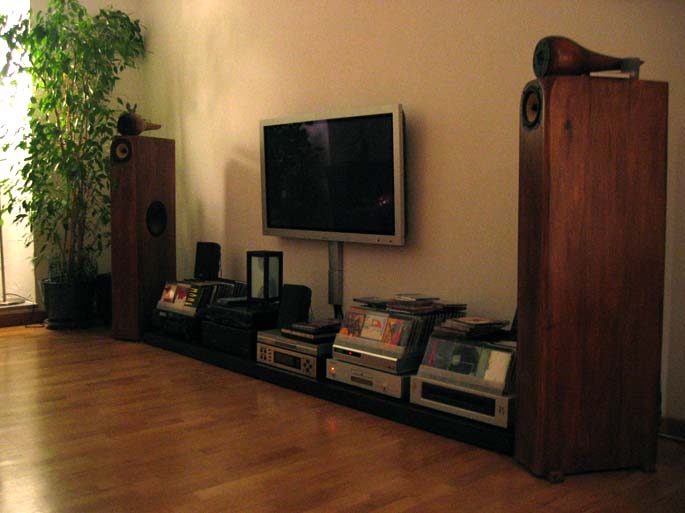

My 2.5 ways system
This is my system with 2.5 ways speaker. Vifa xt25 tweeter, focal 5k4211 midwoofer and coral R 8" Woofer. Not small... but I made it before to be married:D
The mw\tw xo is passive and the woofer xo active (behringer).
The sound is very detailed but lacks a bit of dynamics.

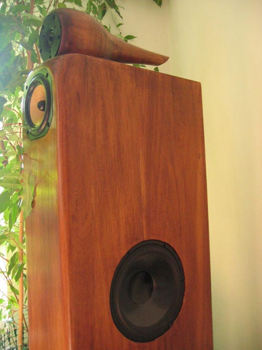

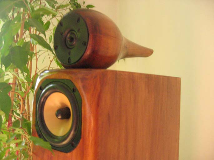

The woofer is side mounted, here two more images, the tweeter box is made by lathe (I hope is the correct traslation). I have made some test and in my opinion is hard to listen any difference in the sound between this shape and a small box .... but it looks nice!:D
They sound very open and fast without coloration (note the very hi bl\mms ratio) but they lack of authority (I think that this normal for a 5") in the midbass region. The breakup is less audibile than in other kevlar driver that I know. For me is better if crossed over above 200 hz.
If someone have experience with this driver I'll be happy to know what he think about it.

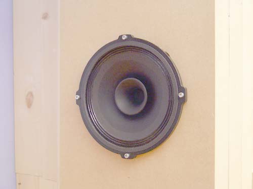

Attached is he pic of the driver with the gamma adjusted so as to better make out the detail
