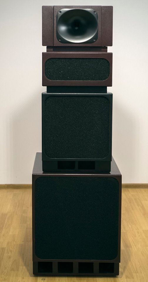

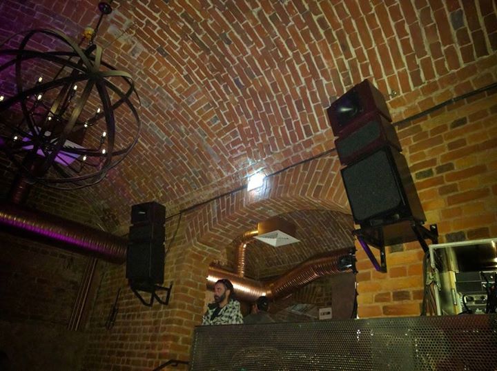

Alphaeta System - 4 way club sound system for High Fidelity Music Experience
Its a clasic design with Faital & 18Sound Speakers powered by Ram audio and processed by NSTaudio
The system can be upgraded from digital to analog, 4way or 5 way analog processor, system upgrade from 4 to 5 way, paint, veneer and another ampliers...
The enclosures are made from MDF-18mm
System RMS Power - 9600W
The system was designed for a live club in Bucharest (Romania) - Audio designer : Paul Constantinescu(DJaudioLab) on facebook

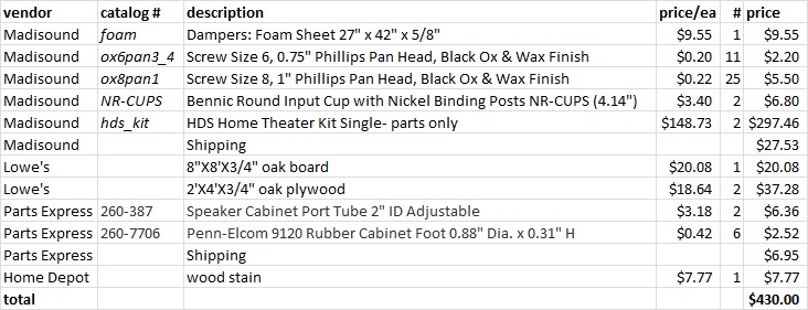

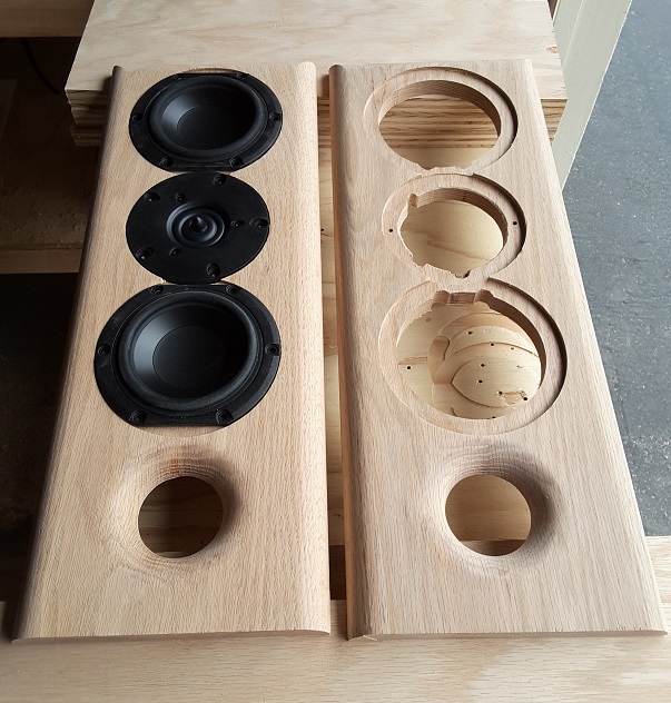

My Madisound HDS kit build
Here is my build of the Madisound HDS Home theater kit. I opted for the ported kit. I followed the instructions from Madisound almost exactly. Internal dimentions are 17"X5.5"X7.75" for a Vb of 725 cubic inches or 11.9 liters. The 2" diameter port is 5" long, tuned to 59Hz.
I used 3/4" solid oak for the baffle, and 3/4" oak plywood for the other 5 sides. The solid oak allowed me to router a 3/4" radius curve around the baffle. I also made the port flare by routering out the port opening.
The detail and clarity of these speakers are just exceptional! And without being harsh or fatiguing. I love listening to these speakers!

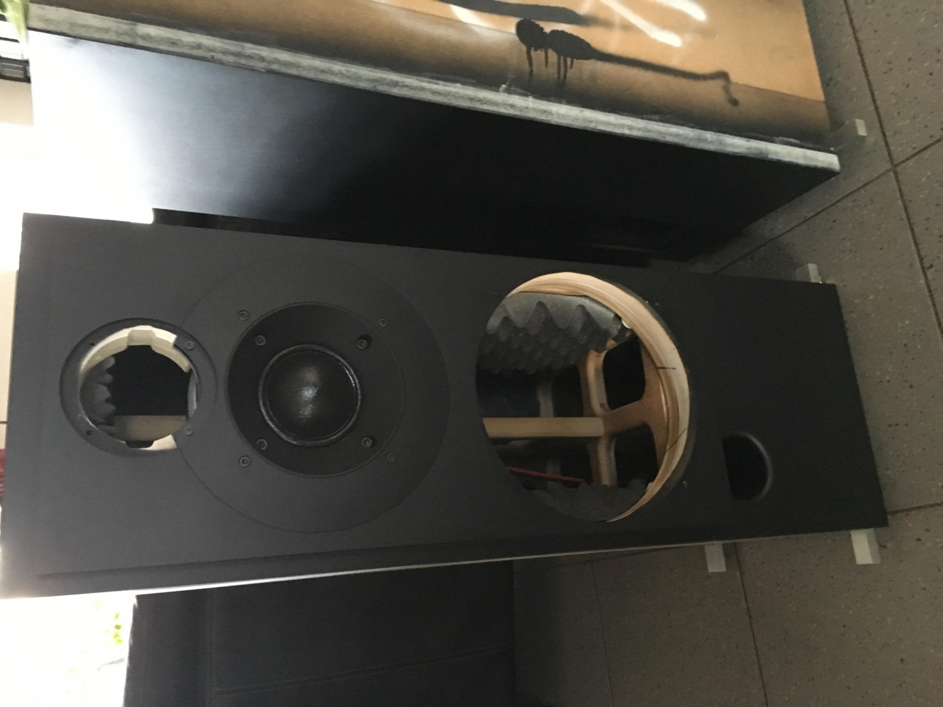

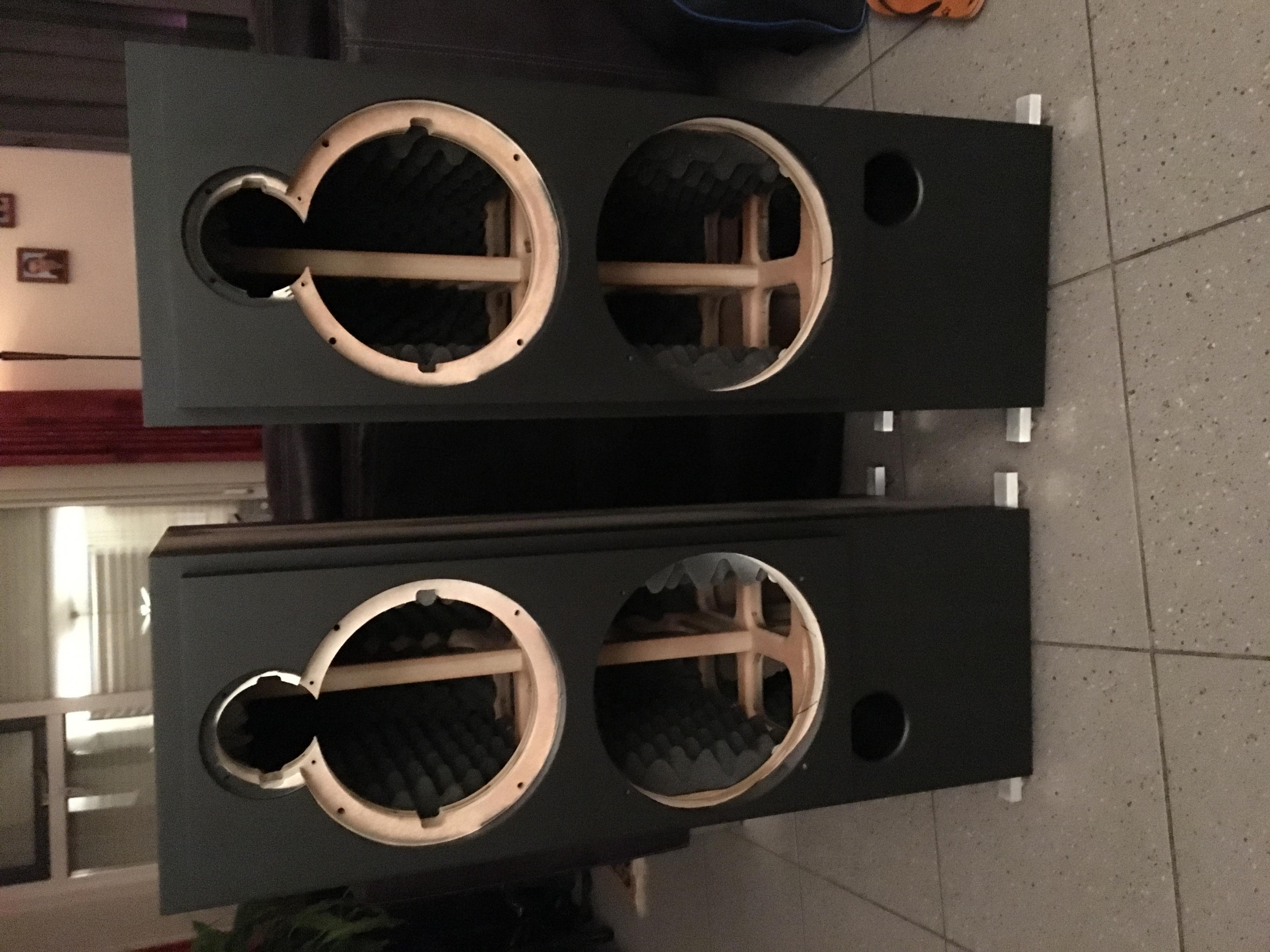

The speakers front and rear is black. For the sides I planned a kind of veneer (not sure yet)
It's all 25mm MDF. The front section, where the driver are fitted, is made out of two layers (25mm + 30mm) glued together. I'll add some pictures.
Don't tell me that's about a 1" dowel running up the center of the braces to the top of the cabinet. Also, what mid is that?
Docent look like a Dowel to me, seams like a mid depth panel style brace?
