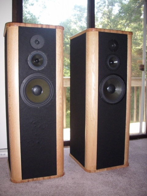

I built active 3 ways using all Eton drivers. Originally I planned on using 2 woofers so the boxes are way too large. I blocked off much of the internal volume for one woofer. The second one wasn't needed.
Thx. This isn't the original design, my brother-in-law; a carpenter, helped build these and he added the tops and made other changes. The good looks are all him.
I can't hardly cut a piece of wood without messing something up.
These were built in 09 and I've been super happy with them. I've had no desire to change these although sometimes I think about doing new boxes. Smaller ones.

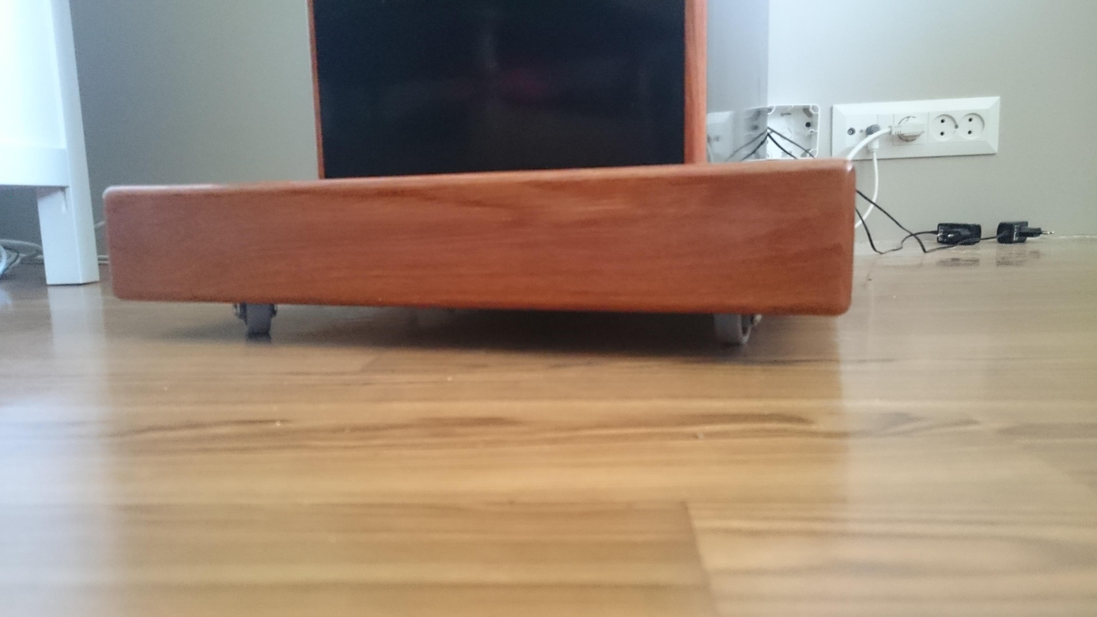

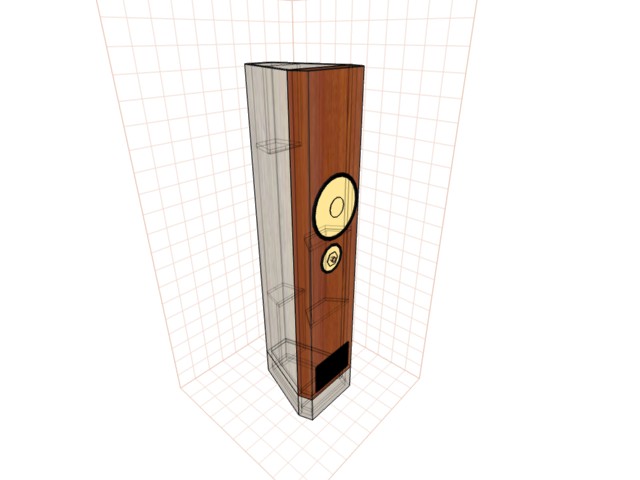

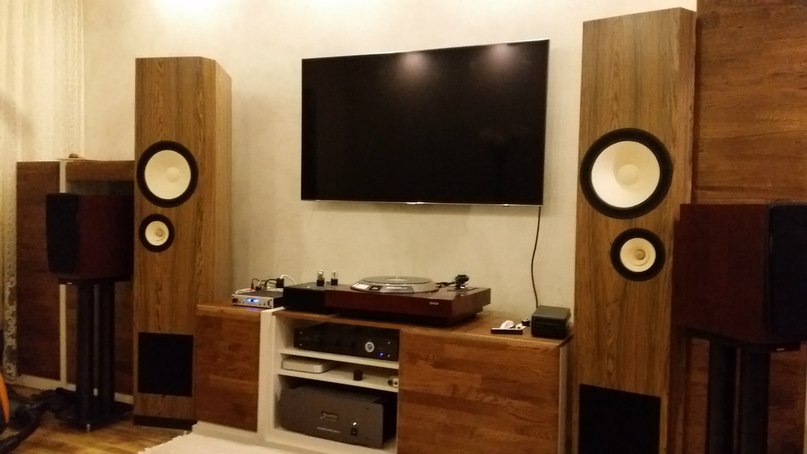

sonido 300SCW (TL, constant cross section, 1/3 driver offset) + 175SFR (sealed box). First order filter for 300scw and 2nd order for 175SFR, 200Hz cross point. Neotech wiring, cardass binding posts.
Birch plywood, veneered. Bottom has added metal plates, to move mass centre lower.
Sealed box is golden ratio shaped cube.
TL - almost mo parallel walls. (TL is also done as "rogozhin labyrinth" type).
Felt on walls, + some wool in first 1\3 of the line.

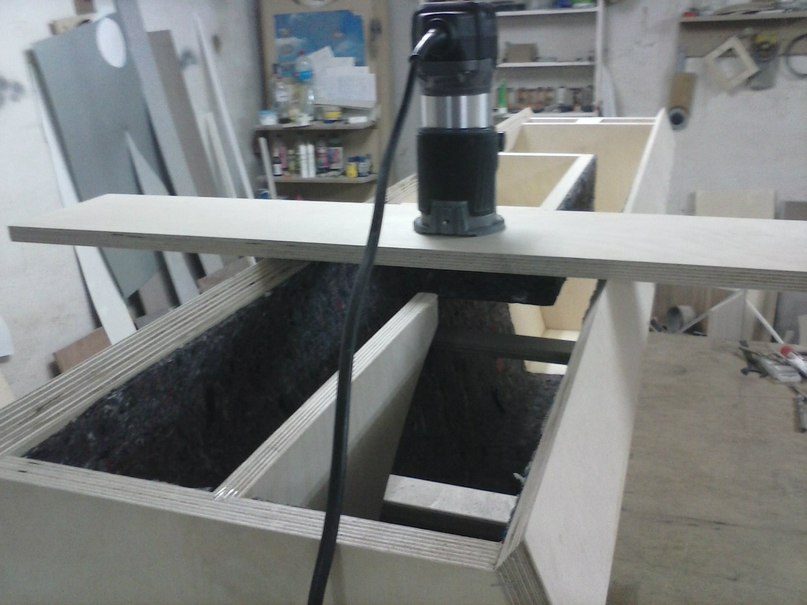

Some details on photos (drawing was little bit changed after, just to get an idea).

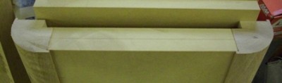

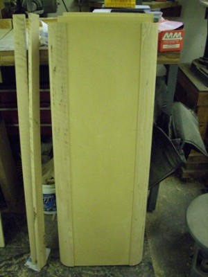

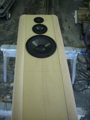

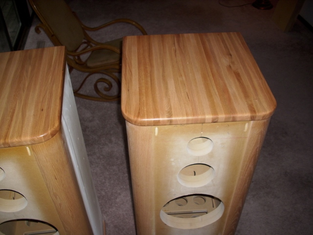

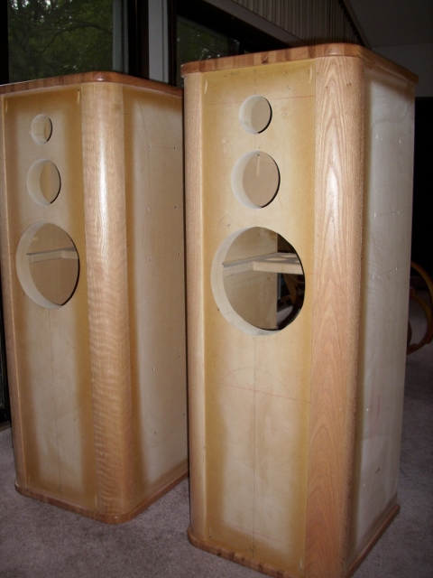

Here are pictures of the boxes while in process;
2 layers of 1 inch MDF glued together.
The corners were made by laminating red oak strips together and then cutting the corners little by little to create the radius. The corners were then sanded.
The panels are inset into the corners with and attached with glue and screws. This inset was done for a reason....
And lastly pics of the insides.
If you look at the earlier pics, the front and sides are covered in felt. I used multiple layers on top of each other using spray glue. Then the felt was trimmed around the edges. This is why the front panels were instepped on the corners. The felt filled this in and the speakers are level all the way across the font and the sides.
