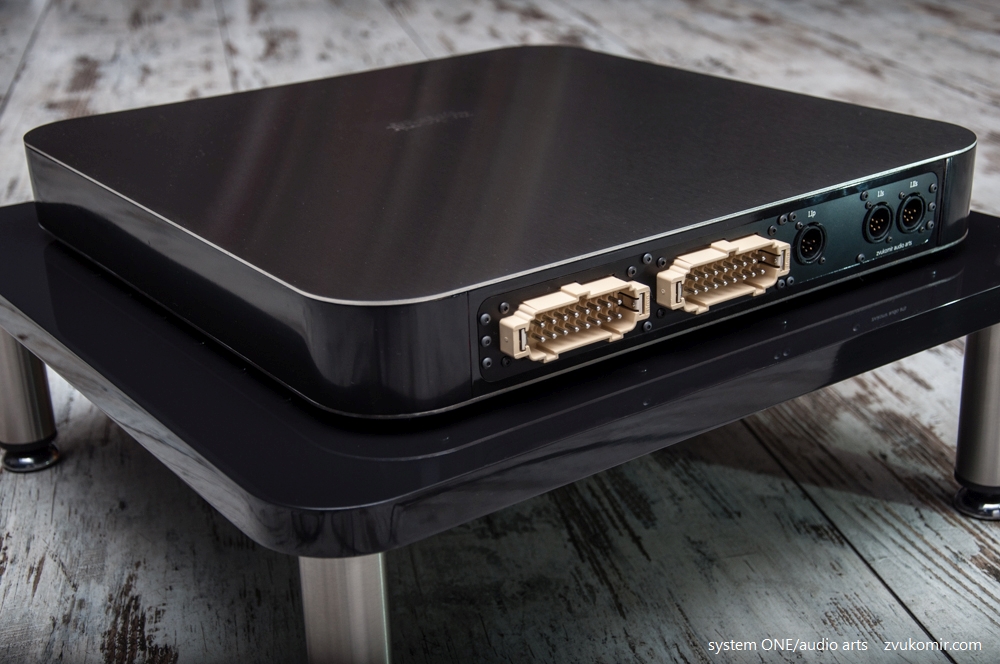

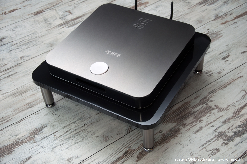

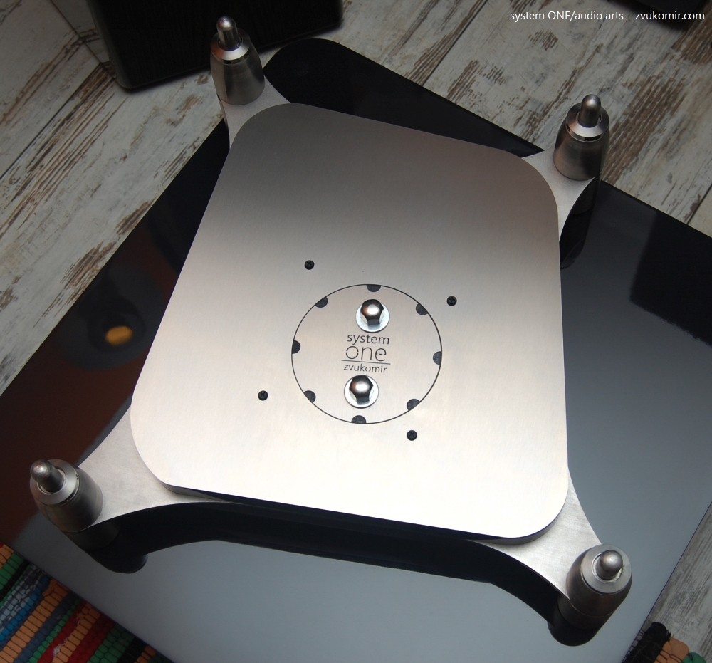

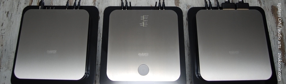

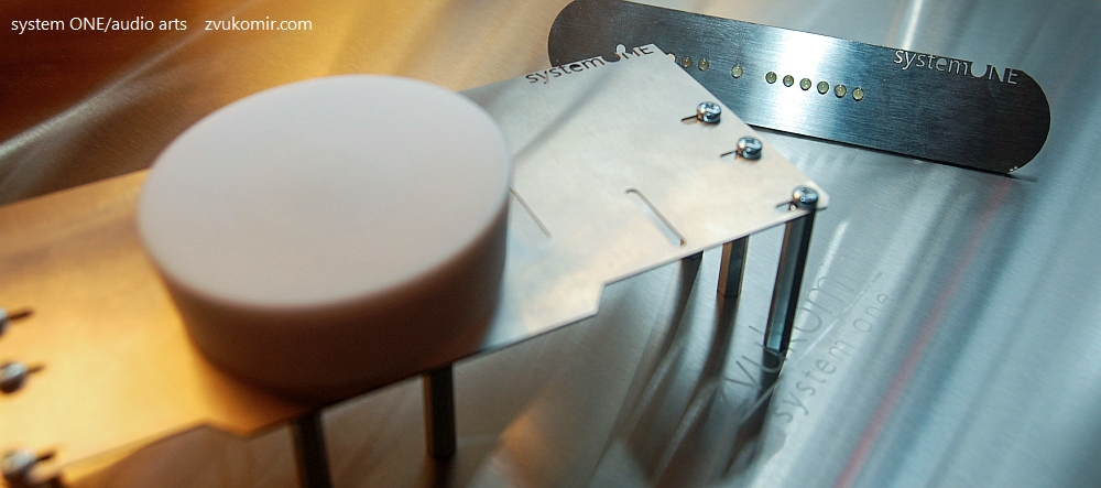

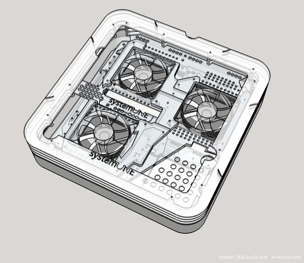

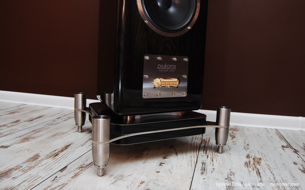

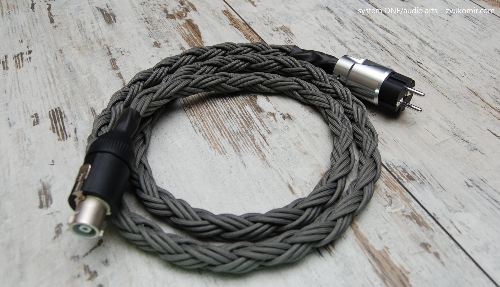

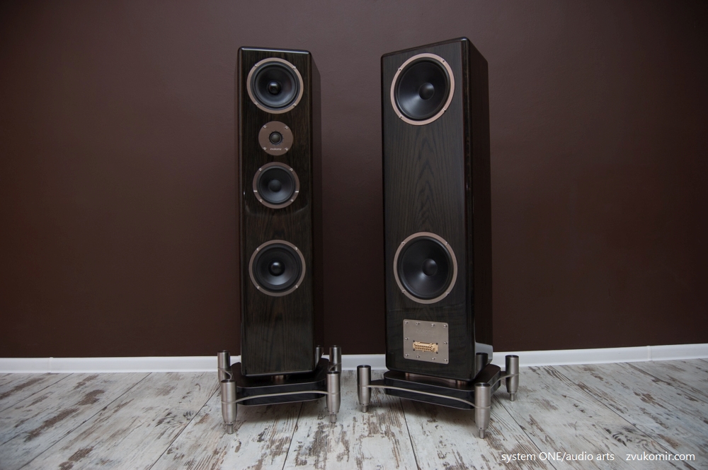

Zvukomir System One
This is my first DIY project. Several years passed from the idea for the project until it's realization. I needed help for the wood processing and the varnishing, but generally this is a single-minded, one-man project.
The system is stereo, dsp based, 12 speakers, 12 amplifiers...
More information and pics: http://audio-arts.zvukomir.com/english/

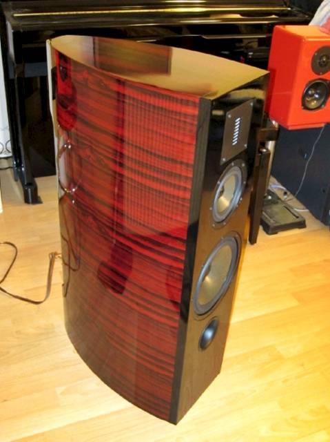

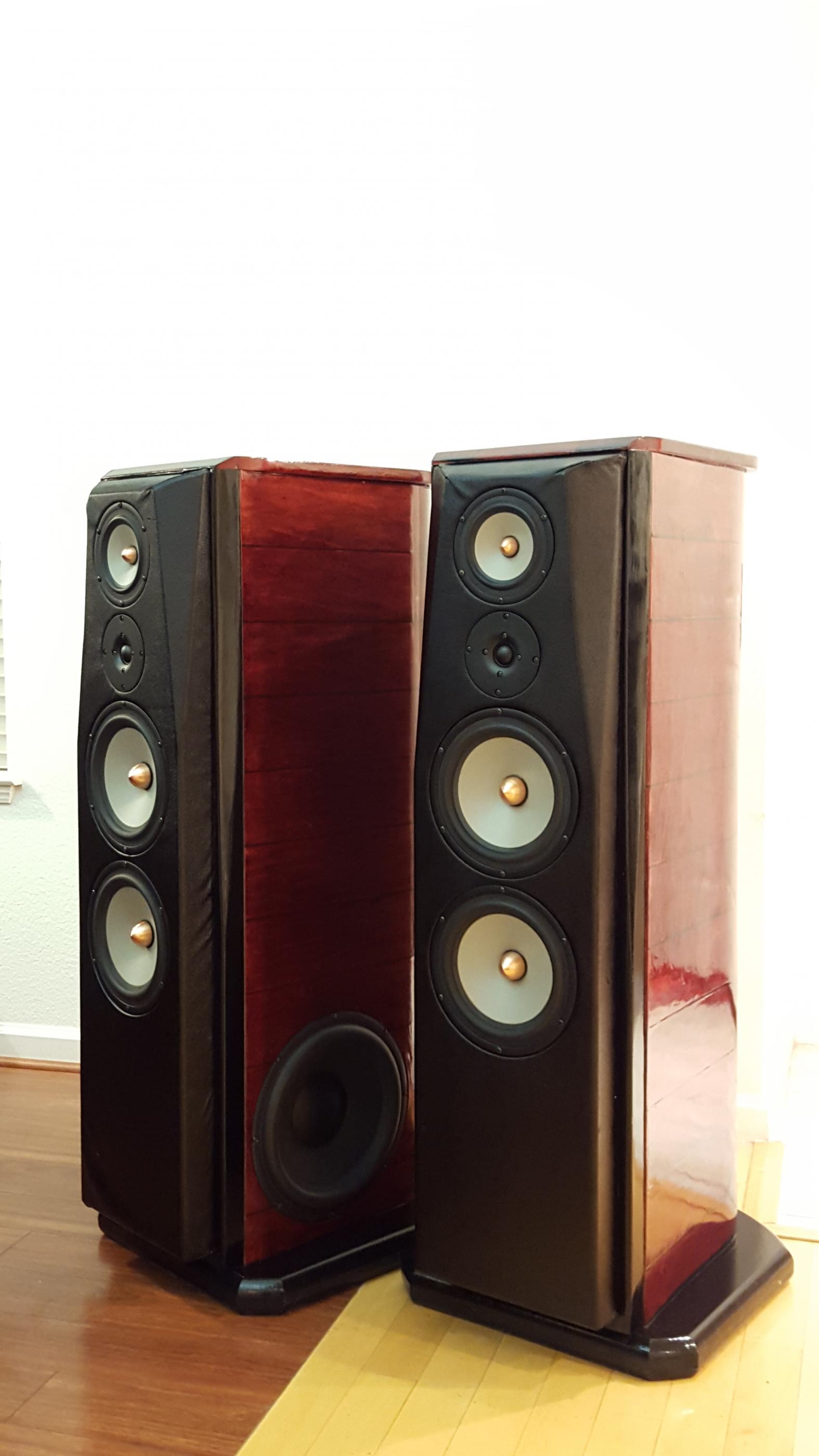

A guy in San Francisco built those speakers with the Sonus Faber type cabinet and Eton drivers. I heard them in May when i was in San Francisco.
He told me had had a professional cabinet maker make that cabinet.
The cabinet looks amazing.
The speakers sounded really good when i heard them.
It had an articulate sound and the bass was very tight.
The speakers used a 11 inch Eton Woofer, 5 inch Eton Mid and the Eton ribbon tweeter.
OT, but how does one achieve such a fine, smooth glossy finish?
First you have to make sure the surface is absolutely or as much as
possible smooth. The mdf has to be treated with sealents for mdf
so there is no chance that it acts like a sponge. After that you
apply spray putty in sufficient layers, and between each new layer
you sand it with increasing grit number sandpaper. The secret of a
perfect looking mirror like finish is that the surface is smooth and that
the paint you put at the end is also in sufficient number of layers.
The buffing process at the very end will increase the shine even more.
You also need to use higher quality paints, not something you can buy
in home depot for 10 bucks.
Standard water based auto paints are a good choice. The shine comes
from the clear coat after the base color coat. I have talked
once to an owner of furniture factory to give me some advice
about the right paints to paint a piece of a furniture and he said that
the best paints are polyethilene based, and then polyurethane.
