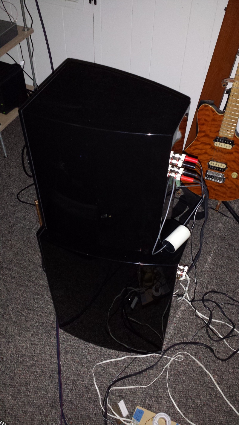

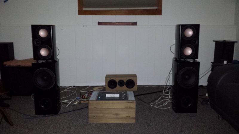

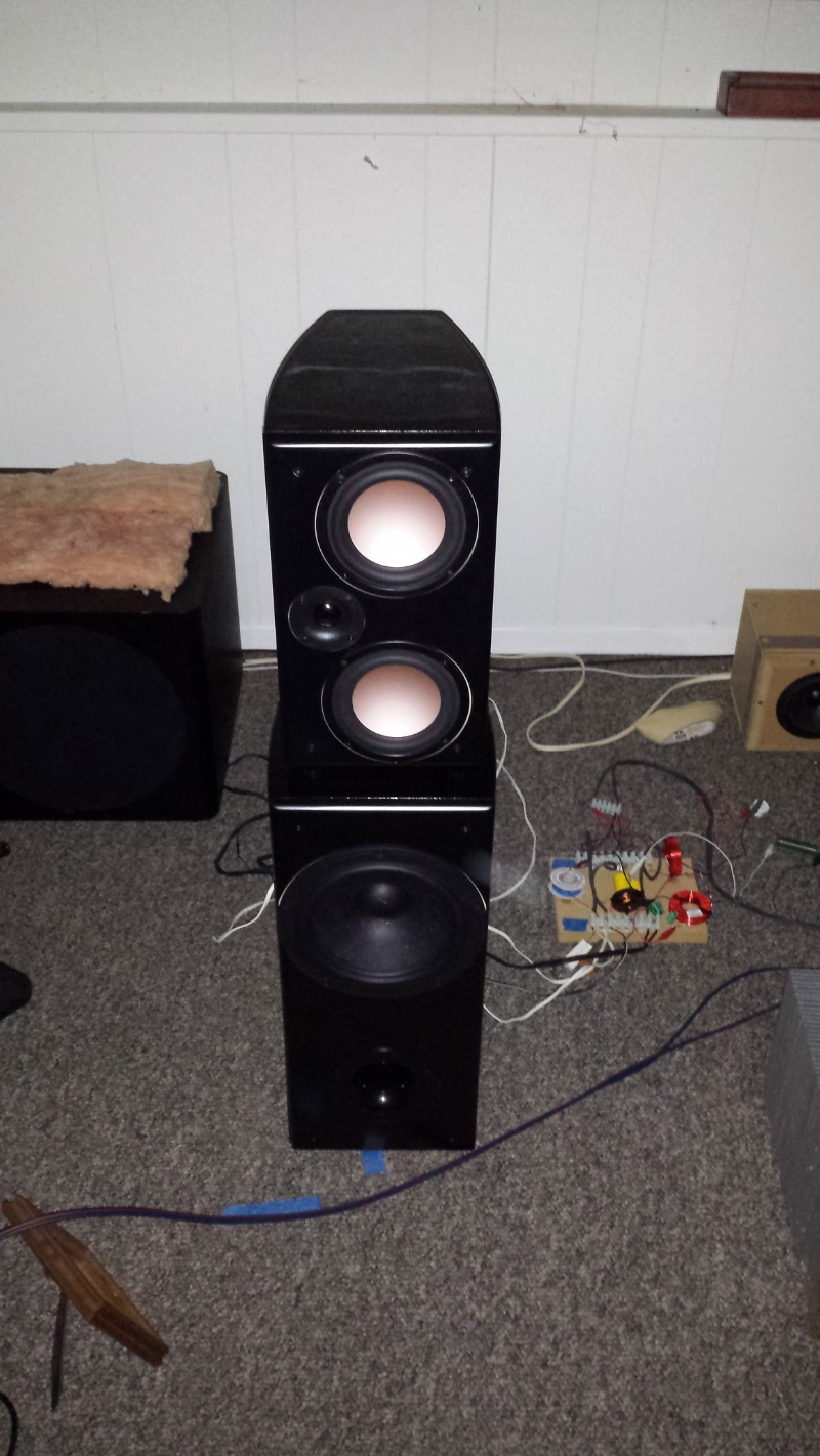

My new 3-ways. Vifa tweeter, Hi-Vi mid-bass and Tymphany woofers (formerly Vifa).
Used passive components that I had available. Crossover at 600/2900. The tweeter section is 12 db slope.
Will eventually tri-amp.

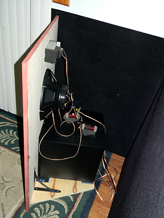

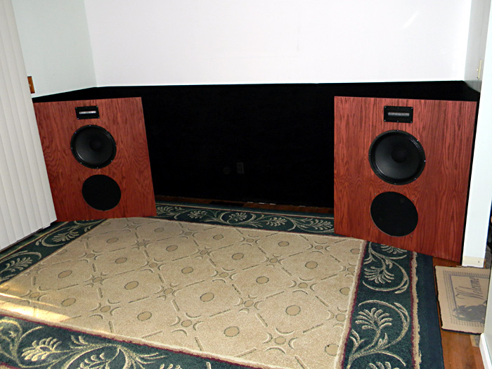

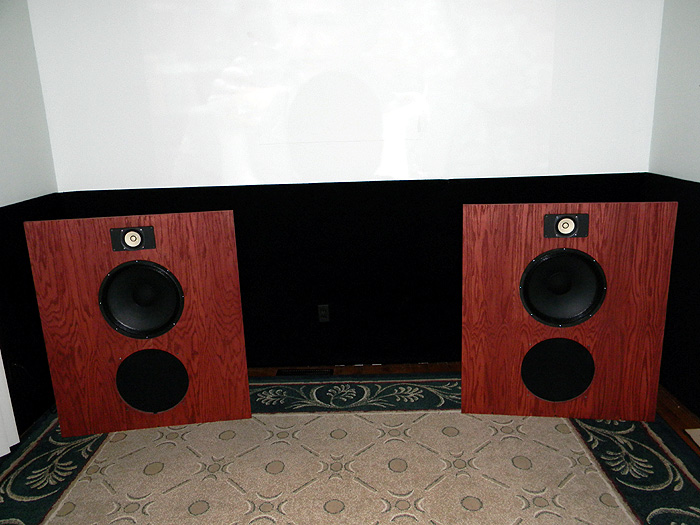

Got the open baffles set up
almost done, they sound awesome, just gotta button up the electronics and I'll be able to sit back and enjoy. :)
Aurum Cantus G1 Ribbons, PRV 15w 800A woofers and Dayton 12" subs.
36" wide by 42" high Baffle.
I'd be concerned that horizontal mounting of the ribbon tweeters may cause the ribbons to sag and potentially rest on the lower magnet. Kinda like the short from DH cathodes to the plates of a 5U4 if operated on it's side in the wrong plane.

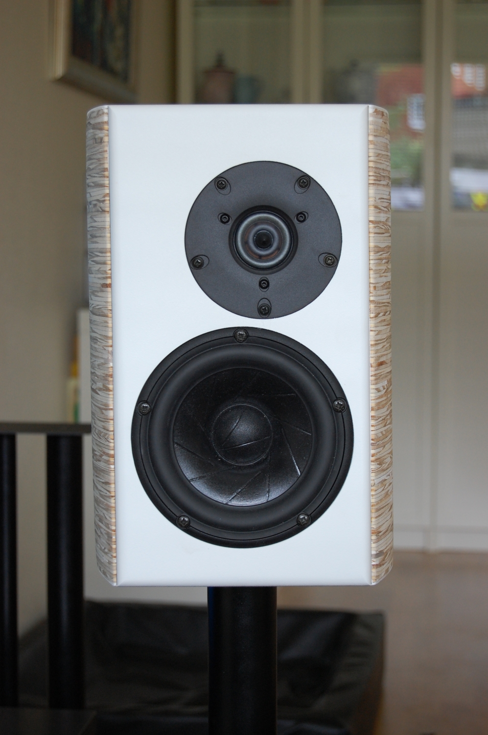

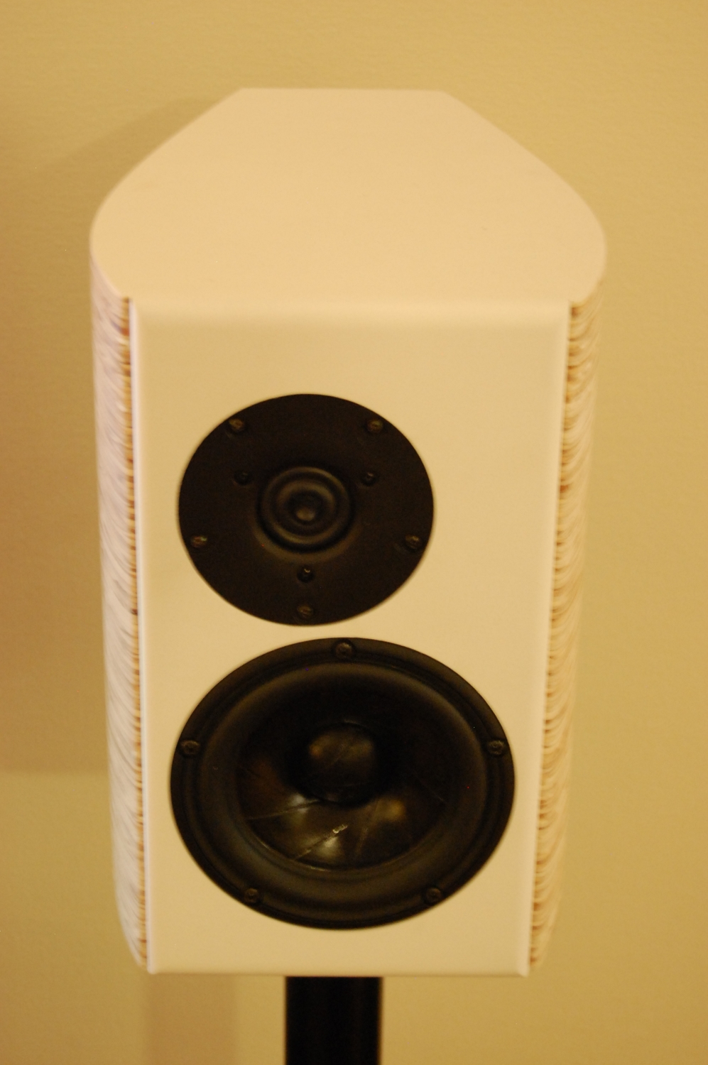

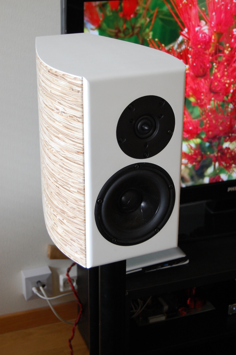

Zaph ZD5

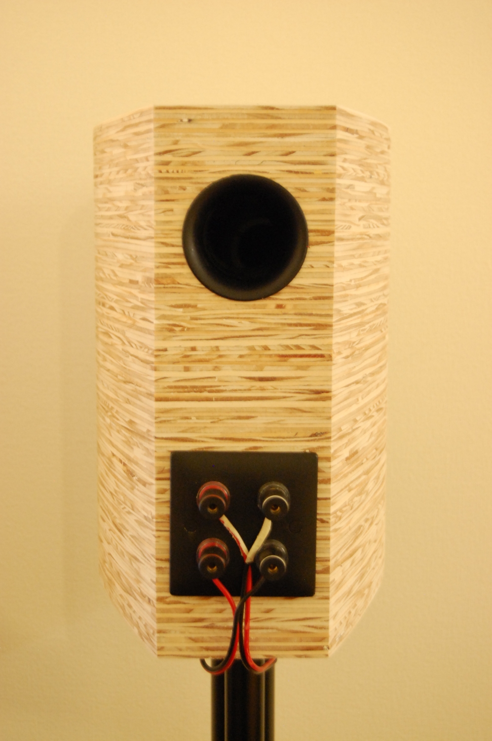

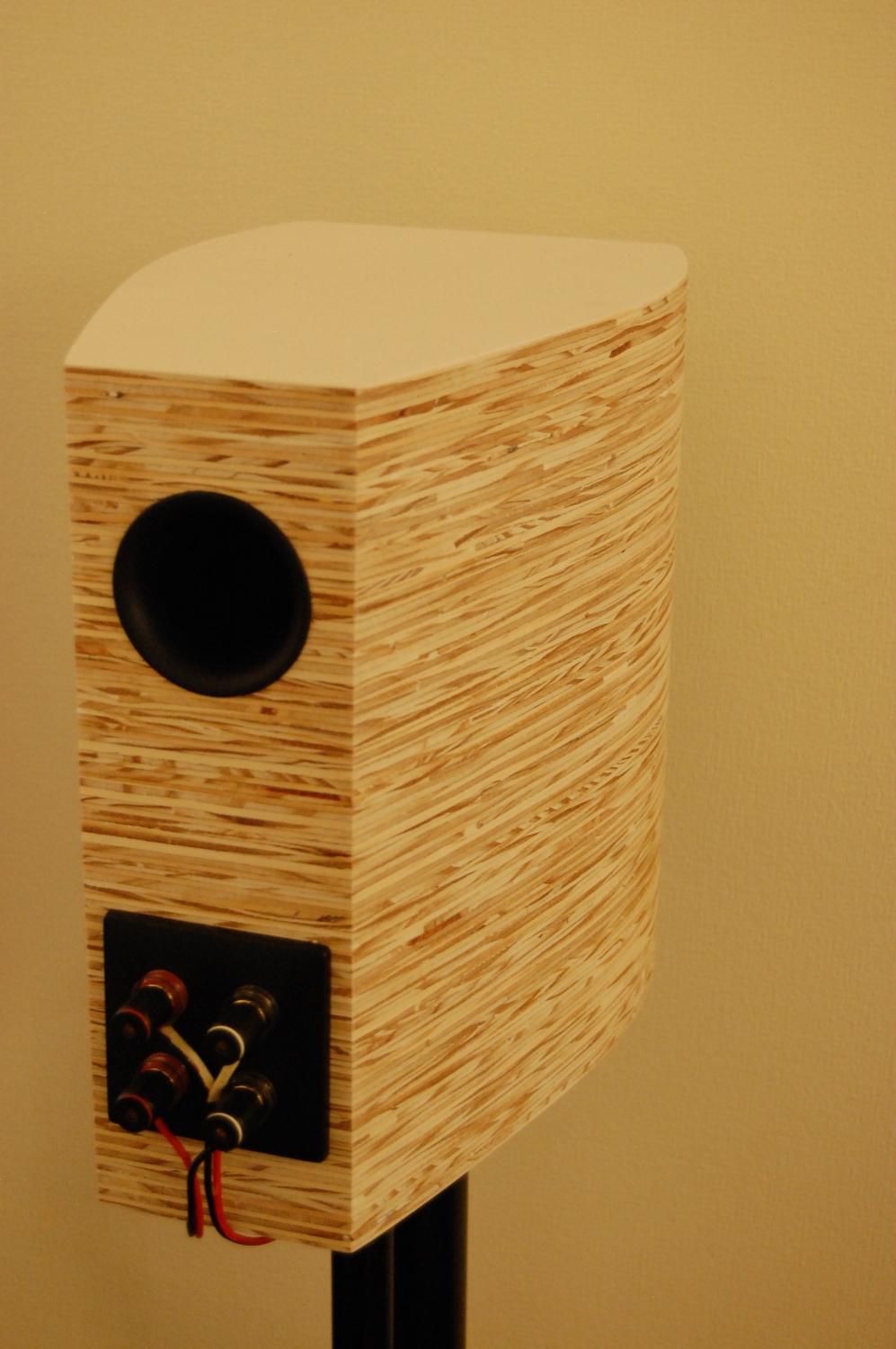

Hi
Here are my Zaph ZD5 standmounts. I am using a 12 litre cabinet tuned to 44 Hz, close to Troels' Ellam XT cabinet volume, but I am using ZD5 crossovers, front panel dimensions and speaker unit placement.
The cabinets are made from multiple horizontal layers of plywood, cut and sanded by hand. Yes - that's lots of sanding:) There are internal bracings in three of the "layers".
The front baffle is MDF, made using a router. Top, bottom and front is matte white. Sides and rear is untreated plywood.
They are dampened using "akutstilux" and Gladen Aero-multi mats on internal panels
Sounds very good! Might experiment with changing R0 from 5 ohms to 6 or 7 ohms to play with tweeter upper levels - time will show what sounds best in this room:)
-FH

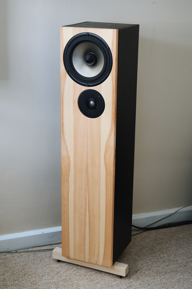

Something a little different.
Hi all, I haven't posted anything for a while but have still been playing with my little projects.
I'm always thinking and always imagining how I can do something that's a little different to the norm.
Anyhoo whilst out shopping last week I found some bamboo vases. They weren't pricey so I picked up a couple. When I got them home I decided they wouldn't really do the job I wanted BUT their big brothers might so I went back in the week and picked them up as well :)
Well the sun has been shining today and a lovely pleasant day has been enjoyed down the shed. Taddah!
They sound rather nice considering the woofers are from an old B and O speaker and the tweeter from a throw away computer desktop speaker. I've also used the crossover from the B and Os.
The legs need a little reinforcing as the case for the bottom pod isn't that thick. No stuffing yet and I might try a rear port though these can only go to improve
on what is already a quite decent sound.
Part Two
Well it's been raining today so a second day down the shed was out of the question, I'm not saying I didn't want to work in the shed, I'd love to, but I can't fit so the work goes on in the garden. Anyhow as I was home alone the living room doubled up as a workroom and the project got finished :)
Anyway the second speaker is done and a test run given on the main system. Damn they play well and loud! Jeez I'd only turned them up to 50% on the volume and my ears were bleeding:) the bass is deep (I don't have test stuff and I'm not really interested in all the techie stuff) and the highs are singing through.
Anyway they are now upstairs in the spare room and though not as loud they are a big improvement on the little Panasonics that were up there.
Anyway a couple of pics of the finished pair.
I'm pleased and a project that has worked.
