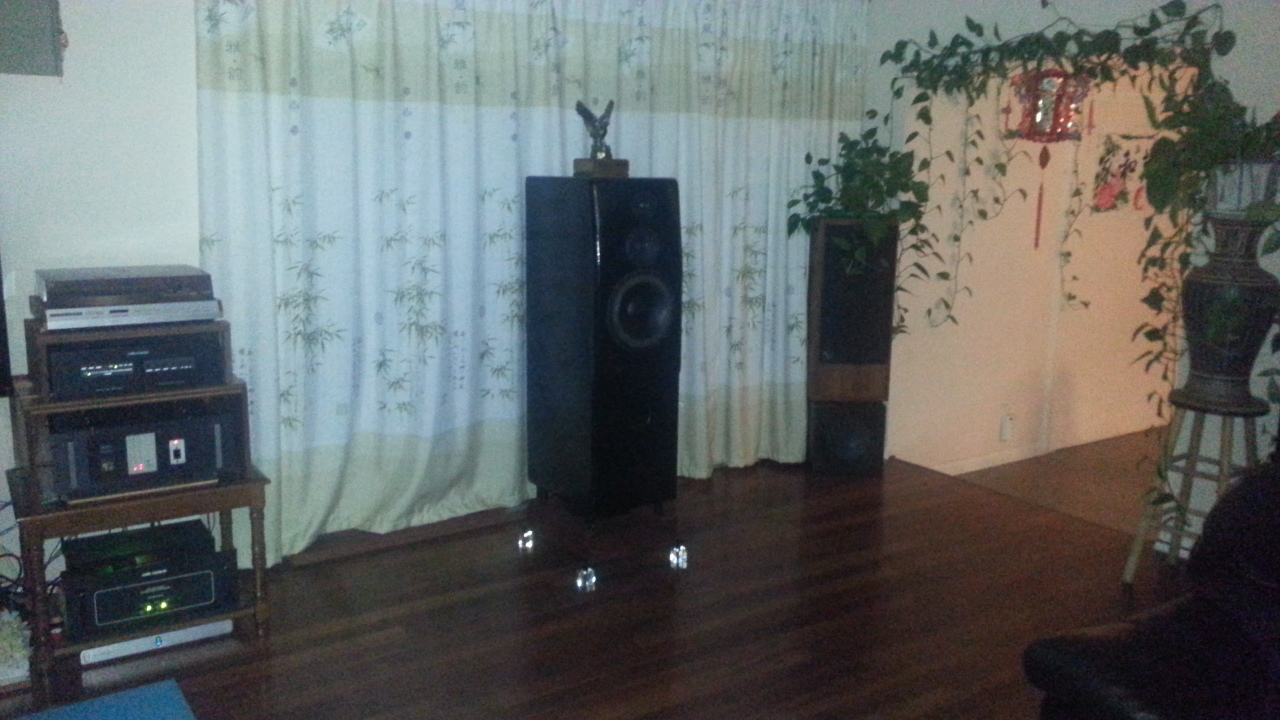

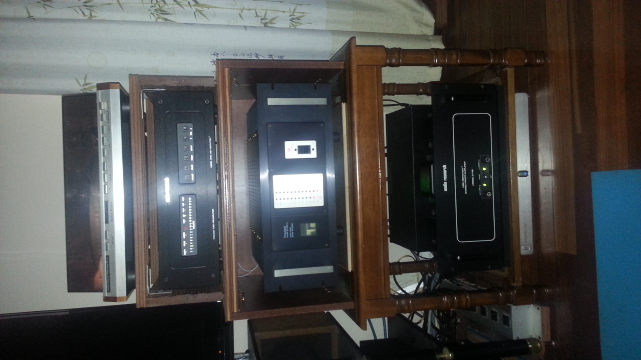

My system and DIY speakers
Anthem CD 1 tube CD player
Audio Research SP16 tube preamp has two preout
Audio Research D-115 tube amp powers Tweeters and Midrangs
Pass Threshold Stasis 2 Power amp powers woofers.
Marantz 6370Q turntable
All Casas cables
Big tower speakers 3.5 way design. ScanSpeaker tweeters and midrange , 2x12" Dynaudio woofers. Separate cabinet for xover. Weights 180 lb each, 5 feet tall.
My HT system is a totally different system that has 9 speakers (all 8" 3 ways) plus 4 of 12" passive subs. The receiver is Onkyo 818 and the sub amp is Mcintosh MC2105. PS3 and HTPC. TV is Toshiba 57" LCD cost me more than $6000 about 7 years ago, now less than 1000. I am thinking about a HD projector.

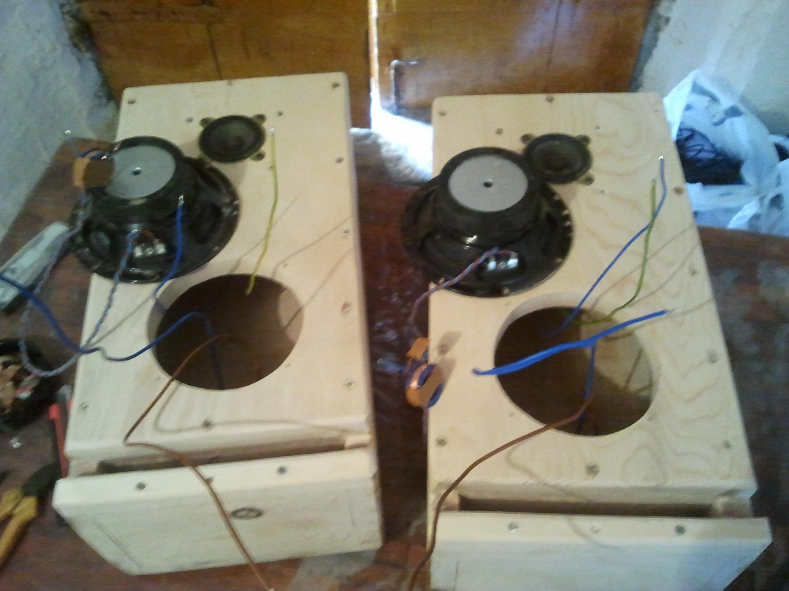

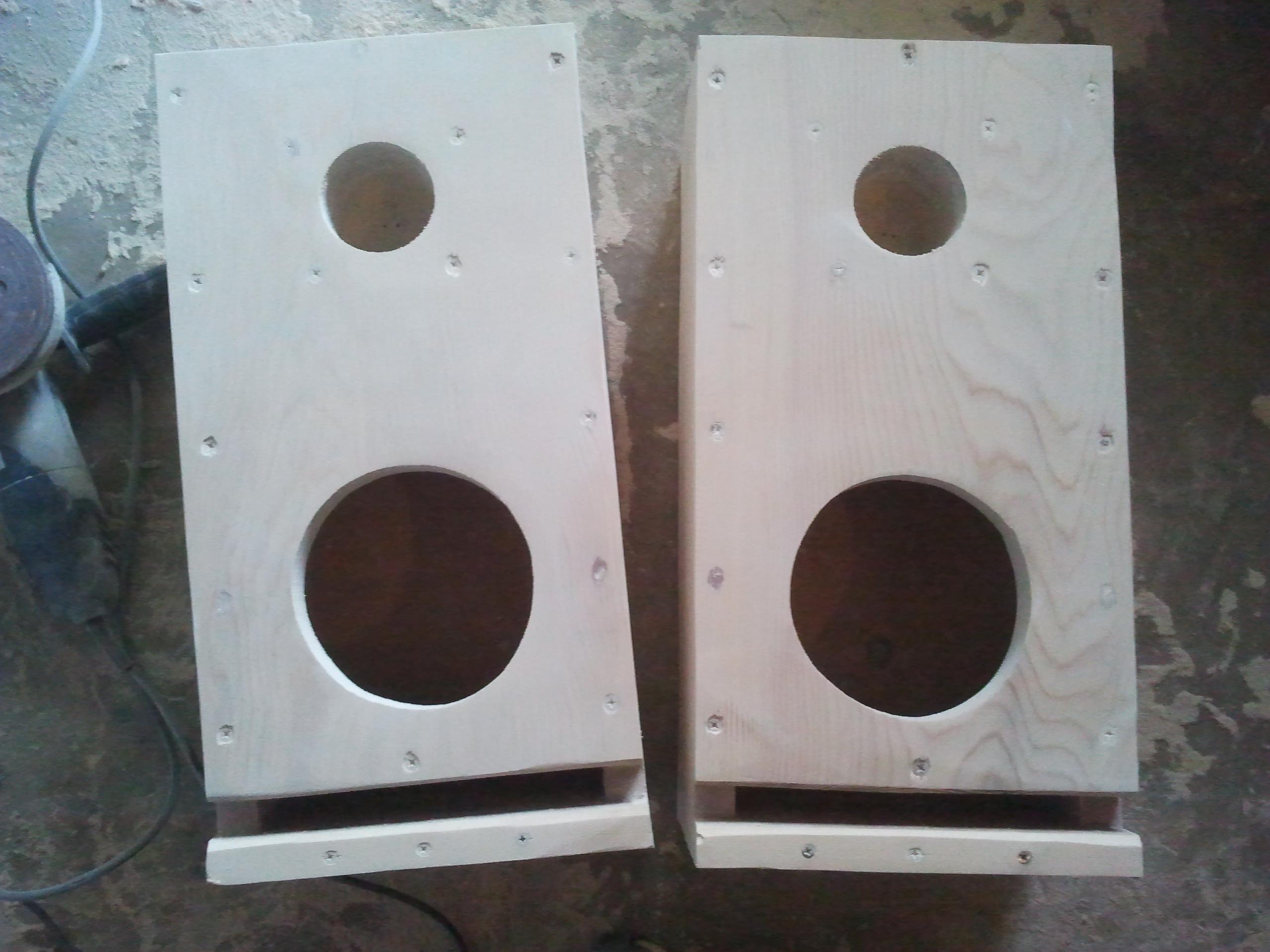

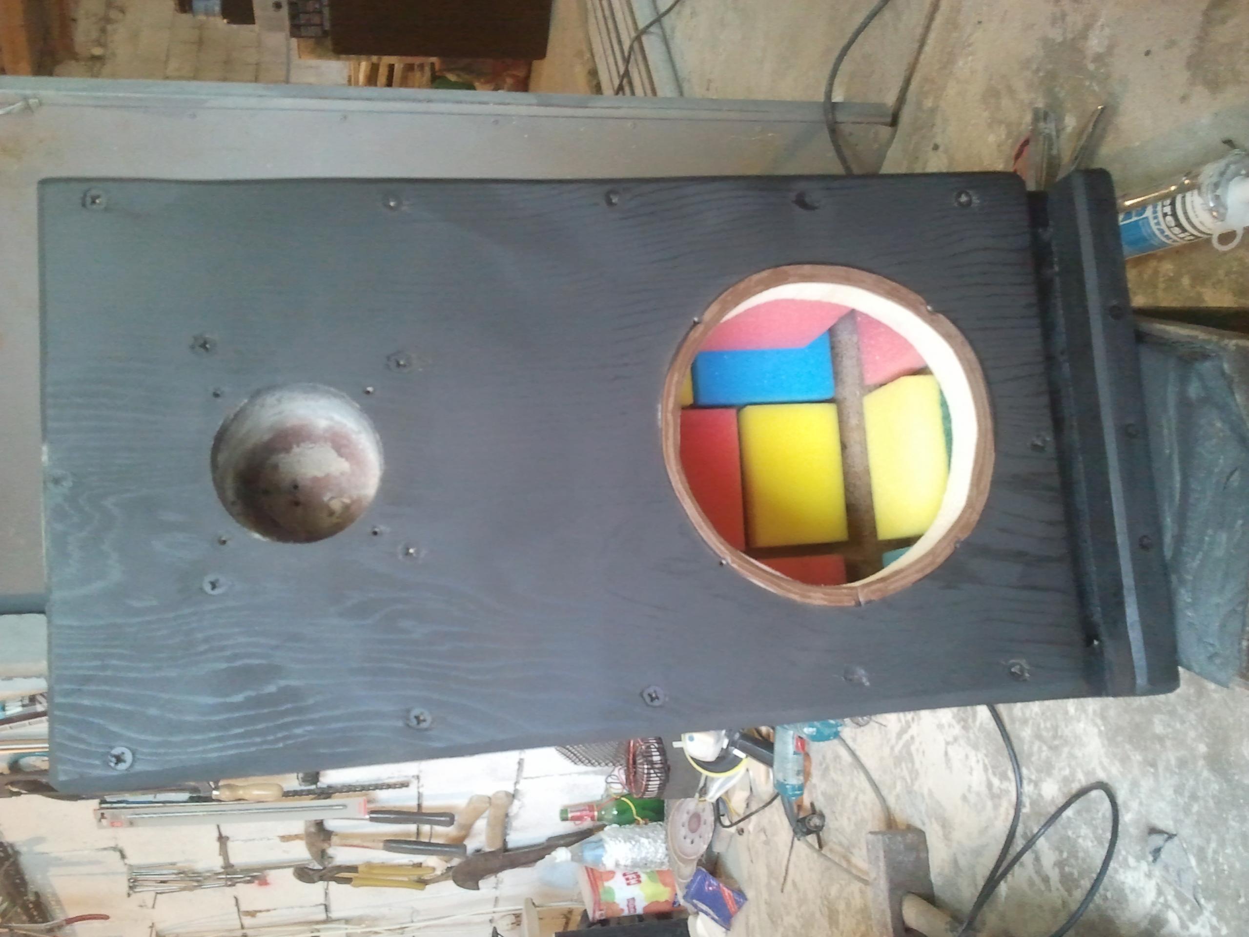

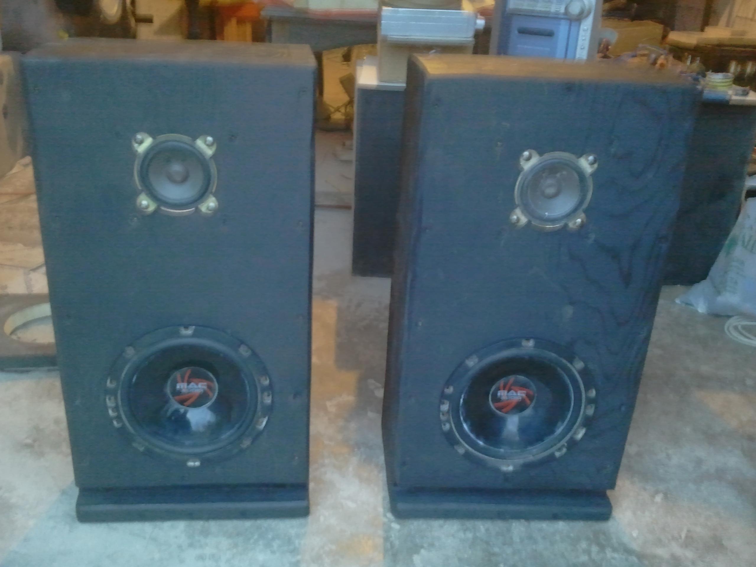

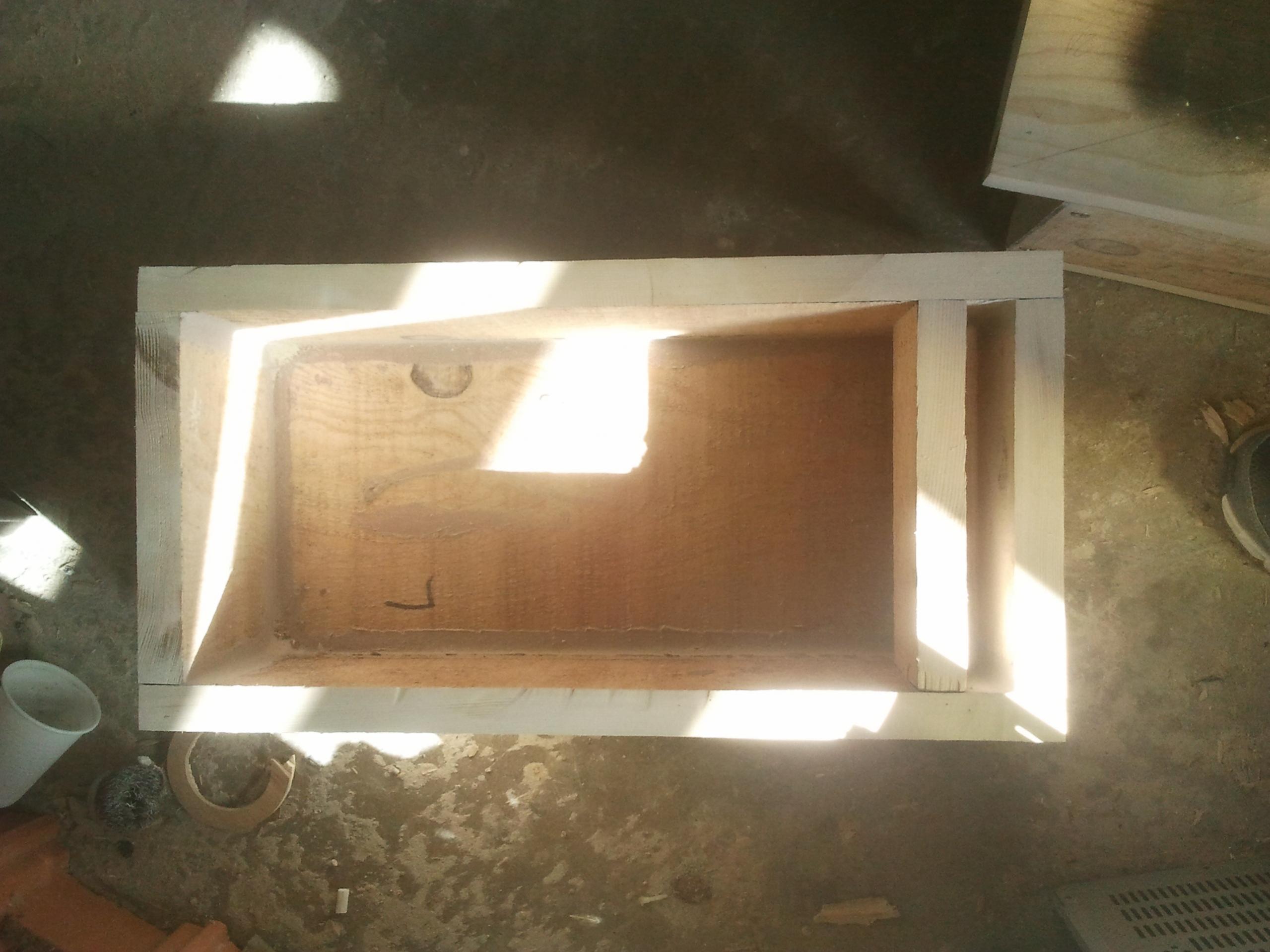

10 liter bookshelf rough build
car mac audio 4 ohms midbass and unknown tweeters crossed at 3500hz 6db tweeters recently burned out on party but whatever here are pics...all built using household materials nothing pro like others here but sounded very good what was only point ... used bass box pro for design aid and t/s parameters measured not precisly but measured

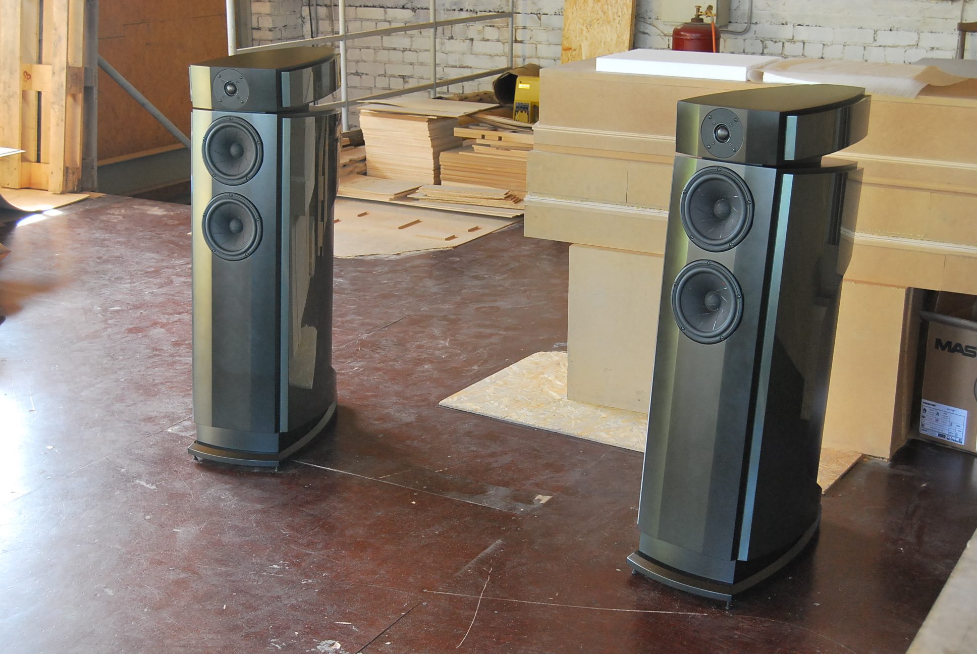

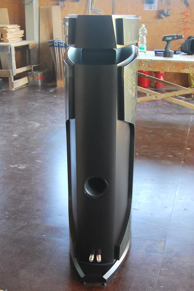

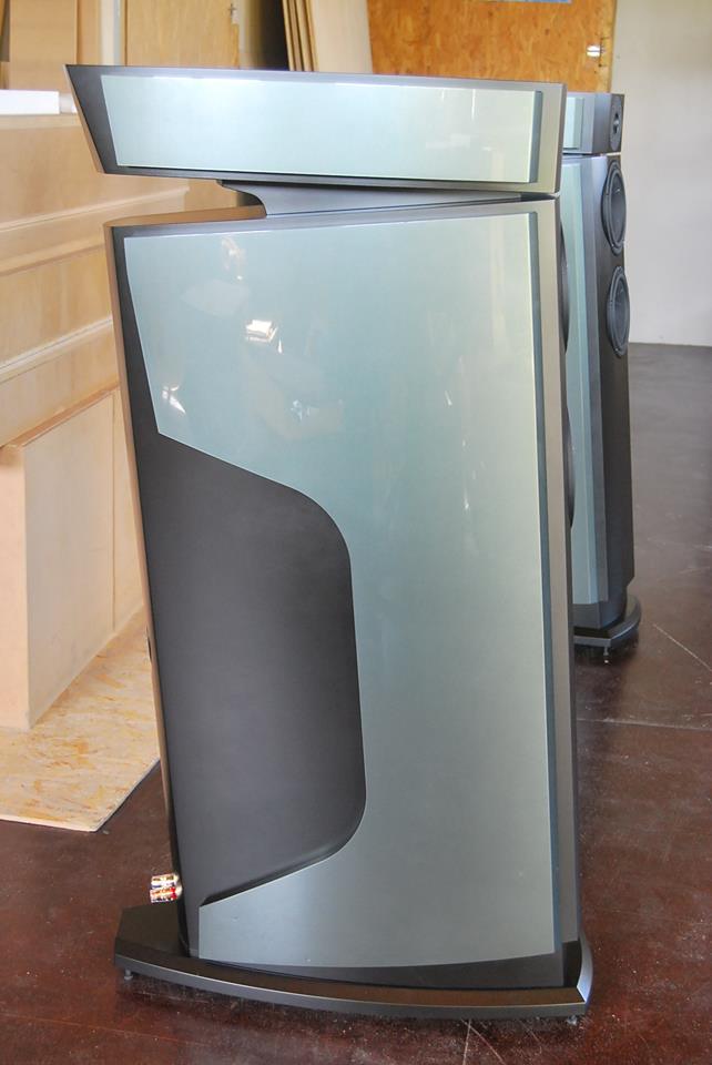

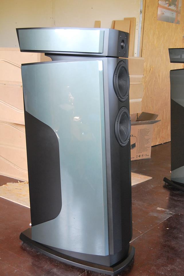

Hi all, there is my latest creation, made in Lithuania
midbass drivers SS revelators, tweeter also SS classic d2905/970000. Front panel thickness 36mm, rear panel 46mm, side walls made of plywood and HDF sandwitch - 22mm, outter walls 18mm HDF. inside used double partitions (one along the box, others across the box) weighs a lot
