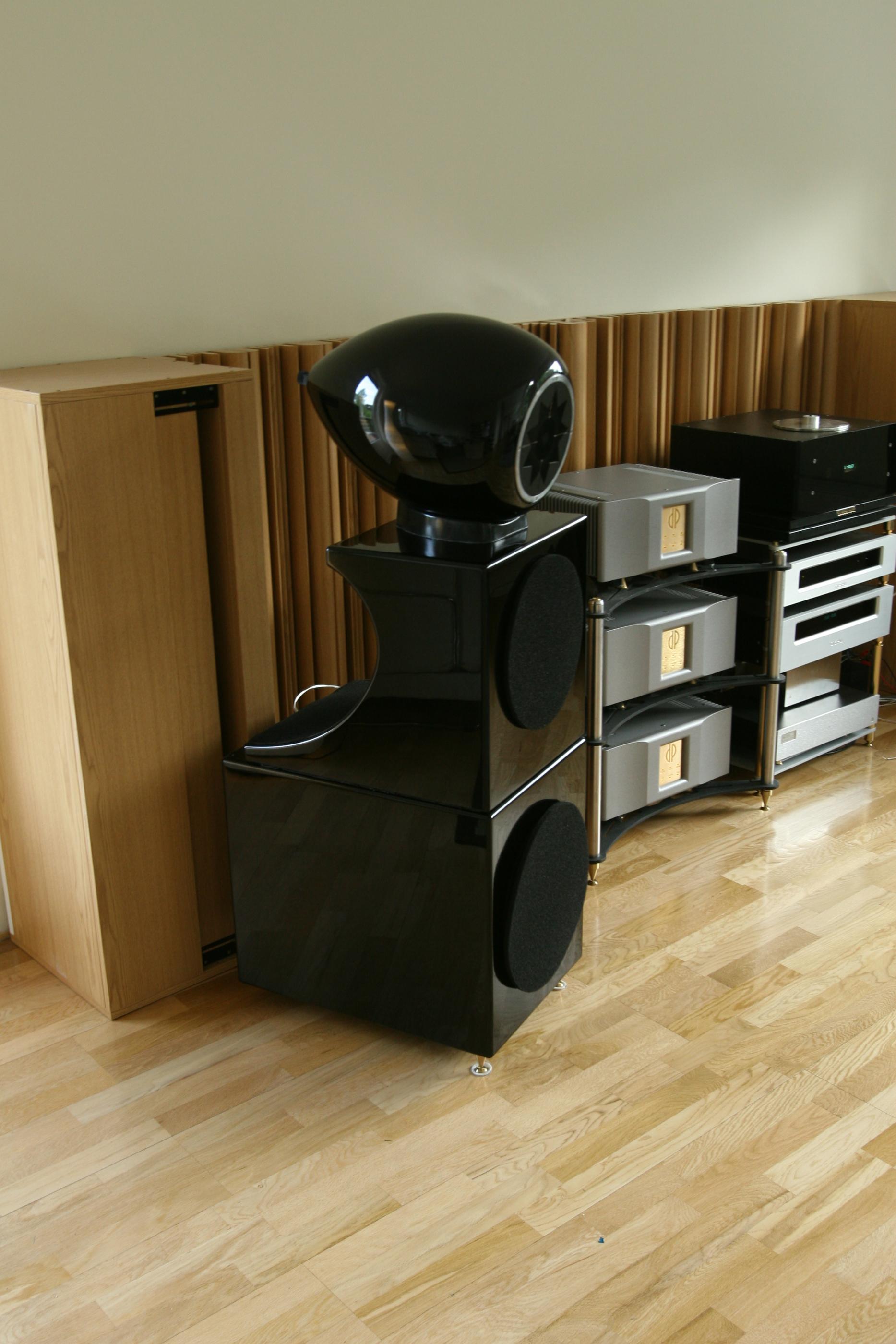

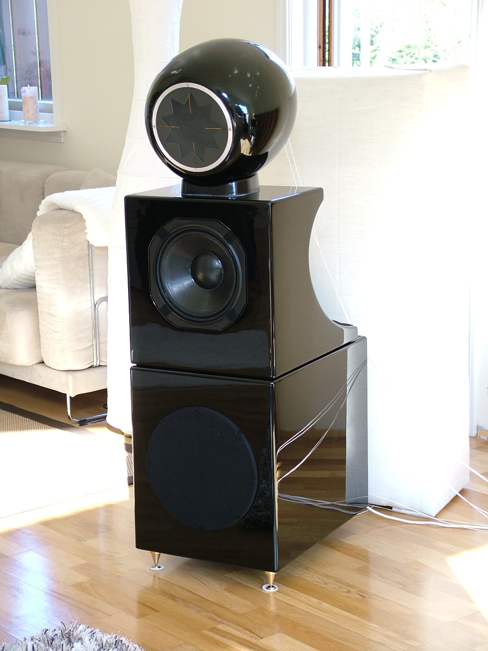

Fully Tri amped plus dedicated DAC 's
This was a great system, in a perfect room.

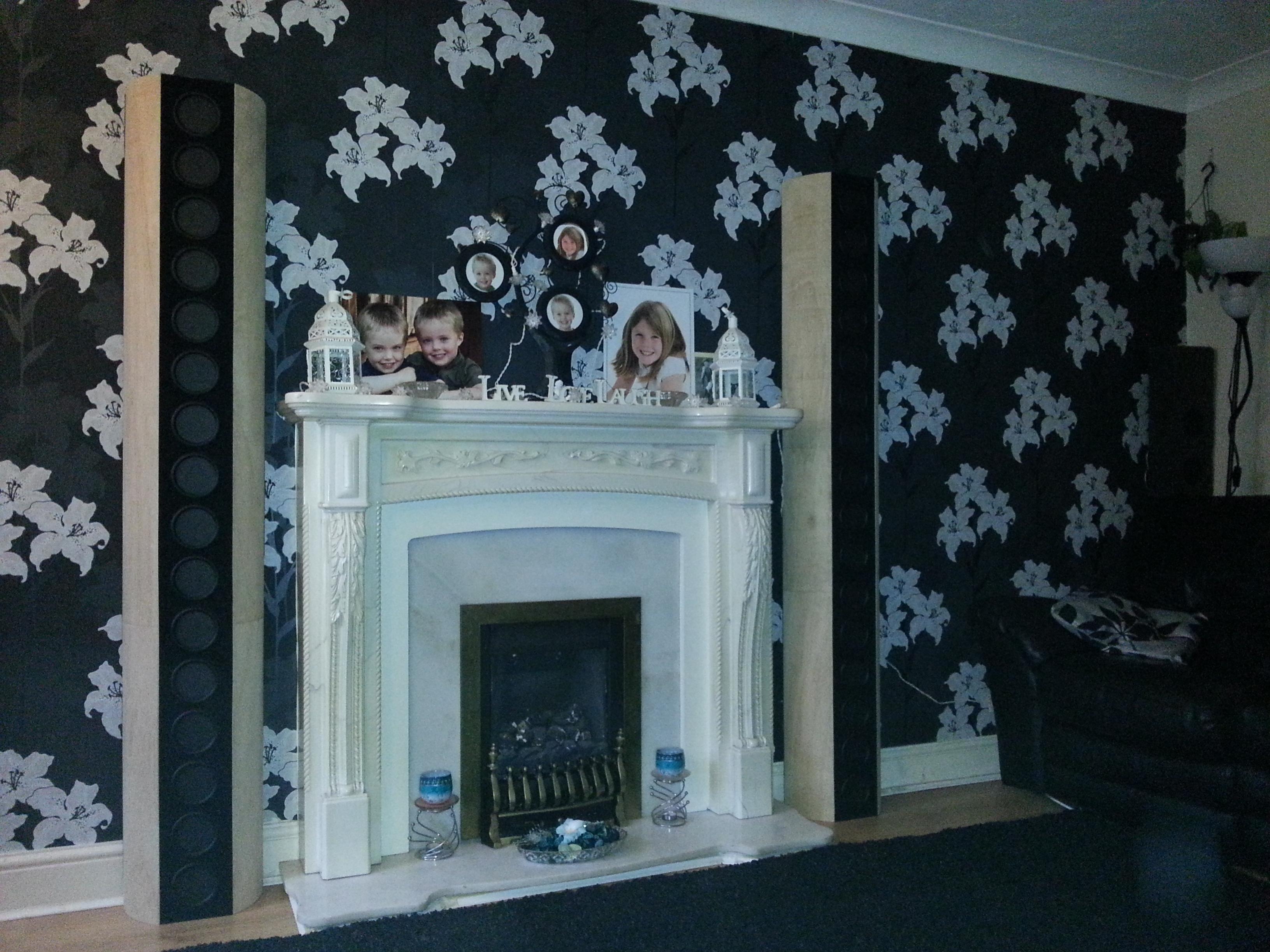

For sure...I used to get rather jealous when all my customers had waaaayy better houses than me!
Not worry Overkill Audio was great fun and since the 2008 when the crash took out most of our customers spending power we have just enjoyed the music as a hobby.
But these new line arrays do have potential...I hope to release some DIY kits later this year and see how it goes.
A couple of differences from the massive Overkill stuff, the Line arrays can be hung on a wall so they dont take up any floor space and they dont need any crossovers or even subs, so the wives and family love em.
The wives used to hate me when they saw the Encore or Finale speakers being delivered!!

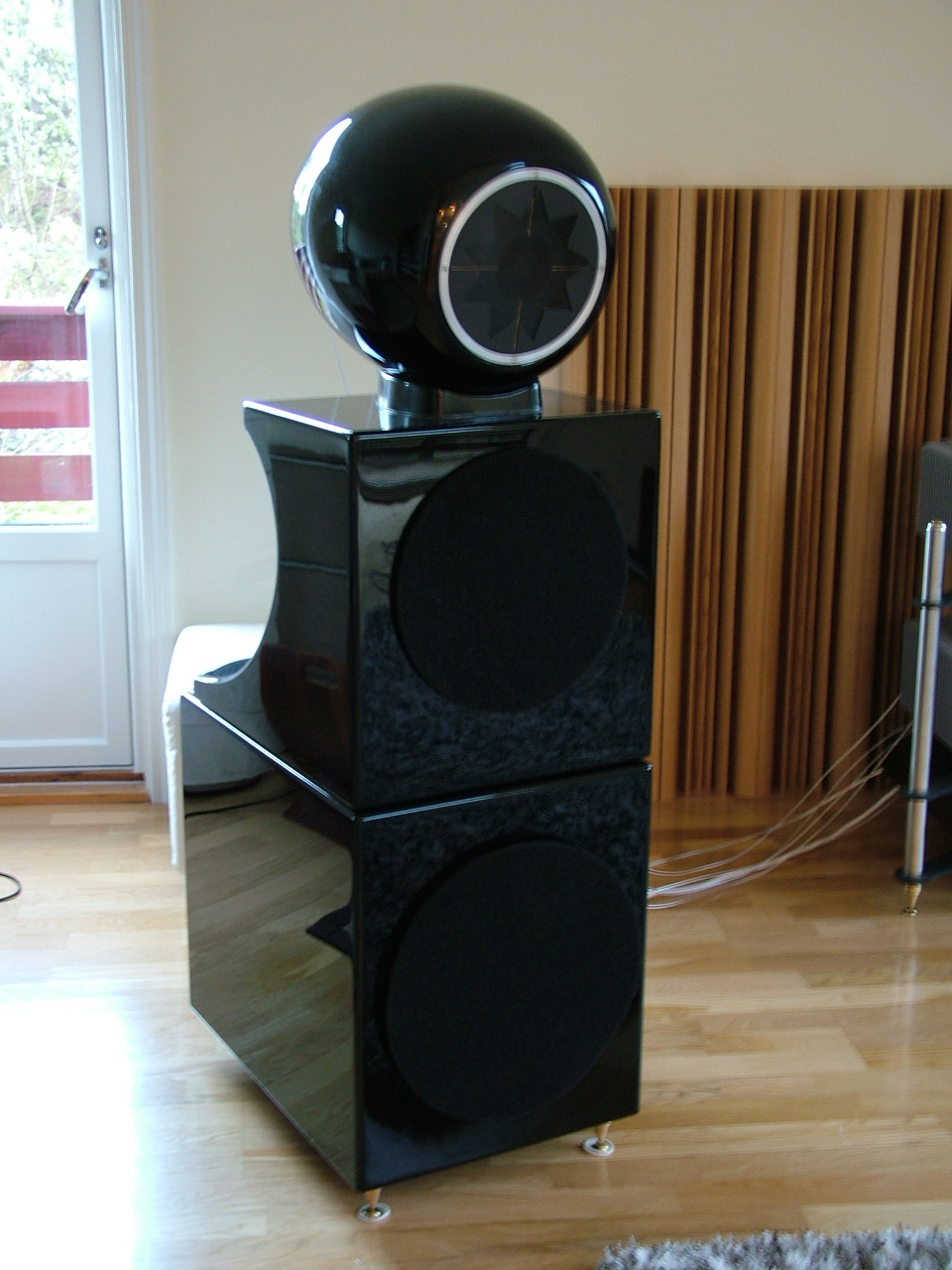

It's been a pleasure and an inspiration to follow the installation of your systems on (one of) the norwegian hifi-forum(s) (hifisentralen).
:) Johan
Good times in Bergen
Hi Rojoh,
I think that was the Finale system in Bergen..
Quite a journey and eventfulll trip.
Two days driving and boat trip to get there at 1am, then a 2 day installation.
Then an 8 hour beer and music party...You guys in Norway know how to drink...and I am Scottish!
All in all a good time was had by everyone.
Cheers
Derek.
