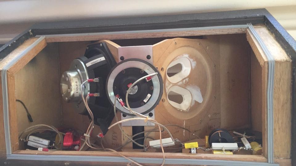

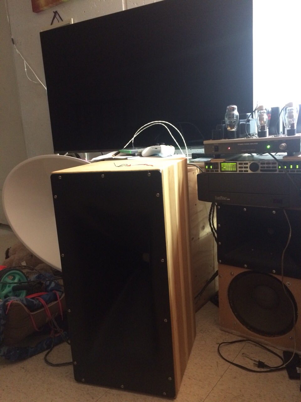

SynTripp home version
One is ready.
It's sounds FAN-TAS-TIC!
Trust me. I have lot's of stuff to compare.
It's like a top of the line BMW - it feels you. Any signal you send there will momentarily and adequately responded. Very natural and coherent sound. No compression or artifact signs at all.
Voices and instrument separation just unbelievable. Beautiful after-sounds! I thought it's impossible without of full horn system, I was wrong!
Now I think it possibly could replace ultimate full horn system (I need to measured it and find out the LF and UHF solution for it).
The DSP: LF section - HP 750Hz BW24dB gain 0dB . HF section - LP 630Hz LR24dB gain -14dB.
Thank you, Art!
I call this version Art I:).

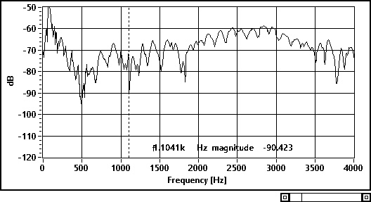

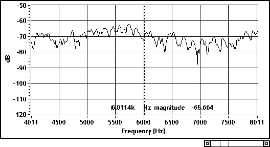

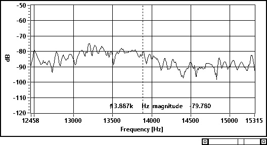

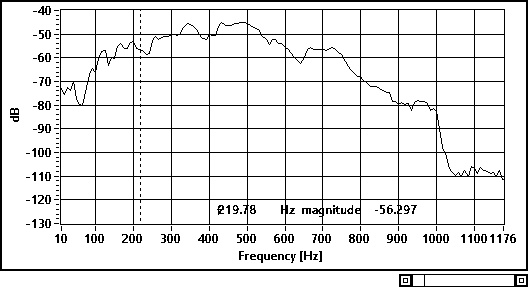

Rough measurement.
Untreated room.
Speakers on the floor, vertical position.
1m to mike.
I tried to measured them at 1m high, got horrible kind of saw graphic from 350hz up and nothing below that...
Lot's of questions.
