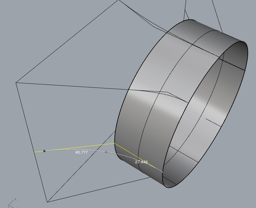

I'd love to model the throat adapter and plug, with the end result printing it out on the gigabot for another SynTripP build.
I imported FinBot's model I linked to above into Rhino, pretty sure it's a good one to work from?
Si? Hughes style?

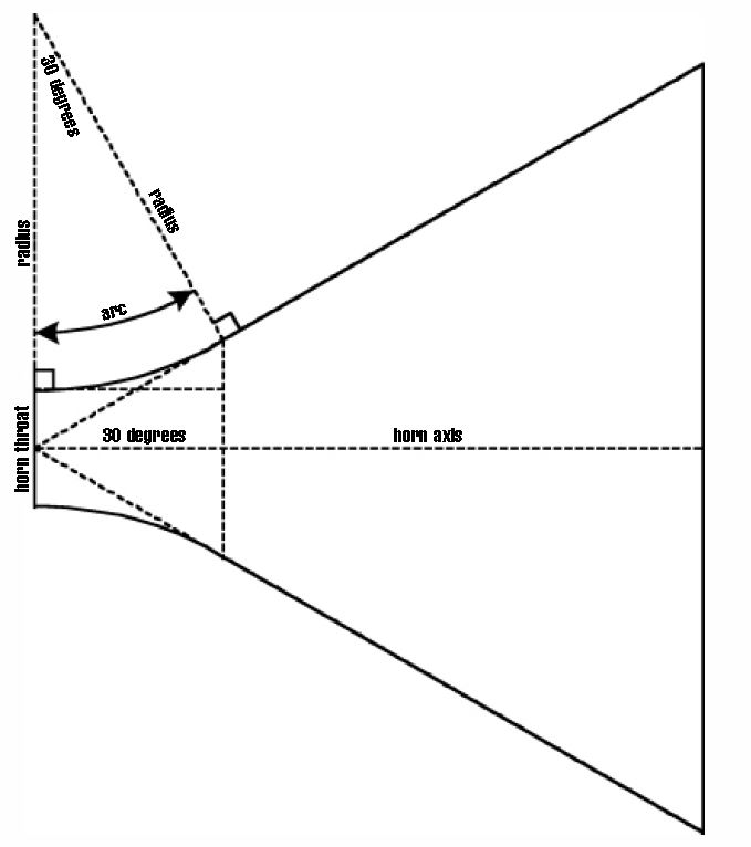

Edit: Guess what I need to know is the radius, sorry if it's been noted elsewhere. Probably is

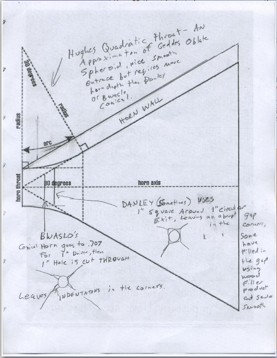

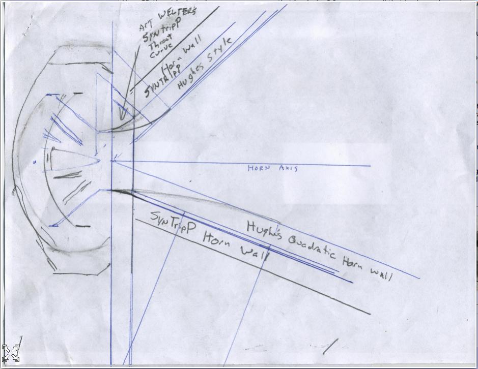

I think the radius for the purposes of making a smooth transition from a round throat is probably not a hard and fast rule. If the drawing above is to scale, that radius looks just a bit bigger than the half-width of the horn. If you were making a round oblate spheroid (OS) profile then that radius is more critical and you would have to read up on the theory where that is described (many other threads discuss this - search OS waveguide).
Jenny,Si? Hughes style?
The throat radius is shown in post #41, it is not the Hughes style, which would result in more depth and high frequency narrowing.

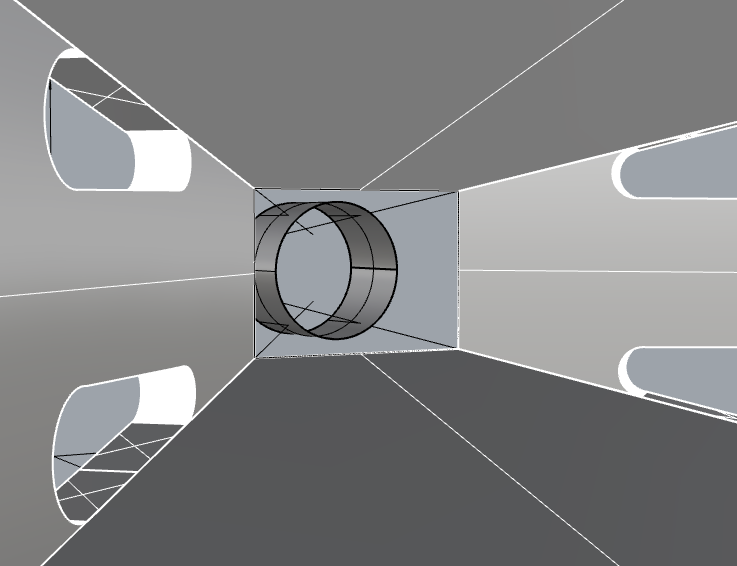

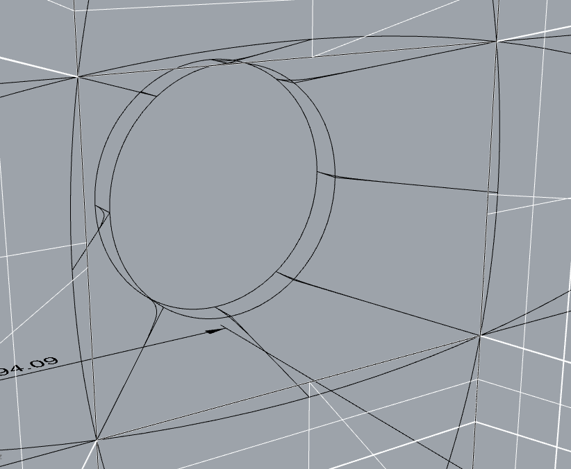

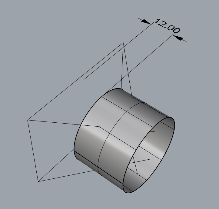

I must be seeing this incorrectly, it looks impossible to transition the flare from rectangular to circular over a 12mm depth. Otherwise the crease lines overshoot the circular opening
Switching to metric units
The transition continues from the adapter plate into the horn throat. It is easy to accomplish with files and sandpaper around a dowel.I must be seeing this incorrectly, it looks impossible to transition the flare from rectangular to circular over a 12mm depth. Otherwise the crease lines overshoot the circular opening
Ohhh okay, that makes sense. Thanks Art!

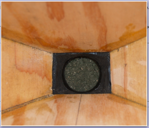

Art- I dug back into the Tripp 10 thread, post 143. Close to where we last left off so many months ago. Me =

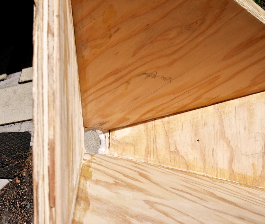

I was under the impression that the creases of the edge of the throat had to blend straight and transition smoothly into tubular profile. But, it appears to flatten out a little bit? Hard to tell from the photo
Is that a 12mm ply with 1/4" aluminum, for close to 3/4 thickness total?
EDIT: further clarification on my question... It appears to blend just fine at the top and bottom of the port adapter, but the sides appear to be somewhat flat to the edge of the horn wall

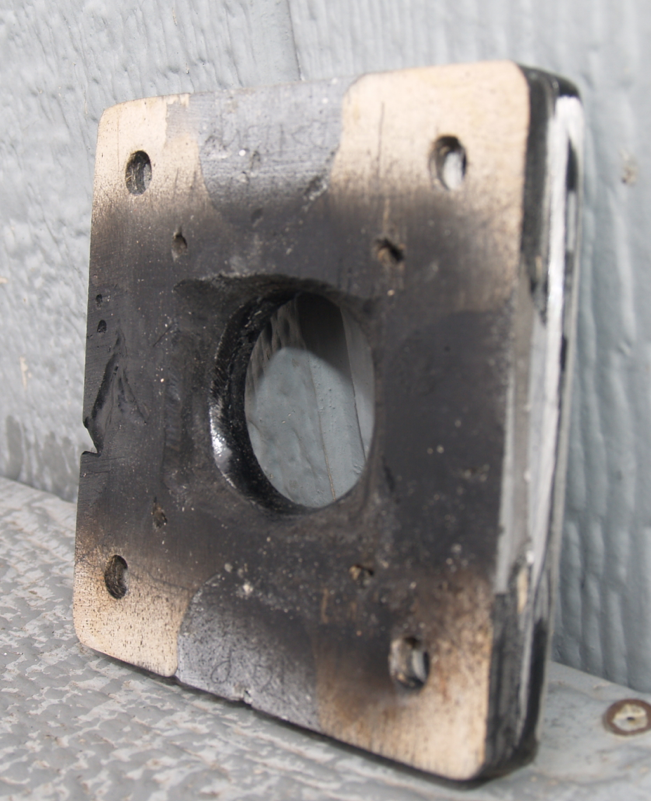

I got some images of what we did.
I used ONE plate made from 12mm ply, and used a dremel to make a trasition in an oval shape to get close-ish to the horn transition. Then used some wood filler and sandpaper to finish off in the horn cornerns and make it smoothe.
I think art used TWO adaptor plates at 12 mm together to make a longer transition (based on the drawings). I used the ferrite CD which has a longer throat than the neo version.
We just made it up as we went, but I have images I can post.
