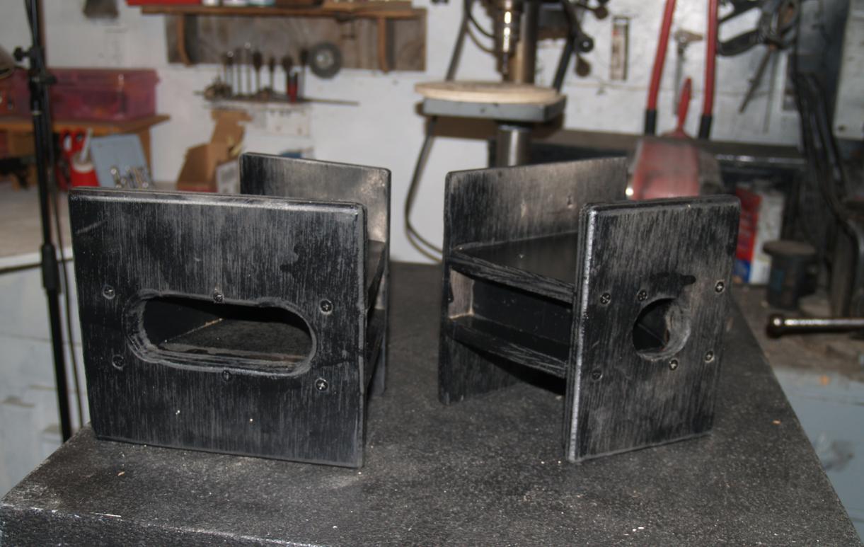

I have completed four dual Maltese horn units using the 3.5" Tymphony TC9FD-18-08 used for center fill below the SynTripP, and they work very well "filling the hole".
Feel good about finally using some of the Maltese horns for sound again after most of them being relegated to patio furniture use for the last 19 years...
Art

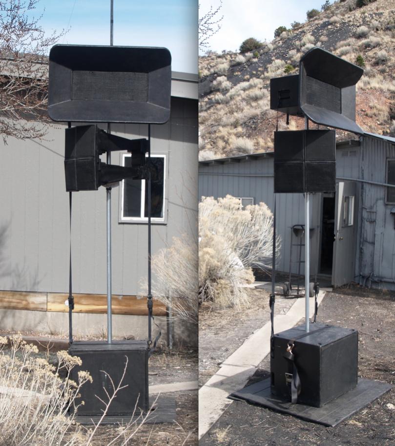

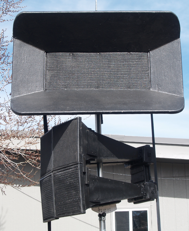

Justin,
The sub shown in post # 229 is ratchet strapped to the plinth through handle holes, there are also foot holes to align the sub on it. The plinth is made of two pieces of 3/8" Smart Panel (impervious to rot, and quite strong) laminated together, and has strips of Smart Panel under to keep the strap off the ground.
The Maltese horns have a pole box attached to the bottom pair, the top pair are kept in alignment with rotatable "legs" on the top pair that fit between the grill and an alignment slat. The angle between the horns can be varied by rotating the rear shim, or leaving the shim out. The bottom of the pole box has a 90 degree aluminum angle cut to the arc of the pole box, a pair of EMT clamps secure it to the pole.
Art
