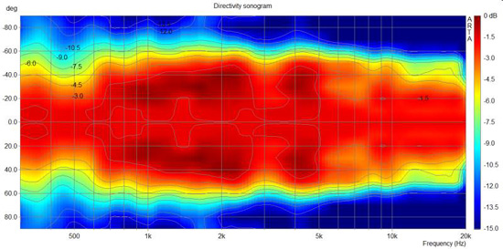

I'm about 75% sure that I'm going to change my current Synergy horn project*, due to a couple problems I've had with my horns:
1) With my Unity horn projects, I've had an issue where the soundstage is basically bounded by the horn. (Note that all of my Unity horns have been in my car.) Andy Wehmeyer, formerly of JBL, described the sound of Mark Eldridge's 4Runner like this**, and my car had the same problem:
"The least reflective car I've ever heard was Mark's 4-runner. The only glass remaining in the car was the windshield and the door glass. Everything else had been covered with thick panels with grille material covering thick insulating and absorbing materials. The speakers were mounted in the bottom of the car and in some giant horn thingys under the dash. All of that minimized reflections from the front glass.
The sound? It as very accurate sounding--like a pair of great headphones but phones in which the sound comes from in front of you rather than from inside your head. It was cool, but definitely missed the sense of space required for me to find the sound interesting. It played loud and was really dynamic without any vibration."
My Unity horns had this same issue. The soundstage stretched from one horn to the other. And the articulation gave me goosebumps; the ability to hear into the recording was exceptional. But there was very little ambience.
I think that this gets into a much bigger discussion - the question of whether we want our stereos to sound accurate or whether we want them to sound euphonic.
In my situation, I already have a set of Summas, so I think I'll do something a little bit different for the living room.

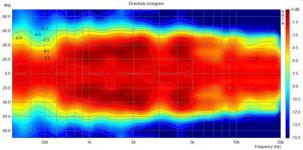

Here's a polar measurement I did of a SAW lens, the thingie that's in the beolab speakers. In the measurement, you'll notice that the sound is consistent in a 180 degree arc in FRONT of the speakers, but that there's significant rejection to the back.
I think this polar response sounds quite good in the room. I guess this is pretty close to cardioid?
I've tried dipoles, but after a few days listening, the cardioid response of the SAW lens seems to offer a nice compromise between the imaging of the dipoles and the accuracy of the Summas. (IE, my Summas really allow you to 'see' into a recording, but dipoles have that lovely ambience that sounds so nice. The SAW lens is somewhere in between.)
A few years back I ran my Summas as a mono bipole; I also found that sound preferable, but it required an absurd amount of space, since you had to pull the speakers away from the backwall.
If you look at how the Beolab lens is shaped, you'll see how it offers some of the benefits of bipole and some of the benefits of monopole. Basically the sound 'wraps around' the low diffraction baffle, and so low frequencies are radiated backwards while high frequencies are mostly radiated forward.

Note that the "Saw lens" has some nasty vertical diffraction. Also, the horizontal diffraction is likely substantial as well, BUT it's at the widest +/- 90 degrees AND the resulting source-width profile is comparatively small.
The Summas disappear pretty good. I think the main reason I can perceive their size is that I can see them. If there was a way to hide them in my home, like Geddes does with his Summas and like Cowan does with his Unities, that would likely improve the imaging. (I believe there's a large visual component to imaging; your brain sees the speakers and tips your ears off. This is something that's very odd about the under dash car horns; I think a big part of their good imaging is that you're simply not staring at them.)
The Summas don't have the ambience of a dipole or a bipole though; and for good reason, they're not firing sound against the back wall.
With the SAW lens, the sound seems to 'float' above the speakers, which is a neat trick. The perception of speaker size is basically nil.
